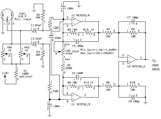

To all people they try construct the preamplifier that I proposed. What I have to point out is that; the construction of an electronic circuit it requires from equal theoretical and practical knowledge. It is impossible you achieve what you have theoretically calculated in a practical circuit if you do not know certain basic things. For example, i prefer always the gnd of signal it is independent from electric gnd. Many times the ready cables of microphones that are sold in the market they have linked the signal gnd with the metal jacket of XLR plug. This is unacceptable. For this it should not us touches the panic and we begin the questions before we examine with each attention - alone us – everything that passes from our hand. Also all the microphone inputs are very sensitive as they have very large gain. It is mandatory a careful shielding. Summarising, i use this preamplifier for electro acoustic measurements with the application “Speaker Workshop” and be very reliable in measurements with Behringer ECM8000. I quote below two measurements of the mic. preamplifier - by alone - to prove its reliability. And the measurements have been taken by the oscilloscope and not by sound card based software.

Sounds good Fotios, Im working on my own version I'm building an 8 channel mic preamp based on the classic in-amp topology, but with an aditional op-amp for linear gain control, some channels work great and some are noisy so I will need to do some troubleshooting, also I need an ultra quiet power supply... (any help will be appreciated) now Im working with an expensive precision lab power supply that is great for audio but is bulky and heavy.
I also added clipping led indicators using those nasty TL072 as comparators (the way they should be used, not for audio!)
Im using the good old NE5532, and lower value resistors to minimize noise, I will post an schematic soon to see what you guys think, what do you think about using the mitical 4558 for some channels?

Problem found?
I read and studied a lot about BJT input op-amps and found something interesting, the NE5532 has a BJT input stage whose input devices are NPN, so the bias currents flow into the chip! this means that if you tie a resistor from its input to ground you will have a negative bias voltage!
In the case of the LM833 whose BJT's inputs are PNP, currents flow out the chip, this means that if you tie the same resistor from its input to ground you will have a positive bias voltage..
This may sound obvious but then I thought about the excessive power dissipation problems that I have with my in-amp and the power supply instability.
I will change the NE5532's for LM833's, it seems logical that this may solve the problems that I currently have.
