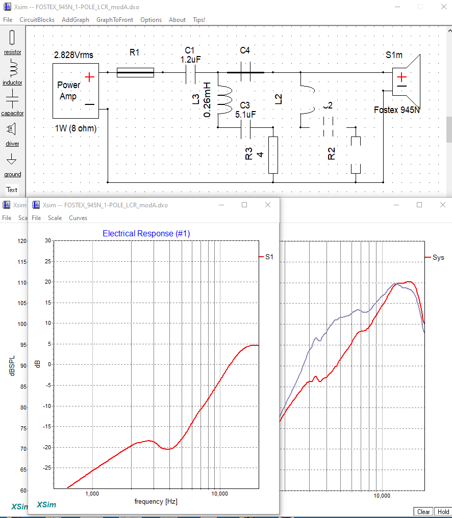

Most of the newer ones have bad peaks on the bottom of their FR which need serious notch filtering to make them pleasant to listen to. In fact, most small HF ring radiators have this peak.

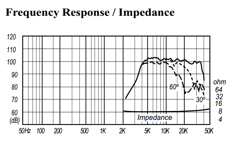

It uses a diffraction slot/horn to ensure a wide horizontal dispersion, 90 deg at 16khz.Btw, Gravesen raved about the horizontal dispersion of the JBL 2405H
JBL 2405,2405H and 077 are all similar. The 2450H is the Ferrite magnet version.
be aware of difference in diaphragms, thickness of diaphragms differ between some models of JBL super tweeters, and lack of aftermarket ones.
