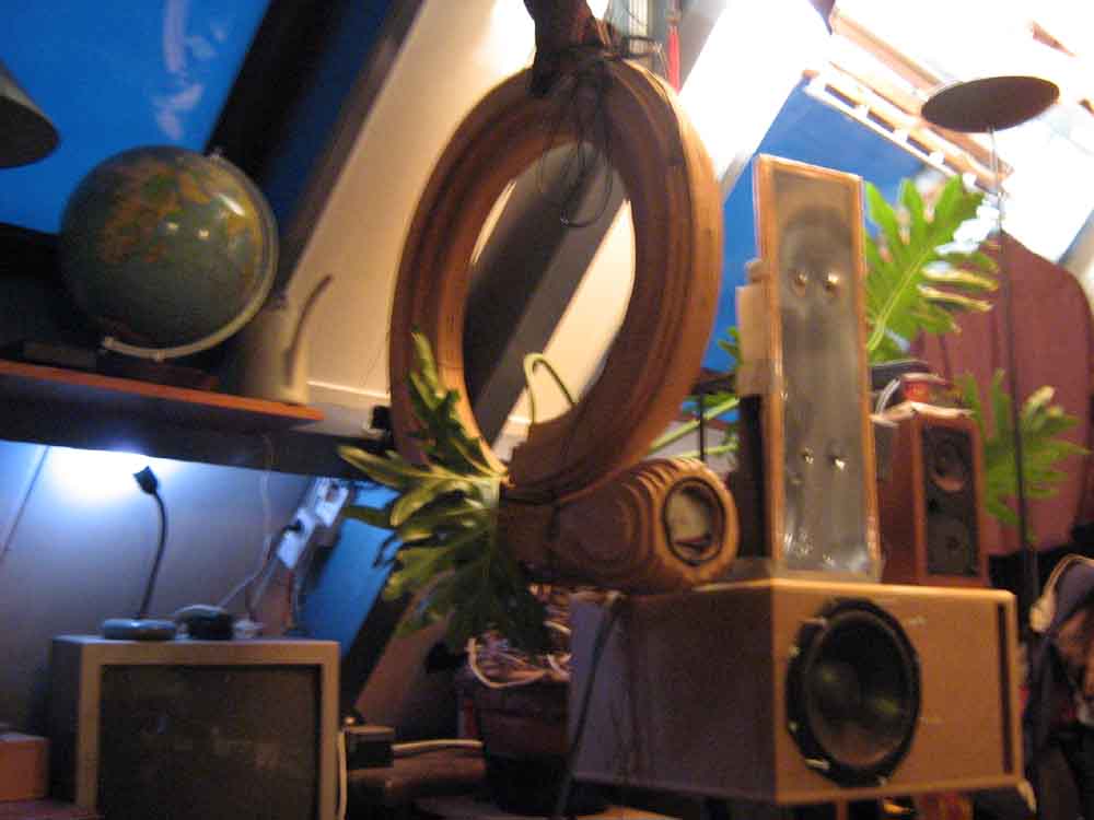

this is my setup:
("Quad" esl-57 treble panel combined with 10" "Precision devices" custom sub in TL cabinet).
It may look shabby, but it sounds really sweet...

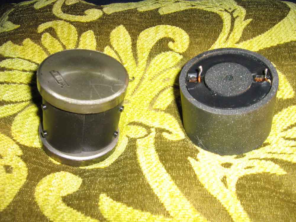

I will make some pictures of the coils, but have to borrow a camera from a friend...can take some time...
I used wire from an old but unused transformer and wound it on a small ferrite core from a tannoy speaker filter, in my place you literally trip on the filterboards laying around. So sourcing some ferrite core is no problem I guess, still wonder if I can better use air-cores?
My guess is that ferrite based cores are better in this field...
Still experimenting though, have to borrow a friend to do some A-B testing..😱

here's a picture of the chokes, one is with ferricore and halves of a piece of steel tube. The other is a ferrocore carrier with a plastic carrier inside, I removed the original wire with wire from a transformer. The ends of the wire is soldered to a thicker coated copperwire to give it more strength.
These are for a lowpass filter at aprox. 200 hz, the one I previously made I already sold....
But maybe I'm just lucky with all my old stock...I'm quite a collector, and everybody knows, I get a lot of old stuff from them....
I'm still not sure what makes the better coil, I can only make sure the measured value is allright, the rest is still unexplored territory for me...

ehm... pardon me, but the one with the steel halves is ferrocore and the other ferri(te)core....
I just looked it up..
