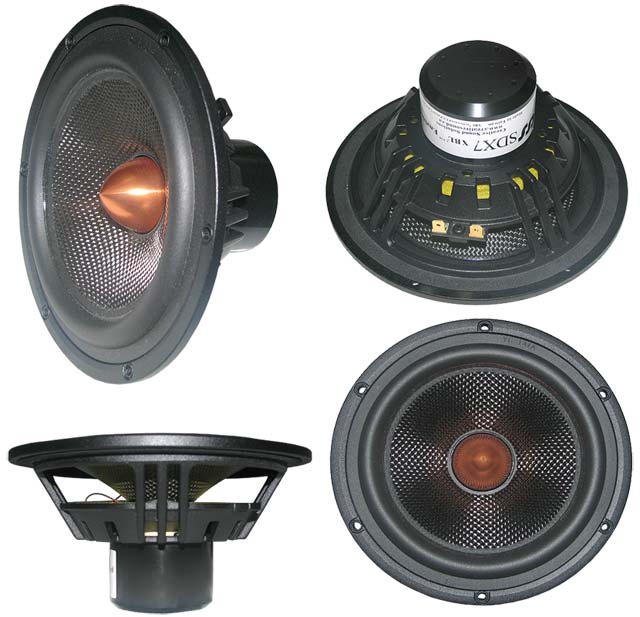

Next question for the inveterate DIYer of course would be: candidates for physically small, high performance powered (sub)woofer?
the nominations are open
My personal recommendation for max SPL sensitivity would be:
FE126eN in the Brynn cabinet, with one powered woofer per side. The new CSS SDX7 would be a great candidate. This latest version of the XDBL Extremis design is quite a sexy little beast, although of course it strictly adheres to the sensitivity penalty inherent in Hoffman's Iron Law.
(Dave, got any pictures to publish yet)
Either PLLXO for the FE126eN with conventional style plate amps (i.e. unless you're confident in the quality of the HP filter section of the plate amps, avoid them at all costs with drivers of this quality) or full blown outboard XO and stereo or mono blocks for the subs.
With the Brynn's wide baffle configuration and powered subs in this system, it's probably fair to say that BSC would be the least of your worries - it should certainly be able to rock at 95dB+ for longer than your ears should be subjected.
Note to any builders of Brynn - if you plan on experimenting with different drivers in this cabinet, be aware that the depth of magnet structure varies among the Fostex candidates. (FE126, 127 and FF125K) If you cut the driver magnet brace for the deepest magnet of this group (FE127), you can pad the back of the others with dense PSA felt pads to retain coupling.

OK, for those who might care, a quick check of some dimensioned drawings: the SDX7 can certainly be fit in a box the same width as the standard beveled Fonken ( i.e. ~220mm), but finding a plate amp to fit is the biggest challenge.
One candidate if you don't mind turning it sideways (not my first aesthetic choice) would be the BASH 300S

Attached... data sheet for these is nearing completion
So far the most appealing box to me for these is sealed (with XBL a bit of boost on the bottom for more extension is plausible) -- It would be easy to turn the void + a bit of added base to Brynn to accomodate a rear firing SDX7 "stealth" woofer. (BTW StealthWoofer is copyright for a frugel-horn woofer)
On the table for some time has been an add-under FonkenWoof, that was delayed by the dissaperance of the Extremis,,, the SDX7 makes it much easier to implement.
The SDX7 will fit in 7 litre (Q=0,7) to 21 liter (Q=0,5) sealed box. The latter with room gain should get you into the 30s.
