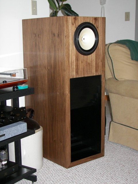

Last nite I covered the magnet with foam tape,1/4'' thick X 1 & 1/4" wide, basically weather stripping, and covered the bottom of the cc with 1" deflex. I kept the polyfil in and moved it up so most of it is directly behind the driver. I only had 45 min. to listen, and I`m very happy with the results. That sort of droning resonance is pretty much gone and now, I really like these speakers. If my opinion changes with extended listening I`ll post what I hear...at this point huge improvement.
Cool! Nice work on the cabinets. They are bigger than I imagined, looking at the plans. Are they in cherry?
Doug
Doug
FE206ESR
No they are done in Walnut with a clear finish, and yes they are BIG. We estimate they weigh around 150# each.
Mike
Mike
I think they are magnificient! Congratulations on what looks like a really nice job!
We picked the wood for mine: Russian wild cherry tree. I cannot wait to start!
We hired a wood worker to cut the pieces right and the whole thing will come down to about $220 canadian (wood and cuts). We did not have much of a choice as the stores did not seem to offer much help, and we are not equiped to cut this accurately. But we should be able to glue it right!😀
