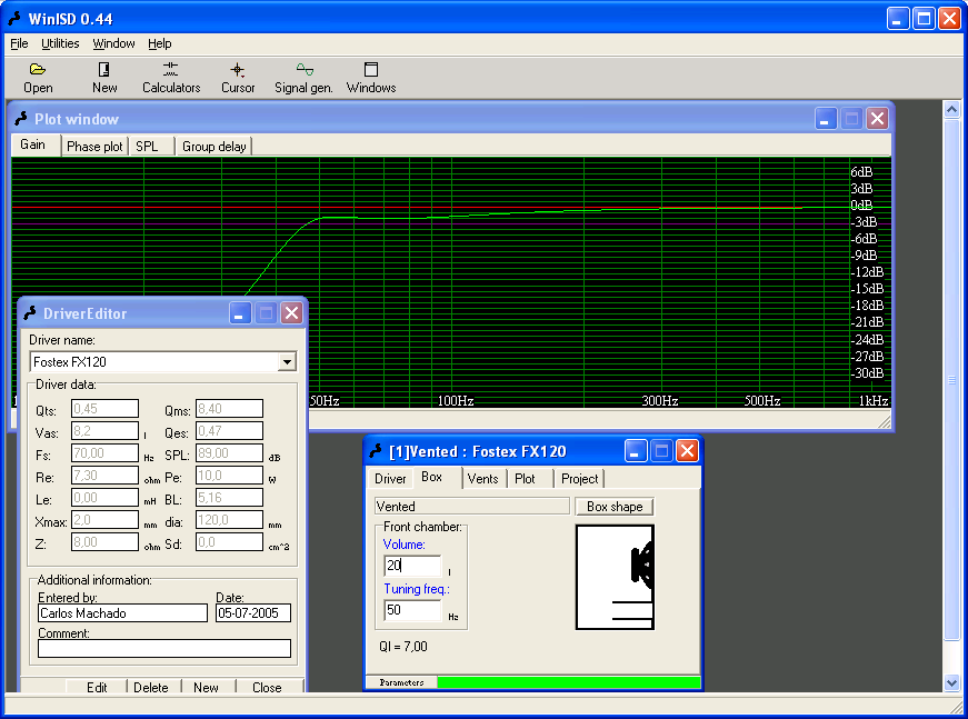

Since I had exams I didn't have time to spend on DIY audio these days.
Now I'm on holiday and after having finished my Home theater system (I'm writing a part on it for my website) which works great, I thought I'd replace, as I foresaw it, my TQWT's for a better enclosure.
Well, I ran some simulations once more with MJK's outstanding MathCad sheets, and drew another TQWT design (I found it to model better than TL's or straight lines).
I built the prototype with a friend, sealed it perfectly and tested it.
Though 40Hz passes perfectly well, there is a lack between 100Hz and 50Hz that wasn't that deep in the simulation. Bass was rich and complex, but had no authority, consequence of the small size of the unit. Moreover, BSD decreases the bass output.
I then remembered something : Fostex didn't give the BL factor in its datasheet, and I estimated it to be 4.3 according to the efficiency of the driver. And then, I used CAAD4.1 to model a bass reflex enclosure, entered the driver parameters and was surprised to see that the BL calculated by the software from Fostex's params was not 4.3 but 5.16 !
Here was the key of the problem, and when I ran the simulation again, it became much more accurate, thanks to Martin's great work.
Well, though this enclosure is definetely better than the first one, I cannot accept such a frequency response !

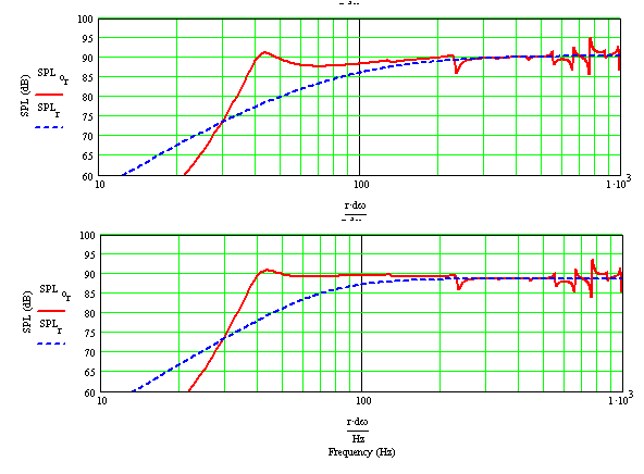

I played arround with different enclosures types, but none of them can bring my FX120s down to 40-45Hz without linearity issues. Even at 50Hz, linearity is correct but not perfect
Double bass reflex looked really promising but a dip arround 100Hz makes it unusable. Does anyone has some tools to simulate a double chamber reflex, with 2 ports on the outside instead of one in MJK's sheet ?

youyoung21147 said:Though 40Hz passes perfectly well, there is a lack between 100Hz and 50Hz that wasn't that deep in the simulation. Bass was rich and complex, but had no authority, consequence of the small size of the unit. Moreover, BSD decreases the bass output.
Why are you obcessed with 40Hz?
I doubt that this small driver can ever be linear down to 40Hz.
You should concentrate on the 50 to 60Hz region, that's where you should tune the BR.
Greets!
You do not mention what 'Sd' you used or whether you used published or measured specs, so WRT the 'BL' value, when I use published specs and a reasonable assumption for 'Sd', I arrived at 83.48 cm^2, 6.5133 N/A.
Pushing a driver this far below Fs requires lots of Vb and do not recall trying to get this far below without a huge horn, but now that we have MJK's WS, I plugged some Voigt style pipe numbers in and came up with a much better sim than I thought I would, though whether or not it will perform 'close enough' to prediction remains to be seen.

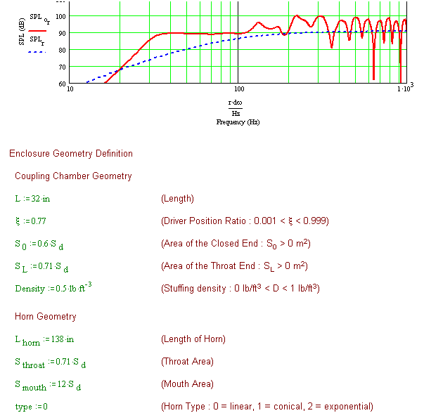

Here is the best modelisation I obtain for a BLH.
Do you think it's possible to damp out all these spikes by putting absorbing materials in the horn itself ?

Your coupling chamber is 32 inches long!
Looking at your geometry, I believe you have designed a TL and not a back loaded horn. I have serious doubts that this design will work and it is probably not worth building. Don't believe everything you simulate, you need to ask yourself if the model geometry and calculated results make any sense and if they fit the assumptions that went into deriving the equations.

Yes, I know the geometry is quite amazing and doesn't look like a standard BLH. That was just a simulation example and I wouldn't have built this thing anyway, due to its size.
Why present something for comment if you have no intention of building it? If you are going to post nonsense designs, looking for feedback, then I am not sure how long you will continue to get useful comments.
Is it as accurate as your ML-TLs sheets, which work perfectly well, because you seem not to have really tried it according to your website ?
The BLH worksheets on my site use the same assumptions as the TL worksheets and produce the same type of calculated response. The BLH and ML TL accuracies are the same. However, for a BLH to be of reasonable size it needs to interact with the walls and floor so that the mouth size can be reduced. This capability is not included in the current worksheet and requires the user to recognize and adjust the design for this effect. My newer BLH models take this into account. To date I have not found a BLH design that I considered good enough to actually build and then correlate against the newer MathCad worksheets, I am still working on this project.
Is it interesting to consider the "sound pressure in time domain" graphic to adjust the geometry, because a horn seems to send back the impulsion through the mouth with a delay, but amplified too.
I believe that a double pulse is an inherent property of a BLH. A TL does the same thing but to a lesser extent due to the fiber damping in the line. The key question, is it audible and does it degrade the BLH performance? I have heard strong opinions expressed both ways on this issue, my guess is that this is not a big problem. Secondary pulses will also be generated at room boundary conditions and if managed they are not huge issues.
Does it mean a horn always has some coloration, and is it possible to increase the impulse impact of the driver with a horn?
The BLH horn's pulse will always be stronger then the driver's pulse, that is the whole point of horn loading. The only way I see of increasing the driver's pulse is to add a front loaded horn, I am still working on that simulation. The horn's pulse will always lag the direct pulse from the driver due to the extra distance is has to travel along the length of the horn.
Is it possible to model some damping in the horn, like in the coupling chamber?
Yes, all of the models will accept up to 1 lb/ft^3 of fiber damping at any section. You will have to hand edit the input if you want a custom and optimized distribution of fiber damping.
