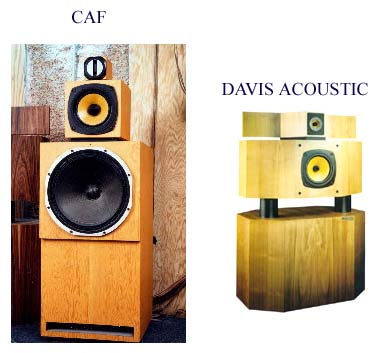

Hello all,
I have spend two days of hollidays to study Fostex drivers and try to find good informations.
Finaly, I think seriously to build a "little special" 3 ways speaker that could have good efficiency (~95db) in a small room. In fact I think that the medium must be a full range use as a full range. For that I have retain FE207 or FE204 or one I have just discover, the FE167. This is a 95db full range, and it's seems to have a good response. I think that it will be very very good in medium. FF225K will be good but it's seems to me that it will be better alone and not in a 3 ways. The frequency seems to be good for what i want to do. With the addition of the FT17H out of the enclosure I think It'll be good. For the bass, I'll use Audax PR240MO or PR300MO (95db). For a "normal room" I don't think that I must be use a enormous PR380MO. At this moment I don't know what type of enclosure I will use for bass.
FT17H+FE167+PR240MO or PR300MO seems to me that it is a balanced solution. Using this with a 2 ways tube active filter and a class A tube amplifier for the medium/high + a more powered tube amplifier for bass, i think that i will have some good hours of pleasure.
I'm sure that Fostex drivers FE and FF series are good choice because with these drivers, the possibilities of evolutions are open. In a French magazine i see that Fostex drivers like FE204 has been use in Japan with a horn in front (the driver on the picture is a old FP163).
Best Regards. Opinions and ideas are wellcome.
Pascal.

Pascal,
I think you are doing the right thing with a bass driver.
Without it I don't think you will be happy.
I am going for the FE204. I think I may add the woofer and tweeter later. Or who knows, I may like it as is.
A 3 way is usually very difficult to design. By crossing over
at the extremes, I think we can get around that AND get the coherent sound of a fullrange driver.
Good Luck
Mark

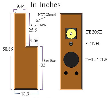

Hello,
I'll buy the FE204 this week but delivery time is 6 week in deutchland, so that let me the time to study my loudspeaker.
I have saw on audax french site forum that PR300MO are not very good and that PR240MO are difficult to use in bass reflex (in 80Hz-100Hz). Does somebody know SEAS H368 CA25FEY ? It's seems to be a good driver for what i want to do. PR240MO or CA25FEY ?
Pascal.

Some have told me a tweeter with a first order filter might have phase problems with the tweeter. Planet 10: have you had much luck with a tweeter with a full range with whizzer cone or haven't you tried it?
(Fostex reeommends a single 1 mfd cap for addding a tweeter to the Fe 208 which I believe will roll off 6 db/octive starting at 19000 hz! ) so we are talking about just the very top end here.
We'll keep you informed, please tell me of any rumors regarding the fe206
Thanks,
but this is for FE168. I saw on madisound site, Fostex recommandations for new E series. Fostex give a double bass reflex enclosure for FE206E and 207E.
I have buy a pair of FE206E (not delivered at this time) and I will use them on open baffle upon a Eminence Delta 12LF bass enclosure.
Best regards
Pascal.
