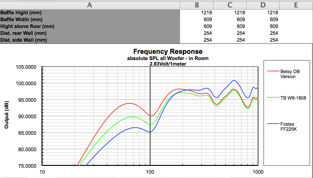

Well, I knocked some baffles together this morning after hearing the FF225Ks in a mates system in OB yesterday. Sounding really good I have to say!

I think this maybe the way to go rather than a BiB!

Glad to see these went to a good home 😉. If you're enjoying the OB sound maybe it'll be worth experimenting with aperiodic enclosures where you can hopefully keep the open sound quality but with increased bass response. Some irregular enclosure shaping might give the very best results, I was surprised at the difference that a single sloping enclosure wall could make with full-range drivers.
Ah Hi, I think I will stay down the OB route, really liking what I am hearing at the moment.
Got some Fountek JP2.0 Ribbons to try after hearing the FF225Ks with some RAALs that was a lovely match.

I can't say I'd ever see these in open baffles with such a low Qt though. Was there a helper woofer in that setup?

No, running naked. It supprised me the reasonably good bass I am getting considering the specs.
The plan is for some sort of helper bass driver (Eminence Alpha 15 etc) at some point.

inrank, I simmed your project using Thorsten's old (and excellent) open baffle spreadsheet. I think you will be pleased with the sim. Add bass help and you will have something really special (and maybe a piezo or some other kind of helper tweeter - probably just need a 1uf or 1.5uf cap and you're done). Easy and great, enjoy!
