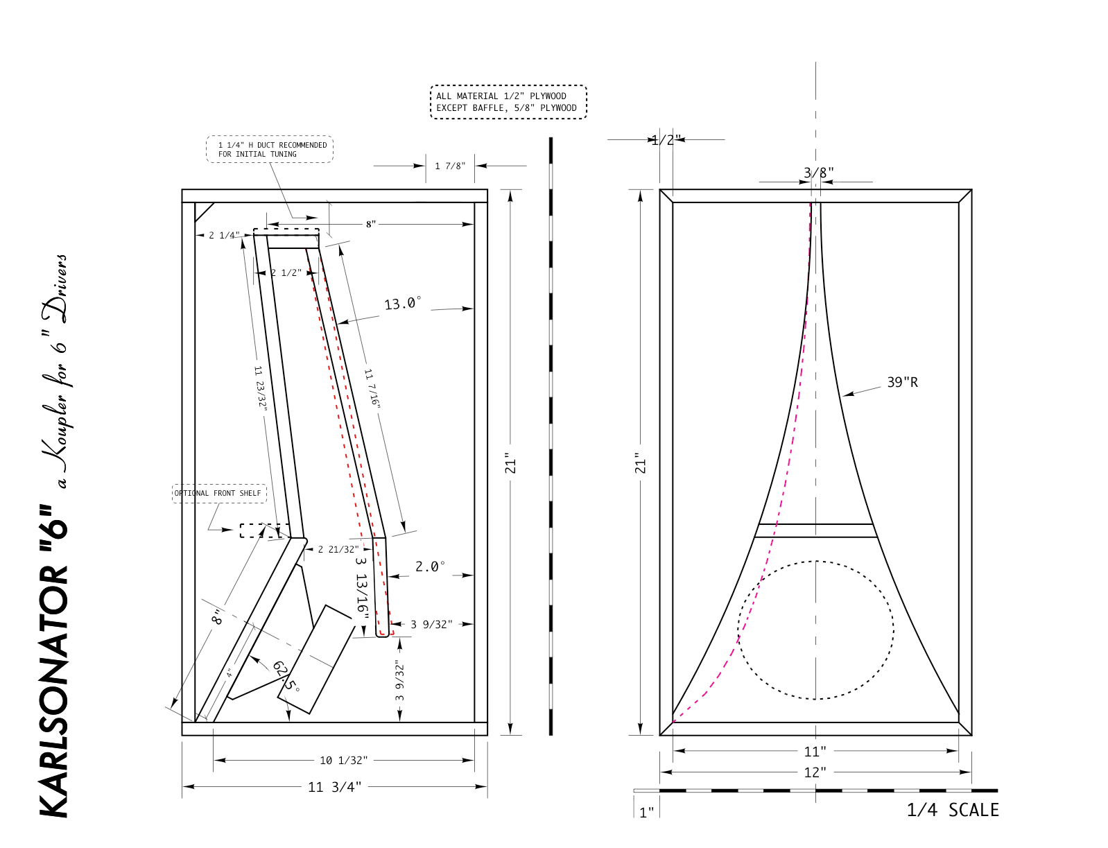

Very impressive work - - Here's a cabinet by GregB which would "work" with that driver. The prototype made of scrap was a bit less is depth and tuned to 60Hz with little damping material other than polyfil in the stub above the driver. In contrast,
Karlson's originals were two chamber bandpass style starting with "K15" from 1951 - it can exhibit less side-band distortion using two tone input than a reflex. I think K
15's front chamber tunes around 110Hz and system resonsnce ~48Hz.
I'd love to hear how you would approach a Karlson -typ0e cabinet -the the idea might not appeal to the scientific mind. (? - I like a lot of what they do vs compromised / small FLH. Are there front chamber shapes which work better than other? Can the curved reflector in Karlson's 3540544 patent do good and if so, how should it be implemented ?
For super tweeters I really liked the old Selenium phenolic diaphragm slot loaded tweeters and sad that category
has been pretty much replaced by 'bullet" style.
Thank you, let me look at this further. Interesting on the "Selenium phenolic diaphragm slot loaded tweeters", do you have a model number?
