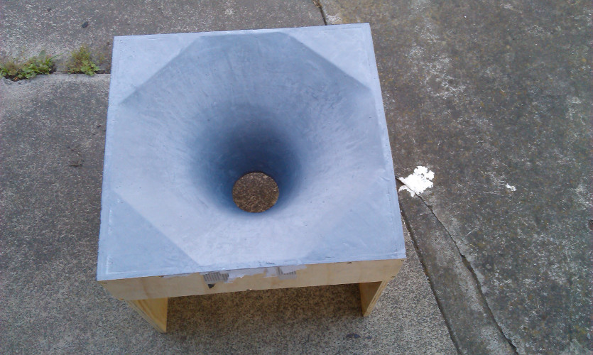

Yes, xrk971: those top 2 curves are the horn. Here is a photo of my test rig. I'm working (slowly) on the 'final' version: horn and two 30cm woofers in one box (picture of that also attached).

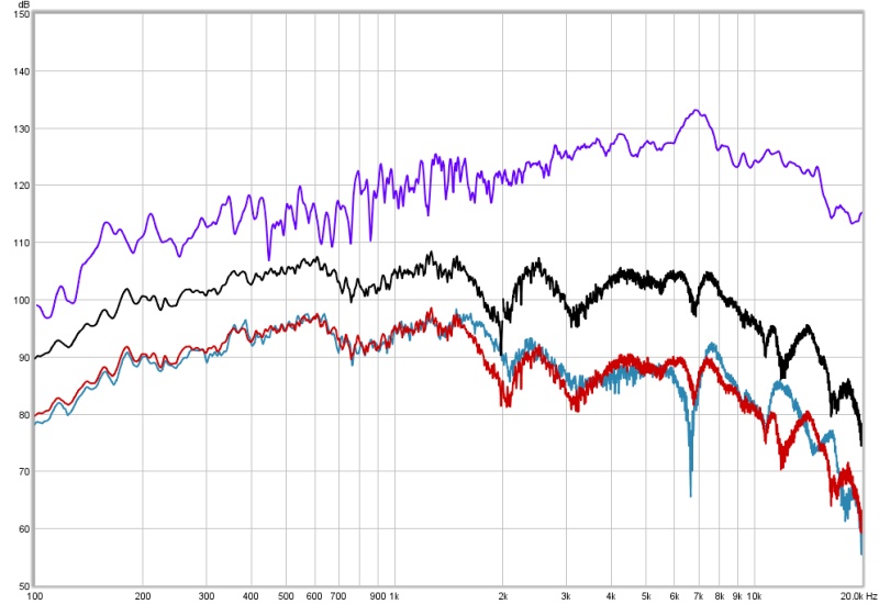

I just took some more measurements of the test horn.
Attached: ground plane, 50cm, with some pillows etc. placed to reduce reflections. It is thus a lazy man's anaechoic plot, and gives a much cleaner graph, but has killed off the treble. Maybe it is anomalies related to mic positioning and so on that has given rise to claims of "falloff cliff at about 4khz" ...perhaps, for horns, an in-room measurement gives a messier plot but a better indication of bandwidth.
Purple / top: the same OB plot as before (1m on axis measurement), as a baseline / reference.
Red & blue / bottom: on axis and about 20 degrees off axis. No smoothing at all - amazing how tidy a plot gets when you take the room out 🙂
Black / centre: the 20 degree graph, snapped in half with -5dB adjustment on the <2kHz section. This is all the eq I have been using; the remaining anomalies seem smaller than the effect of room reflections, or changes in mic / listening position.

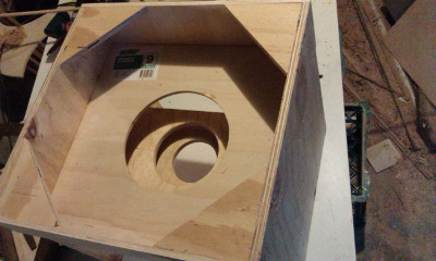

Horn = 20cm deep and about 30cm wide, depending on how much of the roundover you include.
Some of my horn trials are based off 'name' contours (Le Cleach etc), but I also collect found objects like vases to cast horns from. I don't think exact profiles matter that much; since the experts often can't agree, or quibble over what separates them, I decided that the differences can't be that blatant, as long as there is nothing grossly wrong.
The centre of this horn is a found object: an Ikea fruit bowl. The roundover to the baffle was done with a router --> file --> sandpaper. I recently got a drill press, partly to make it easier to produce and test variant throats.
Godzilla: the OB I did the direct radiator testing on was just over 60*60cm, with the driver positioned a little off centre, about 20cm from the floor.

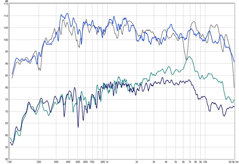

I have a 175Hz tractrix horn (from Volvotreter's spreadshest) designed for a 5in driver (PRV 5MR450NDY) that I can probably stick the FF105WK in and see what happens.
Here is the what I got with the 5MR450NDY (raw is black, EQ'd is red):
Polar response:
It had very low distortion and played very loud but was so clean, you can't tell how loud until ears start ringing - this is 98dB at 2m with only 1.6v applied, look at THD value of 0.1% before noise:

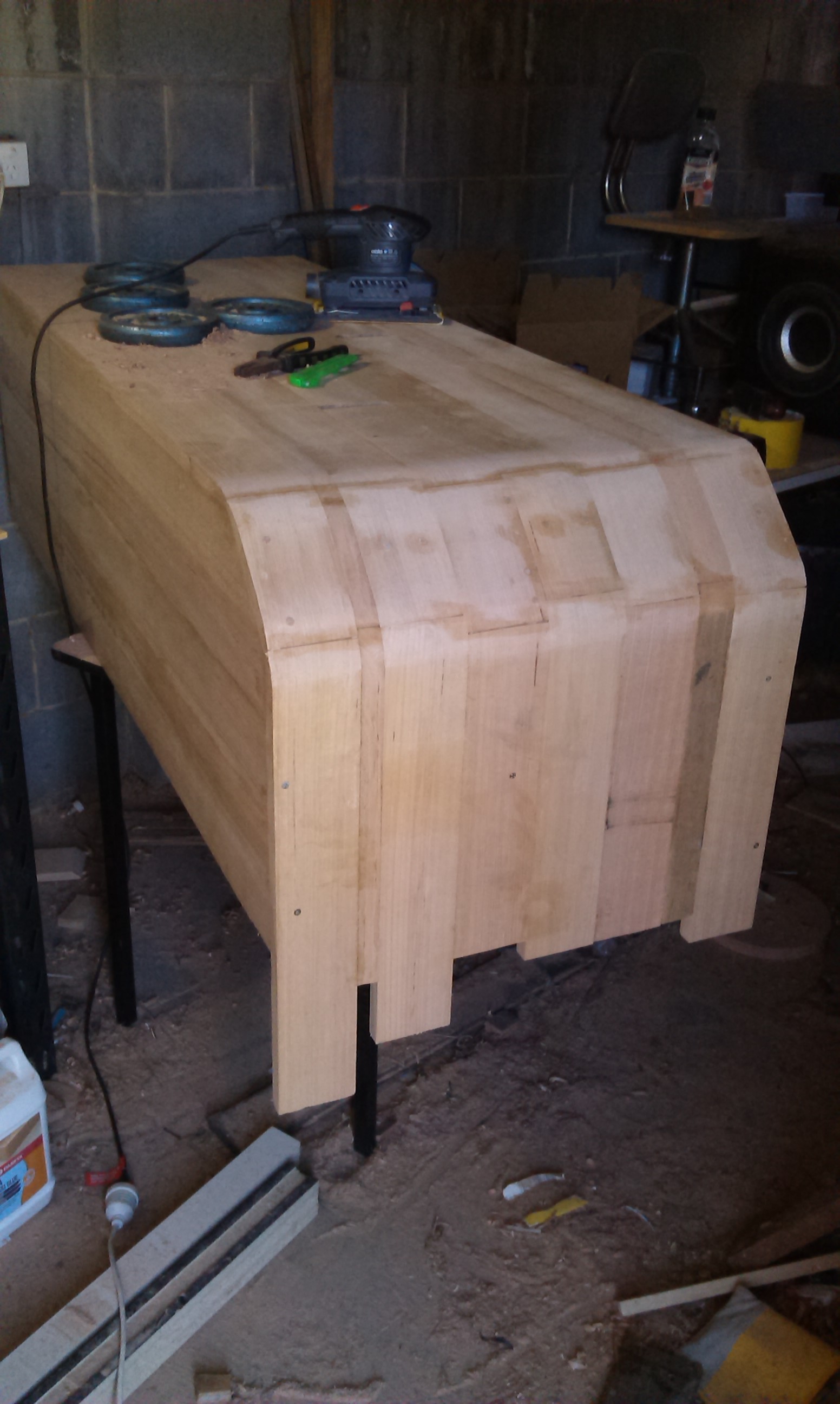

You could build them in foamcore, as X did.
To get a little more fancy, the linked build is pretty impressive looking, but is basically an X build with more patience (and money) applied. Doesn't need that much space, or tools, and wouldn't be noisy - no power tools to disturb the neighbors.
doityourselfaudio: 140Hz Petal Horns
I've knocked together horns from a combo of ply and paper mache, as pictured*. The technique
-isn't rocket surgery
-the frame doesn't take too long
-is a slow but silent build after that (I love listening to music while making a speaker to listen to music...)
-is a good use of scraps / offcuts / salvage, so costs very little
Note: if you were more clever than I was, you'd cut a few holes into the large side panels right at the beginning, to make it easy to add resin / fibreglass / goo / whatever to the back of the horn curve.
All of the above can be adapted to pretty much any profile, and to non-round mouths.

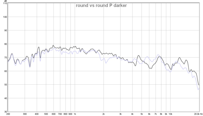

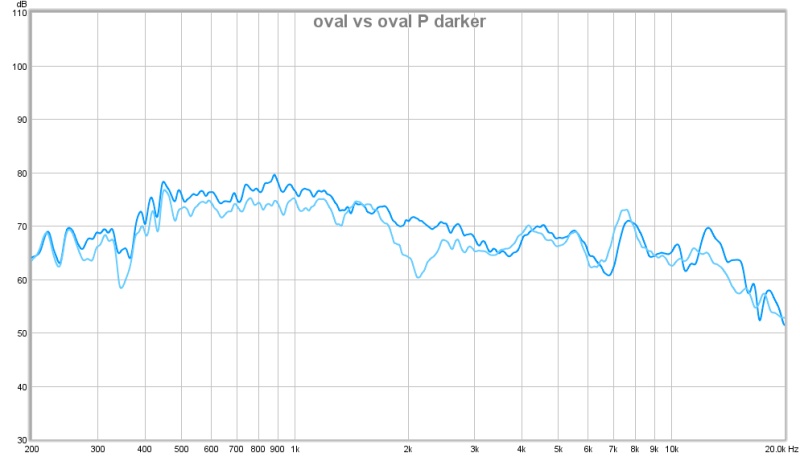

I put together an oval horn, mouth 280*340mm, and compared that to the round (280mm) horn - same distance, mic position (1m, horns and mic about 30cm from the floor).
I used two drivers, the Fostex from the title, and a similar P-Audio unit. The cone:throat is almost 1:1 (no compression).
Caveats:
-the oval horn is obviously slightly larger, meaning a little more depth to get to the same throat size. The round horn was smaller, but on a baffle. I don't think the <500Hz part is comparable.
-the P-Audio driver is a few mm larger.
-I'm not as rigorous as some, so my "on axis" might be 1 degree off for graph A and 3 degrees off for graph B
-no gating, no special shenanigans, so this has room artifacts.
attachment.php
attachment.php
These graphs are from REW*, an average of four measurements: on-axis, 10, 20 30 degrees off axis. The Fostex is the paler trace in both, and has the 2kHz dip in both.
The Fostex prefers the round horn, and the P-Audio seems happy either way. Doesn't seem to have been worth the effort!
*REW averaging seems to weigh peaks heavily - that is, a peak that is only present on 1 graph shows much more clearly than a dip which is only present on 1 graph.

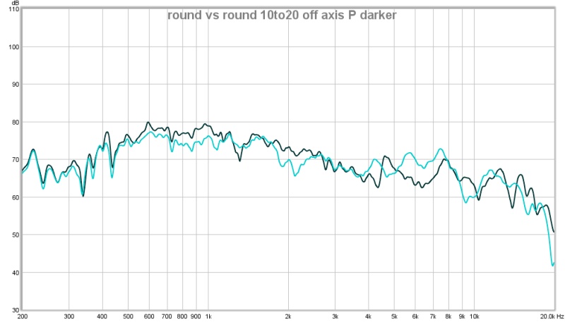

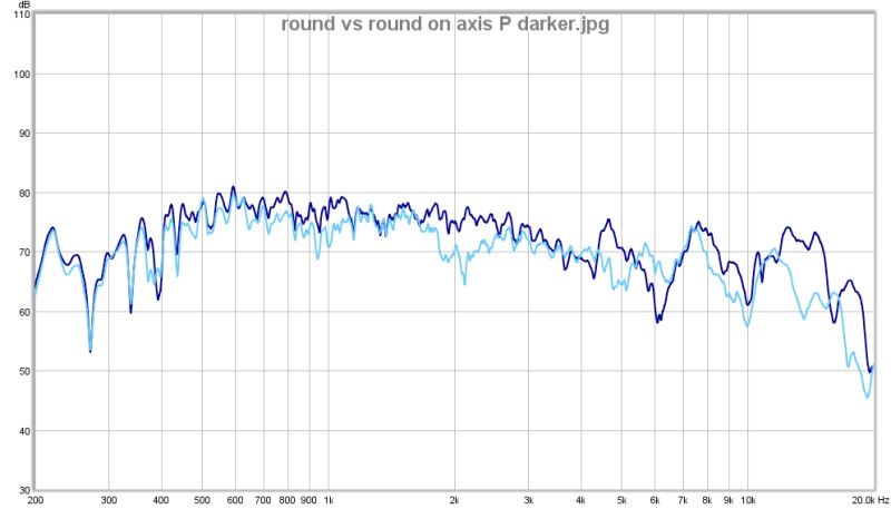

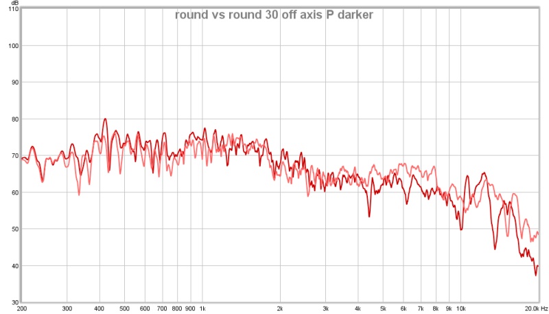

This is a more detailed comparison of the drivers on the round horn. In each graph, the Fostex is the paler trace. The drivers are more alike than different.
The P-Audio is more ragged on axis (4-10kHz), but it flattens out more rapidly as the mic position moves off axis.
Either driver is best off axis, with simple shelving to reduce the output below ~2kHz.
