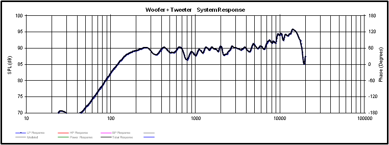

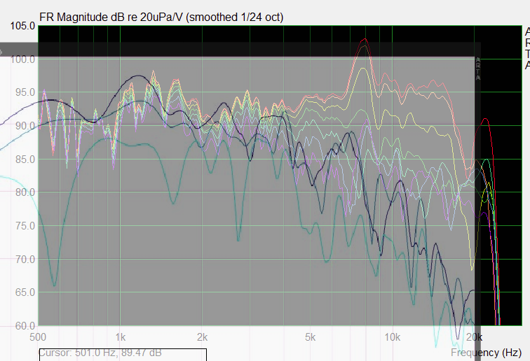

Listening off-axis (horizontal or vertical) is certainly the way to go without any filter (approx. 15°, I'd say). I'd also say 45° looks better in my measurement, though. 😉

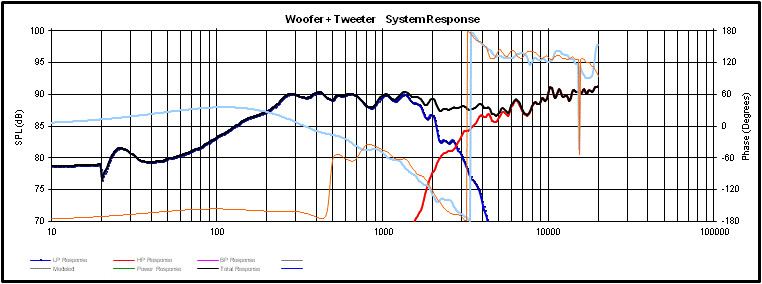

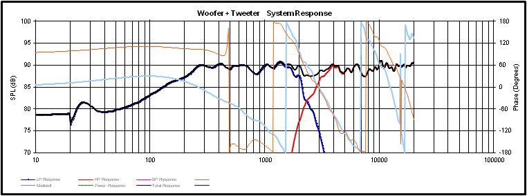

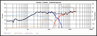

Update:
This is 2-way #1:
attachment.php
This is 2-way #2:
attachment.php
This is the EQ'd 1-way (not an exactly equivalent measurement on the low end, but I wanted to post it in the same graph format):
attachment.php
These all sound pretty good and pretty similar, according to me. I have attached frd files for the drivers, post-EQ, if you'd like try coming up with active xover schemes for me to try. It's not like I'm that great at this. Here are the details you'd need:
- vertical driver spacing is 9.8 cm, or +4.9, -4.9 (measured on midpoint axis).
- woofer acoustic center is behind tweeter's by 0.7 cm.
- you can use delay in 0.02ms increments.
- these are already minimum phase, not corrected for mic distance/delay. They seem accurate enough down to anywhere you'd need to know phase for xover purposes, but if you think I need to do a better job, feel free to ask.
I will take off-axis measurement sets at some point.
No, I was done for the day when I posted that. I always end up wishing I posted more info after posting graphs like that... Many people will know what's up by what's on the graphs, but I don't mean to be misleading. The 2-way graphs are accurate above 1k, and reasonably good to 300Hz (for real bass extension, see first page). The 1-way graph is a bit flawed below 2k - just trying to show response over xover point, as it's all the same speaker below.
For comparative off-axis measurements, I will do everything identical and on the same graph.
