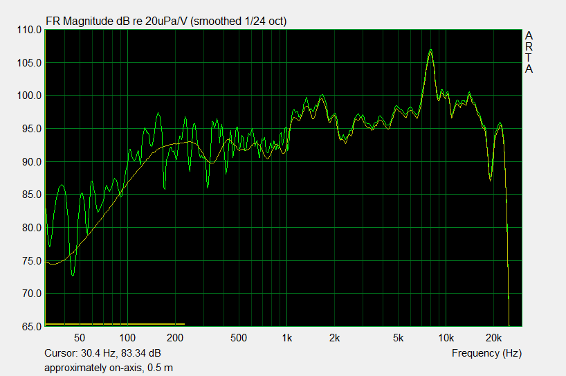

To kick things off, here are a couple quick ones. The drivers are in the cheapo Fostex Kanspea boxes, and thoroughly broken in. We've got the 0.5 meter response, somewhere close to on-axis. Farther distances did not show significant changes, so I stuck with 0.5m for best psuedo-anechoic range. Looks to be in reasonable agreement with the published response, except for the obvious step down corresponding to the small baffle.

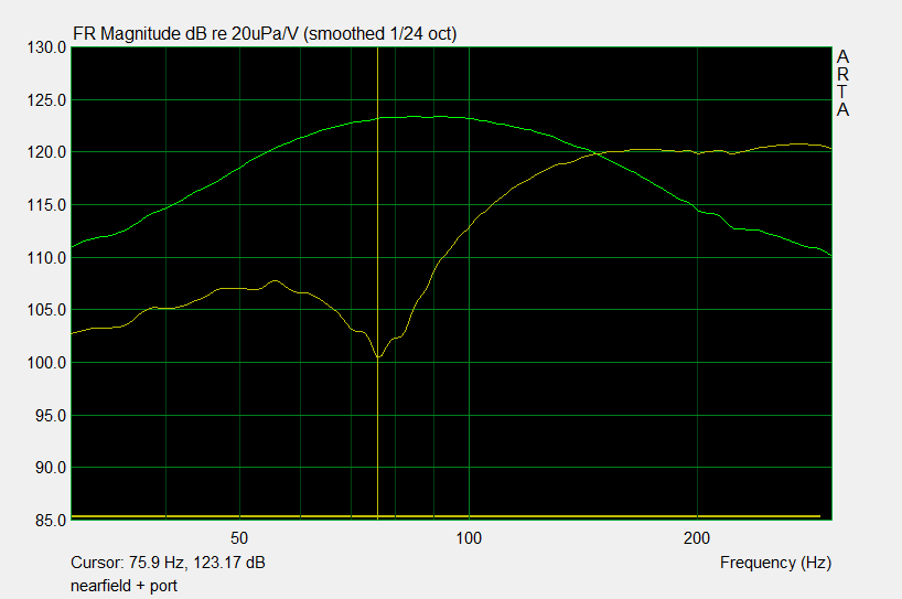

Also, even though it has little bearing on this experiment, we've also got a quick check of the nearfield bass to see what's happening with the little cabinet. Now, if I could just find a ****** protractor...

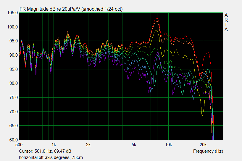

Horizontal 10-degree measurements (0-60°). If you haven't figured it out already, these are dual-gated measurements, so you see a transition to reflections being included at the low end. The 2-7k ripple that increases off-axis is also a reflection I accidentally left in, but its influence is nothing but that little ripple. Don't worry, I can be less sloppy when needed, just checking out the basics here.

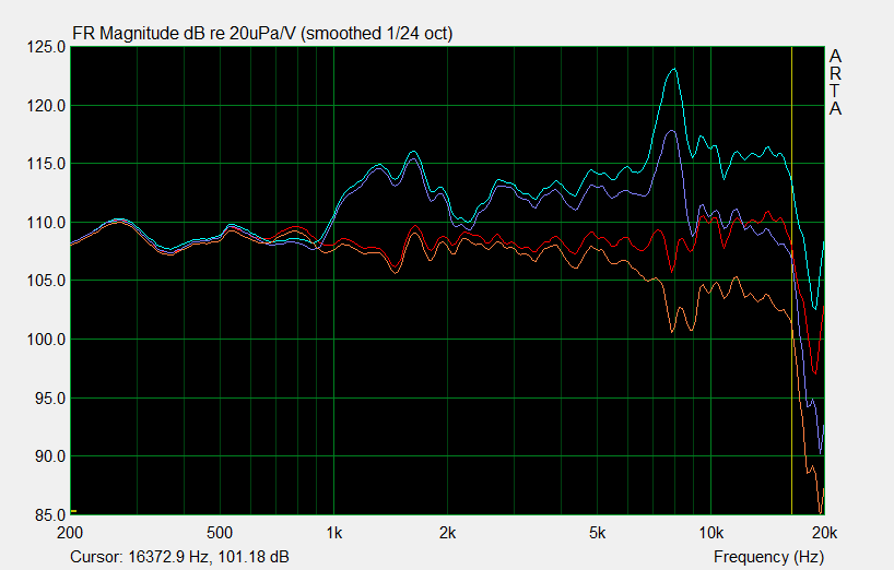

Here's DSP used to EQ the driver. It took several rounds to get the treble sounding decent, but I think now I have it in the right neighborhood here. How's this sound? Well... it sounds okay. I don't know why ARTA isn't putting the color key at the bottom for me right now, but this is on-axis and 20 degrees off horizontal for each.

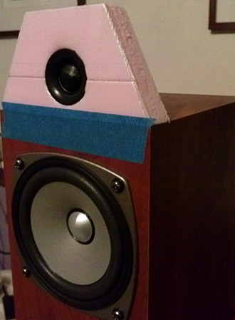

While I play around with that, you can admire my high tech rapid prototyping techniques:

Hey, at least your woofer box is wood. I had to make one out of cardboard to get a decent response out of a tweeter and woofer so I could measure them! 😀
I even used the same blue tape to tape the edge of the woofer frame. I was amazed at the reduction of diffraction!

Like to use foam and coroplast for fast prototyping myself. Now where is my diffraction compensation clay 😉
