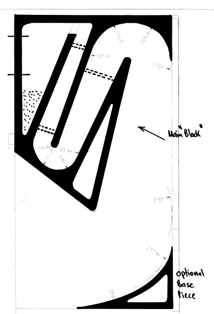

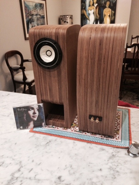

Getting into foam board speaker building with my son this weekend. Received my VIFA TC9FDs last week.
One question - do you have drawing details for the Cornu Spirals? Looks like they are built using the foam boards.

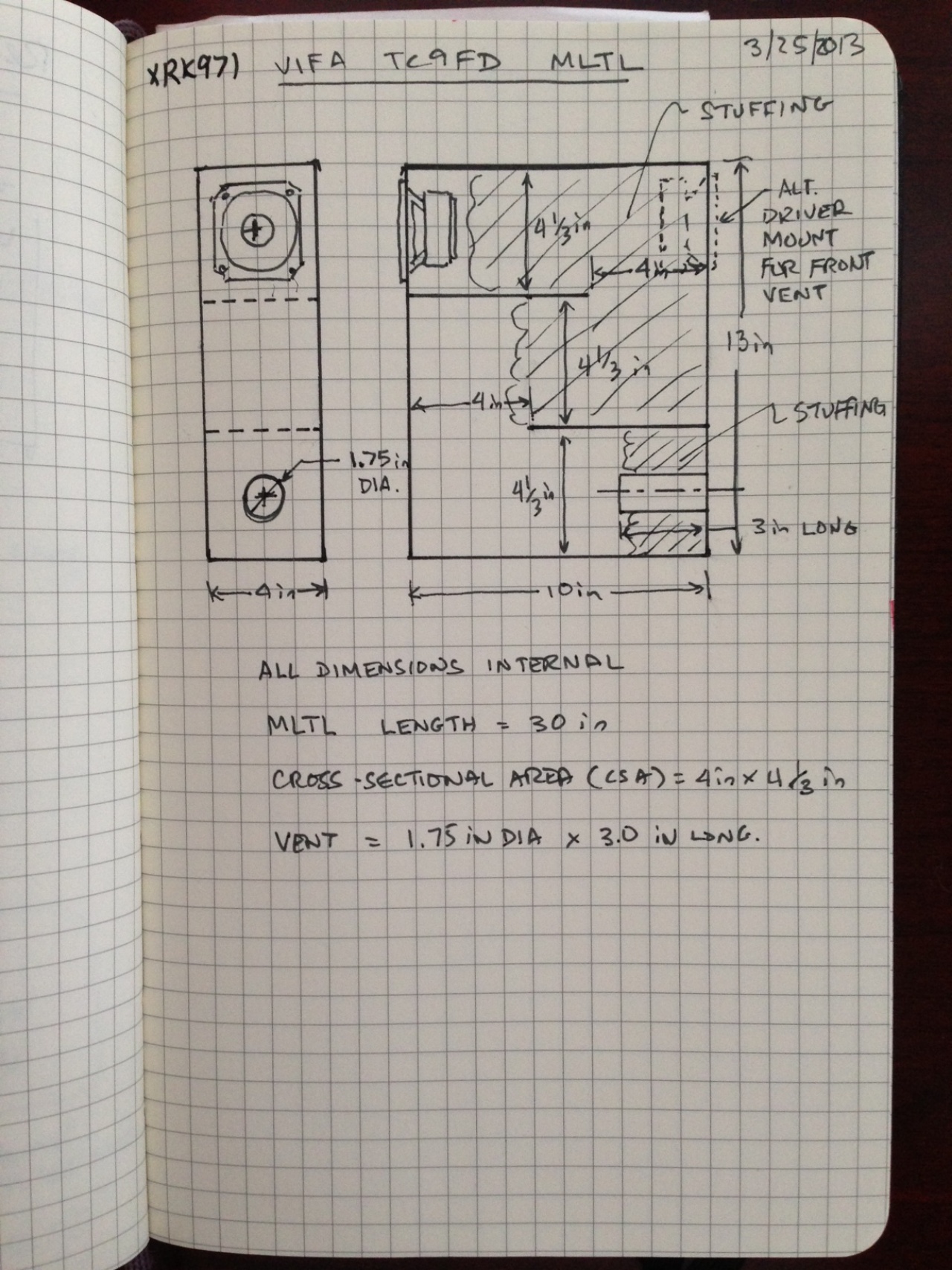

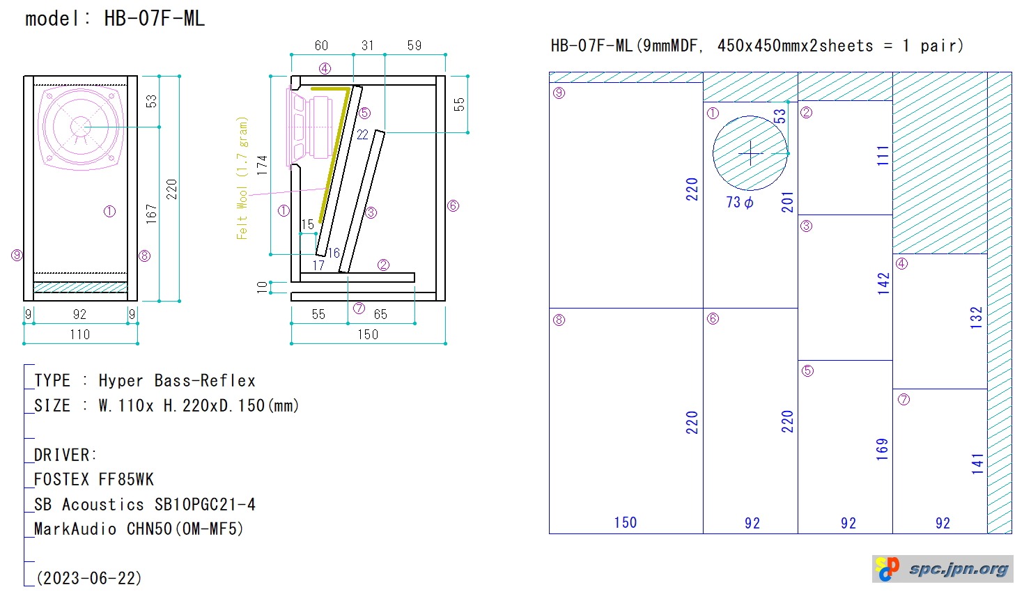

here is the design for a compact folded MLTL using the Vifa. You can mount the driver so that the vent faces forward or backwards depending on your preference. Back vent if placed near wall can augment bass even more.
X
I am unclear as to how to stuff this enclosure design when using the front vent (driver flipped to other side). Seems like you don't have a continuous 30" path to the vent like for the standard mount. Can you clarify?

I have a couple questions;
- I know the drawing shows where the stuffing goes, but wasn't sure how much to use. I bought a bag of Acousta-Stuf, but I've never stuffed my own speaker cab.
- How exact does the length of the port have to be? Presently, they're closer to 3 1/4", but I could always take the saw to them, again.
I'll post pictures once they're finished.
3.25in long is not a problem. Also, you should use a baffle step correction circuit. For 8ohm driver and a skinny cabinet use 1mH air core or iron core (cheaper) plus about 4.7ohms to 6.8ohm or to 8.2ohm resistor in parallel between amp and +ve terminal. This will attenuate the mids and highs in a shelving filter and balance the bass and highs. Adjust the resistor to taste. Speaker will sound less fatiguing and warmer.

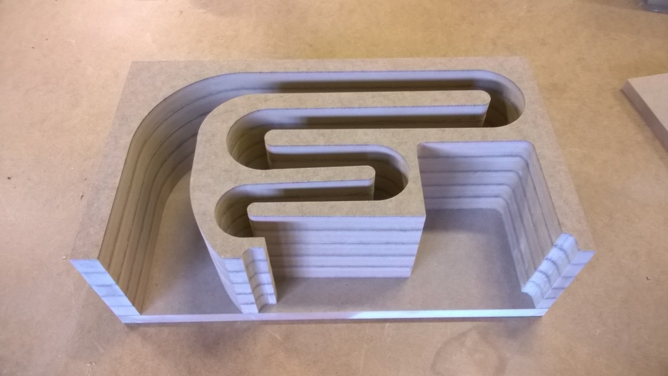

I've enjoyed the Fostex 108EZ 4-inch driver in a DIY CNC'd back loaded horn (first one in MDF, then Euro birch ply versions).
A mate also used Jordan drivers in my horn.

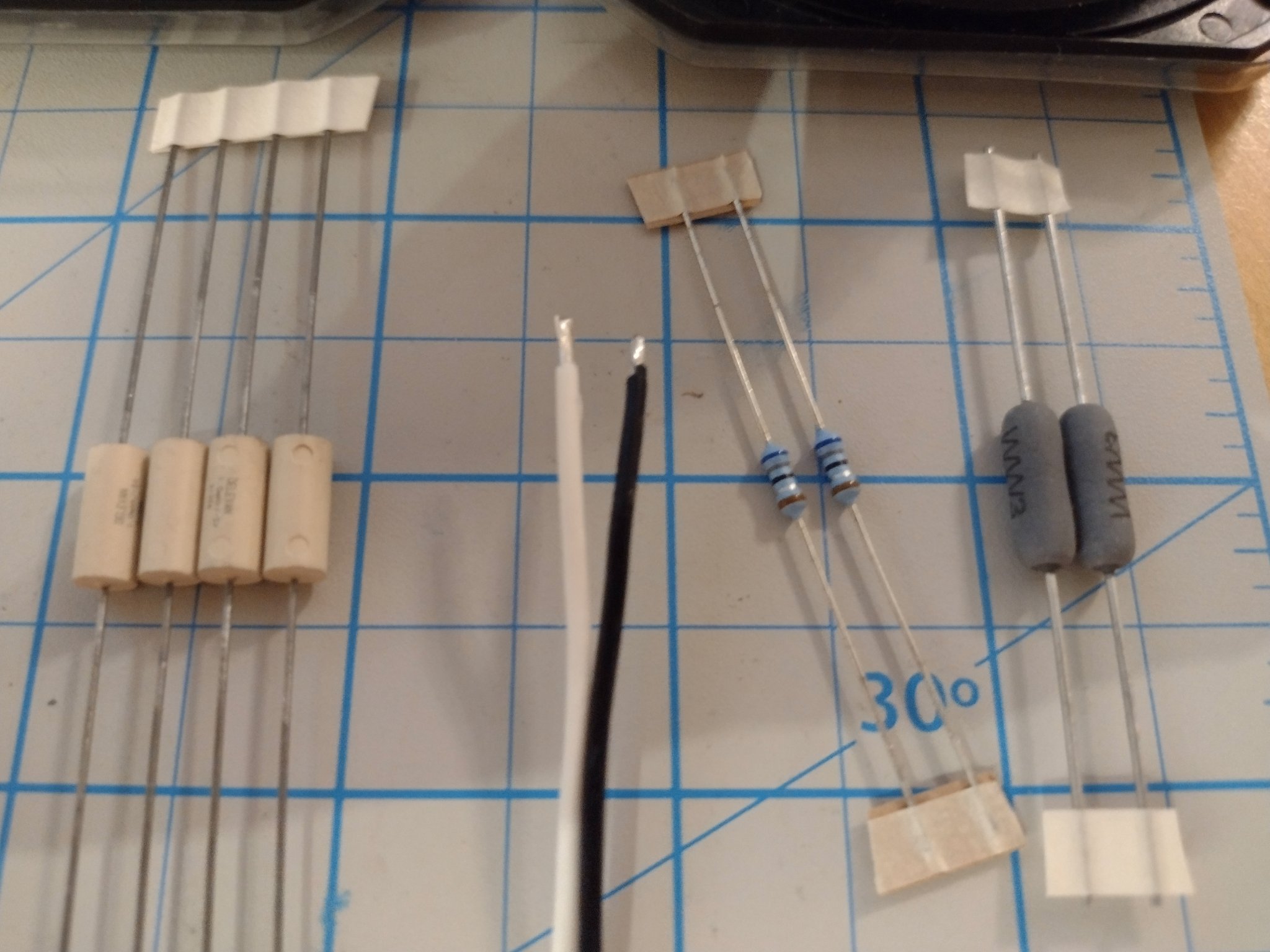

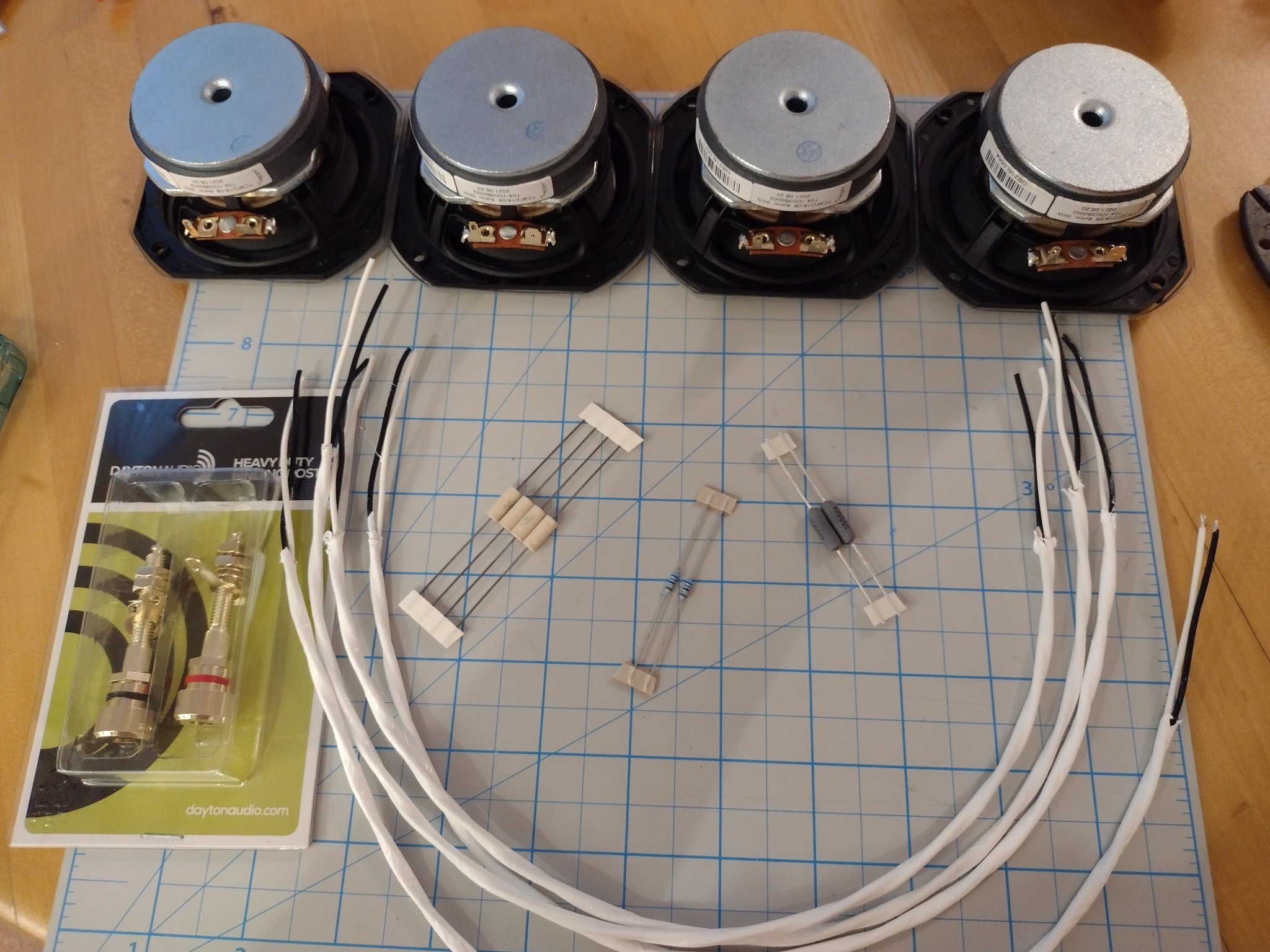

I just want to be sure - we're talking about inductors here, correct? I'm no engineer - merely hanging off y'all's coattails. I've got a digikey cart going, with your recommendations, XRK. I think these inductors are what you'r referring to...For 8ohm driver and a skinny cabinet use 1mH air core or iron core [...]
https://www.digikey.com/en/products/detail/api-delevan-inc/2500-28J/3479912
And the larger of the two connector tabs on the driver is the positive lead? I can't find anything designating which is which.
Do the higher ohm resistors trim the higher frequencies, or the other way around? I'll give a baffle step correction circuit a try. Although, I tend to be quite sensitive to tinny/bright speakers, and I haven't noticed that with these TC9FD's at all. Perhaps because they don't get very loud? Or because I've been listening to them off axis all this time?

I guess the stuffing isn't all that critical? I'll just stuff 'em like turkeys and presume I'm making things better and not worse.

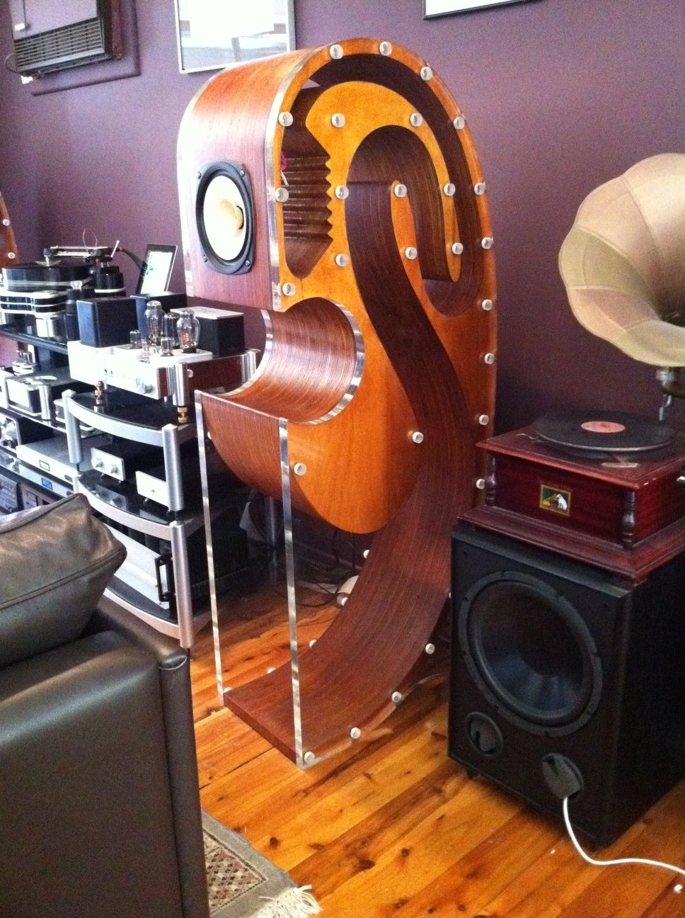

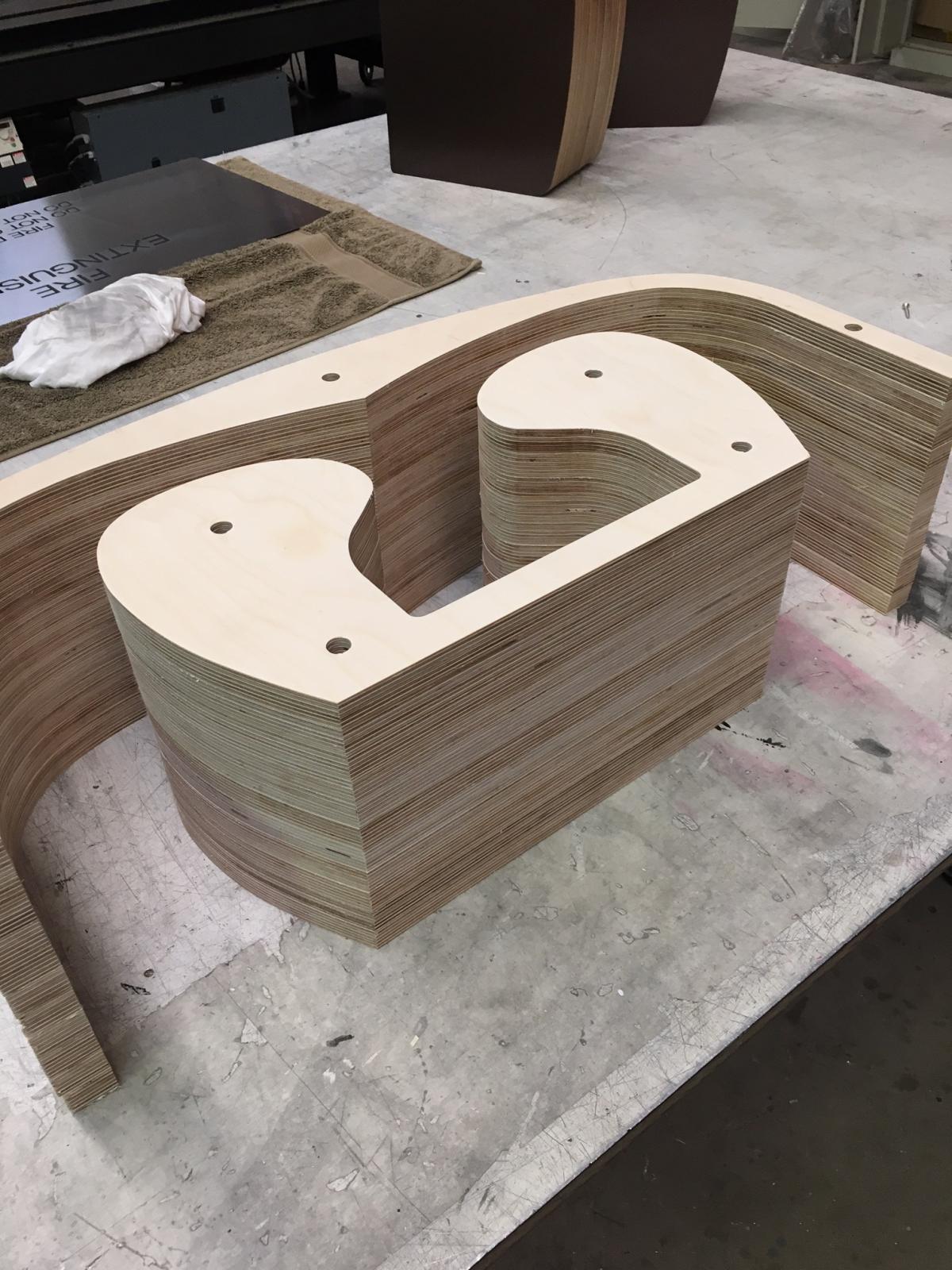

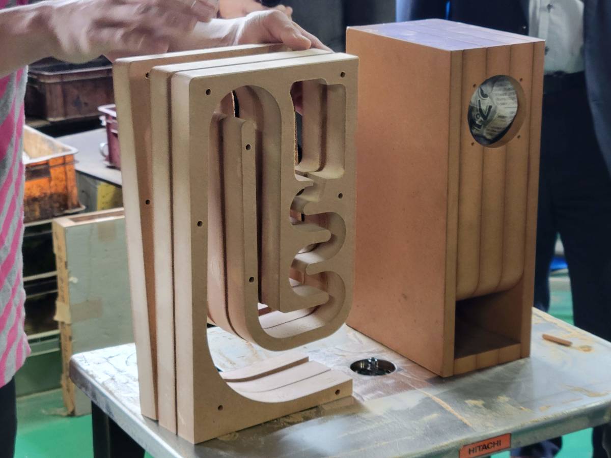

Those are beautiful cabs, Atilsley! That cross section is really neat to see. Free shipping to The States with purchase, right? XD
Quilip, thanks....or you could use CAD file.....cheaper than OS freight...!! Of interest, those small horns went into a Home Theatre rig, using my BLH cabinets for fronts (with Tang Band W8-1772 8-inch woofers, with a horn-loaded centre channel, with same driver.
Not really a horn, but a badly designed TL. And translam is such a waste.
dave
A similar BH kit has been sold in Japan for about 25 years.
It seems to be selling well there because it is easy to assemble.
When I actually listen to it, I do not feel the goodness of a backload horn and the bass is cheap.
It certainly sounds like a poorly designed TL.

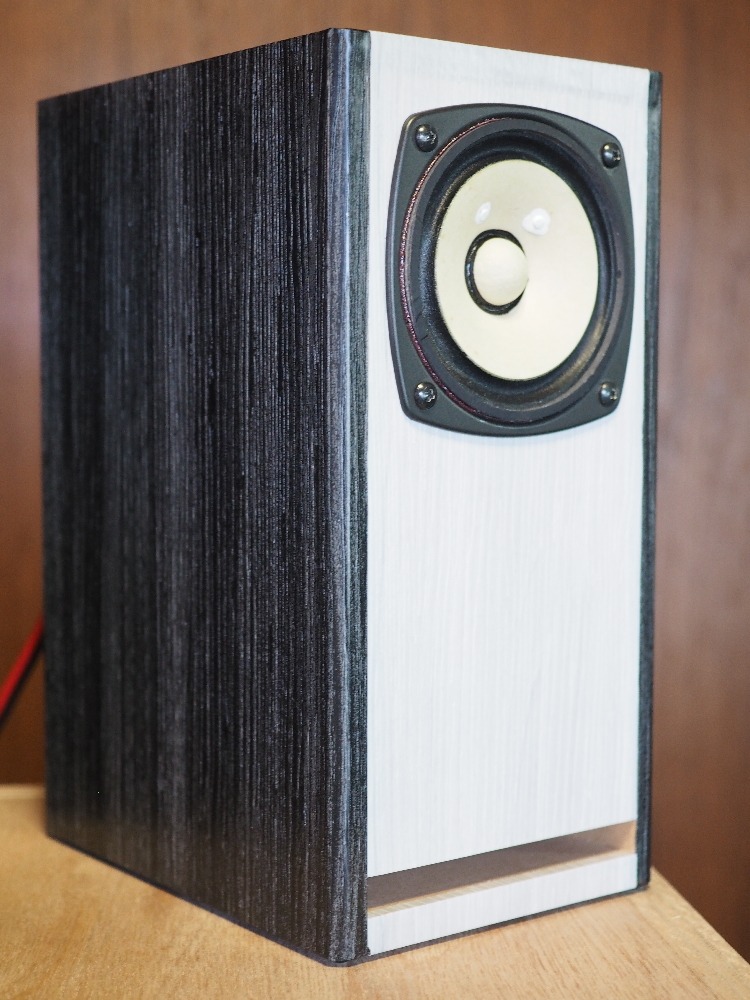

- Full Range
- Fostex FE83En the right small box?
