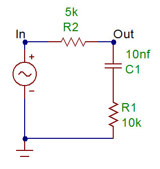

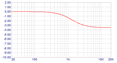

I have had better luck with a shelving network, something similar to the attached.
