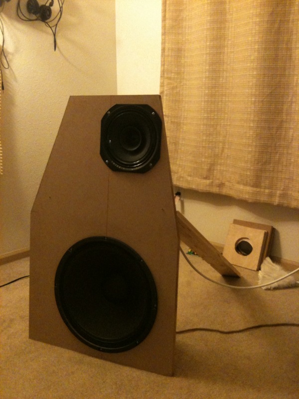

I've been using the AN8 in an OB crossed to the eminence alpha 15 at 150 Hz. It sounds phenomenal. It helps if you have an active crossover, as well as other tricks such as notch filters and shelving filters.

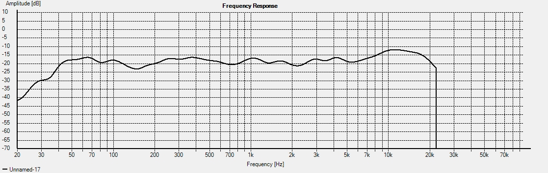

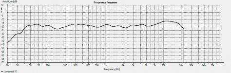

I've measured the AN8s and they have two big resonances at 3 kHz and 4.5 kHz which gives them the peaky/shouty quality. But this, I'm assuming, is a hallmark of all high-eff full range drivers with a whizzer. There is also a nasty bump in the response around 10-14 kHz which makes the 'sssss' sounds really harsh to listen to.
The geometry of the baffle takes care of the rising response. Baffle geometry designed using 'The Edge' software.
The notch filter is set at 4.5 kHz. I found this to have a better sound than one at 3 kHz. The notch filter really cleans up the sound really nicely and makes listenable at loud volumes. Crossover is FirstWatt B4.
I've added wings near the woofer to the baffle you see in the picture. The wings are 15" tall and 12" deep and help support the baffle.
The dip at 150 Hz and subsequent bump is an artifact of adding pillows near the woofer during measurement. There is a slight 150 Hz dip even without the pillows and I'm trying to address that with the side wings. The response is in-room with little else done to prevent reflection. It is smoothed to 1/3rd octave. You can see the two little bumps at 3 kHz and 4.5 kHz. They show up as nasty resonances on the CSD plot. The bump at 10 kHz is also very audible and is easily fixed from Foobar. But I just leave it as it is.
All said and done, this is a phenomenal driver for silly money, really. Everyone should own one!

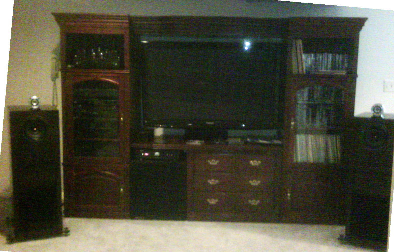

I have the Audio Nirvana Super 8 Cast Frames installed for about a month and a half. As you can see in the picture attached (forgive the poor quality, I just took them w/my cell phone) they are doing double duty as 2 channel audio (Korneff 45 Sei SET integrated amp) and as part of the 5.1 surround setup (B&K SS receiver), thus they should break-in sooner than w/just 2 channel duty.
The large black square at the bottom left center is a Velodyne 18 HGS sub that can go down to 16 HZ if need be. It is connected to both the Korneff and the B&K and crossed over @ 80Hz using the sub's own adjustable filter. The Velo has a 1500w built in SS amp, that can deliver up to 3000w if need be. It also has a servo controller that adjust the driver excursion to prevent undue boominess by analyzing the input signal vs. the output waves and making the necessary adjustments in real time. Thus, I can have my SET 2wpc bliss and the SS punch both at the same time. For most music the sub is not needed w/the large horns, but when required (organ music and rock) I'm glad it is there.
I know I'm not being much of a purist here and you may call this cheating, but what the hey! it is all about the music, isn't it? I believe the AN's are going to be w/me for a long time.

Hello Eagertrader!
Don't worry about "cheating" it's your system and your ears that you have to make happy! I started out much like you did with full range drivers. In fact, I've been using different "full range " drivers in Sachikos double back-loaded-horns for over 2 years now. I started with FE206E full range drivers, pulled them out and replaced them with FE206ES-R full range drivers ---{that provided better clarity and better frequency extention at both extremes}--- but unfortunately like all full range drivers I've heard, they both had a shout that became more & more noticable as they got to a certain loudness and louder than that they'd start to breakup completely sonically and become unlistenable. Despite that fact, in many ways when kept below a certain dB threshold, these were both producing some of the best music I had ever heard, but their faults eventually became more & more noticable & more & more unbearable.
In the end I pulled the FE206ES-R out and replaced them with FE208ES-R full range drivers. These have no whizzer, hence no shout. In addition to that they have a much larger & stronger 6.3Kg Alnico motor! So clarity, transparency & inner resolution was like that of great ribbon or electrostatic. Dynamics & transient response are startlingly lifelike as well. Unfortunately with these wonderful improvements came some restrictions as well. Due to the FE208ES-R driver's much stronger magent, Qts and other values changed. Now to try an make a looonnnggg story as short as possible, with the FE208ES-R in the Sachikos playing full range, they roll off naturally at 100Hz at the lowend & naturally at 8Khz on the highend! However to my delight that 100Hz - 8Khz was the finest I've ever heard from any driver cone or otherwise.
They not only rivaled the best ribbons, ELS & horns, they also seemed to combine their salient points while leaving their weaknesses behind. They're capable of easily hitting 110dB peaks ---{measured in-room}--- without an ounce of strain, but 100Hz - 8Khz is hardly full range music reproduction. I knew I had to do something, but there was absolutely no way in hell I was about to mess with what I now heard with the Sachiko/FE208ES-R combo! I did that once before and ruined everything. So this time I decided to just well enough alone and leave the FE208ES-R drivers running full range and just augment their extremes as needed. On the highend I added a pair of large dipole Heils to cover from 8Kz - 25Khz and on the low end I added a pair of 15" Hawthorne Audio dipole "Augies" to cover from 100Hz and lower. The "Augies" which ar on loan from a friend John K. of the Space Coast Audio Society are temporarily being crossed overed & powered seperately by some pro gear on loan from a friend Paul B from the Central Florida Audio Society.
These days from 25Hz to 25Khz, I, as well as friends from Central Florida Audio Society, SETriodes Group & Space Coast Audio Society believe the sound is reference level or worldclass. It sounds like a great ribbon or electrostatic with the transients & dynamics of a horn! It has to me heard to be believed. I don't consider it cheating at all! I still use the Fostex full range. I'm just helping to fill-in what's missing at the extremes. Have you ever heard the song "If loving you is wrong" by Luther Ingram? If so you'll remember the line that went "If loving you is wrong I don't wanna be right. If being right means being without you I'd rather live a wrong doing life."
Well as far as my system now goes I'd paraphrase it like this "If using augement drivers is wrong I don't wanna be right. If listening right means listening without them I'd rather listen wrong than right." If that offends others I'm sorry, but this is the best I and many of my friends have heard. Besides it's my system and my ears, right? So keep up the good work and keep searching for what sounds best to you! I'll end this be highly recommending that you listen to as much live, unamplified ---{whether it's a folk band, bluegrass, Metallica unplugged or a Symphony doesn't matter}--- music as you can so you know what the music and instruments you like really sound like in a variety of enviroments.

ra7, I just ran into this thread. Thanks for the sweep data. It will give me an idea of what to look for since my system will be nearly identical to yours except I'll have an Hframe on the Alpha 15's. My ears are also pretty susceptible to those mid peak shreaks, so I'll be sure to look for them. I'll have a MiniDSP for that stuff.

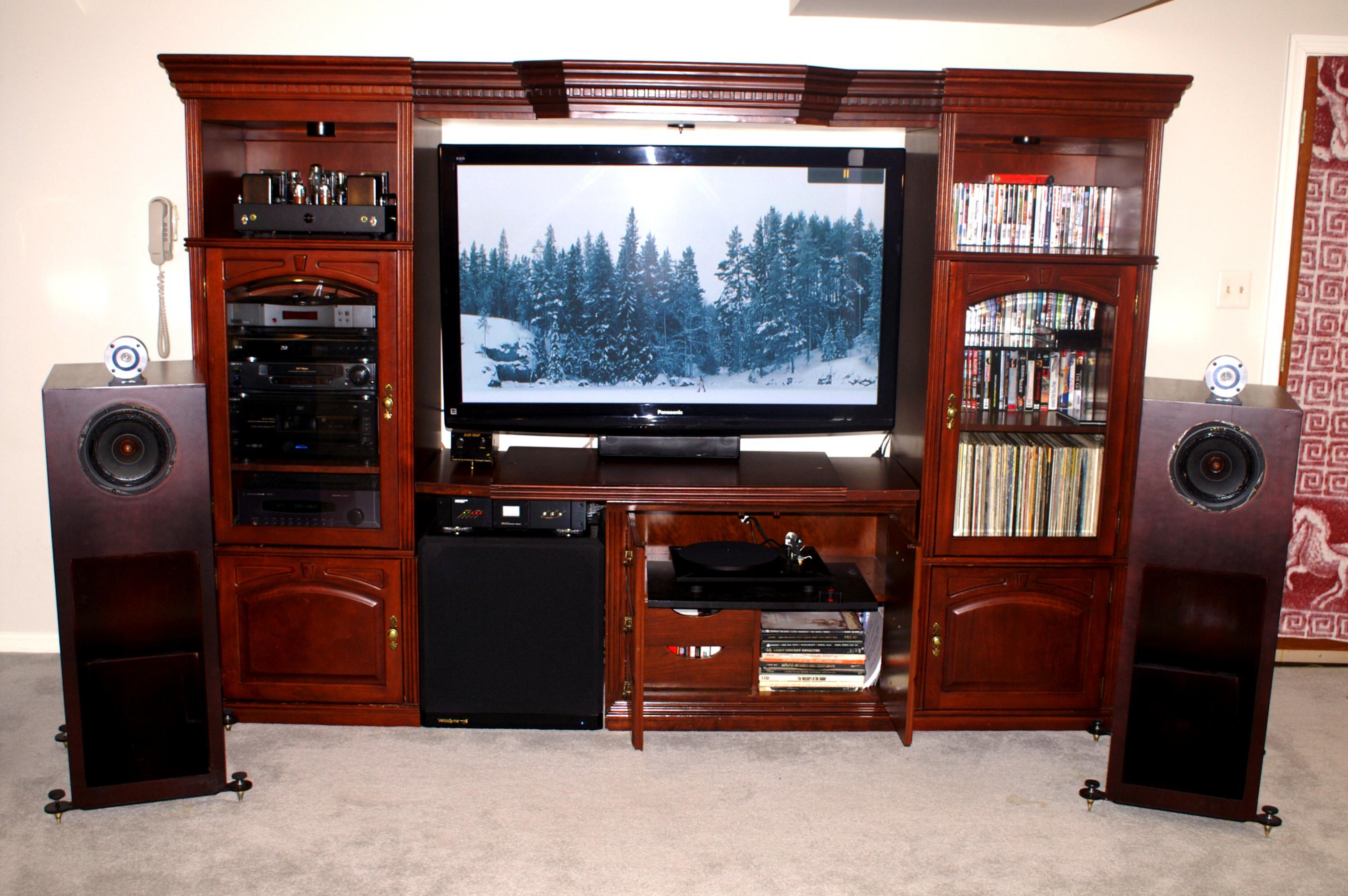

Roscoeii, I apologize for responding this late. Regarding the Realistic Super Tweeter, I believe that back in the 70's Fostex made them for Tandy Corporation. They sounded good, but I replaced the capacitor with a 2.2uF Obligatto cap and they sound now much sharper in terms of rounding off the field definition, and extending the highs into the realm of the inaudible.
Probably one of the best bargains in audio. They come up for sale on the 'bay all the time. I highly recommend replacing the stock cap though.
Easy to integrate, you just add it to the same speaker line, and the built-in crossover takes them from 5Khz upwards. The sonic improvement in your system is immediately noticeable. See picture of the tweeters on top of my BLH's.
Hope this helps.
