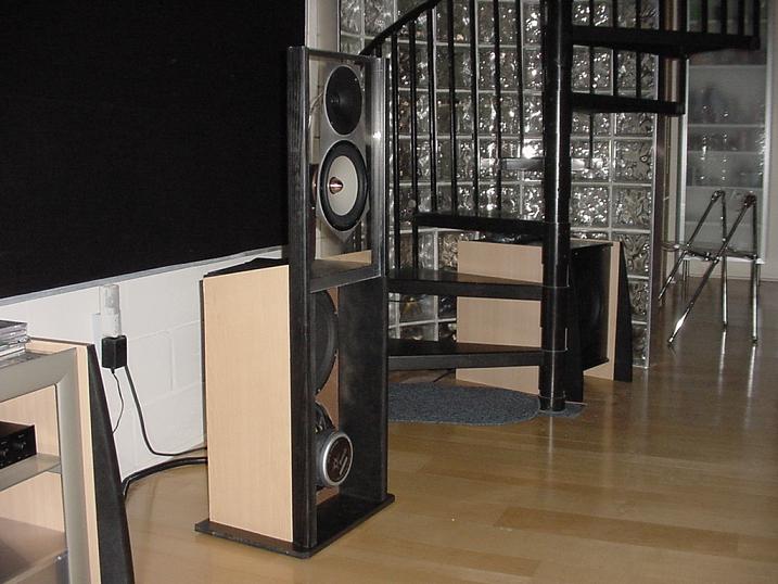

Ruby 3-way
Ruby 3-way

I've not experienced any of what you've described in my 3-way system. One of the most challenging pieces of recorded music these days is the 1812 Overture on the Telarc label. I guarantee I play it louder than 70db and I've not experienced over excursion or clipping. In fact, the cannon blasts are handled quite admirably with the Extremis handling the major part of that duty.

Hope we can be pal's now that we agree on so much more. No more of that cussing stuff. Post some pics of the whole rig when its done. I'd really love to see it.
Here's mine just in case you forgot.
My idea of "full" range.
