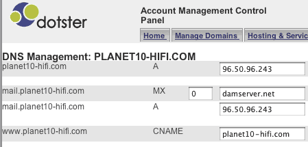

Dave, if you log into your domain registrar (Dotster, apparently), there should be an option to create / add the MX (mail exchanger) record. I can help you, if you like!

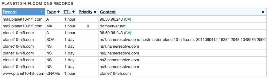

I get email on my planet10-hifi.com accounts just fine. It has been unchanged and worked since July 2004. Here are the DNS records. You will note that the MX record may be a bit strange, but that is the proper way to set it up with one mailserver handling multiple domains.
Takes me a while to put mail where it belongs but there are currently >1000 emails in my planet10-hifi.com in box. Worked for each one of those.

Further if i go to Who.is: Whois Lookup, Website, Domain Name, and IP Tools - Who.is and search they find the attached DNS records.
Triode3, i think your lookup tool is just a bit simplistic. What email account did you send mail from (it may be different than the one i searched for)

I see the issue that I am seeing... which is that planet10-hifi.com has no MX record, but mail.planet10-hifi.com does. My mailer does not auto-resolve planet10-hifi.com to mail.planet10-hifi.com when sending mail. I find it very odd that other mailers will send you email. I ran two ISPs in a former life, and know a bit about it.
dig is not a simplistic lookup tool by any means, I am only using the simplest of mail queries with it in this instance...

Note, if I look up your mail exchange records for mail.. it works:

I rarely see anyone who puts the MX record for the mail server itself, and then does not point the "domain" name to the record, even if you have someone else doing mail for you (spam, load balancing, etc). For example:

Note that google has 5 mail servers, but an mx on "google.com" works.
