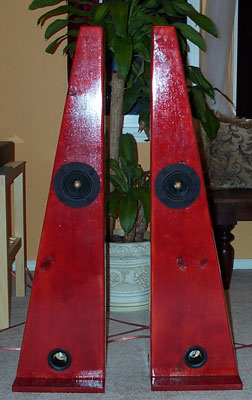

This is a tapered quarter-wave tube built using the RS 40-1197 which is similar to the Fostex FE103. The FE127 would work well in a slightly larger version of this enclosure. As joensd states, you could build a classic QWT which looks more like your typical speaker box. Also, consider making it a bipole.
Have tried FE127E in the folded TQWT. Really not much harder to make than bass reflex, it needs one slab more (and yes, the box is normally bigger), that is all. The results in the midrange are outstanding. However, though it plays the bass and it plays it defined, it does without authority. One would never guess what such small driver supported by box can do, but it is not yet what should be achieved (IMO). And more important, this driver has bump in the 4.5-7kHz range. The break-up is not even remotely pleasant.
In my opinion FE103E covers the “full-range” in the more effective way. Is somewhat smaller and has somewhat taller Fs though.
