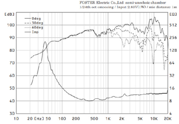

Fostex FE108NS 4" Full Range
Teansfer function 250hz roll-off followed by peaks, dips and peaks and dips look terrible to me.
Perhaps a front horn to bring up the low treble - upper mid combined with a BLH to help with the bass would even things out more, IDK. Looks like a lot of work.
I don't recall the limited ed FESOL series this is based on as having such a ragged Fq resp. transfer function.
What am I missing here, are you seeing something I'm not?

Almost all speaker driver makers are VERY conservative and slow to embrace new stuff. Even so a 20 year old gem like the FE108e∑ is still a competitive driver. FExxx in general have some significant issues, the really nice ones are few & far between. They ar enot without their assets, and many people love theirs. Most FExxx are also expecting to be driven with a higher output impedance amplifier. Fostex has made more than a few that were dogs (ie FE138e-SR). On paper this one makes me think it might be one of those.

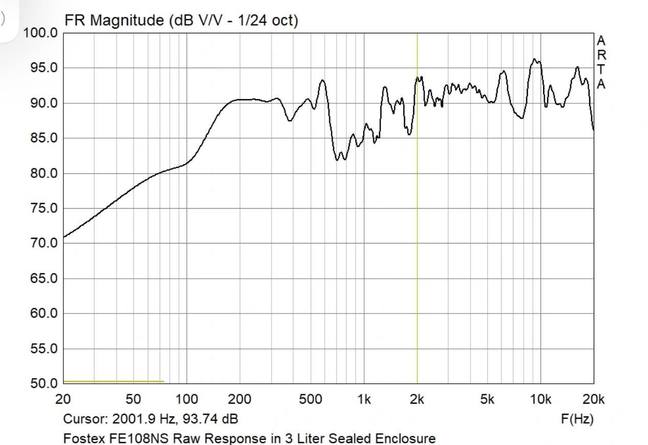

I can confirm that the FE108NS does indeed sound excellent. I commend Fostex for publishing truthful response graphs.
There is indeed a -5dB dip at 750Hz. But it doesn’t seem that bad once mounted in an enclosure. The overall sound character is similar to the FE108EZ but will a little more attack on the leading edge of transients. Overall a beautiful sounding driver. Shown is the response in a 3 litre sealed enclosure measuring 190mm wide.
Fostex’s most recent published data is no better or worse than actual test data from other brands with similar full range drivers. It’s simply that Fostex no longer publishes frequency response graphs with 1/3 octave smoothing. You can see this in my most recent blog post where I compare the FE108NS against the long standing FE108EZ. The new NS version actually measures smoother than the EZ series. Off-axis polar maps are also improved with the new version.
https://josephcrowe.com/blogs/news/fostex-fe108ez-versus-fe108ns
