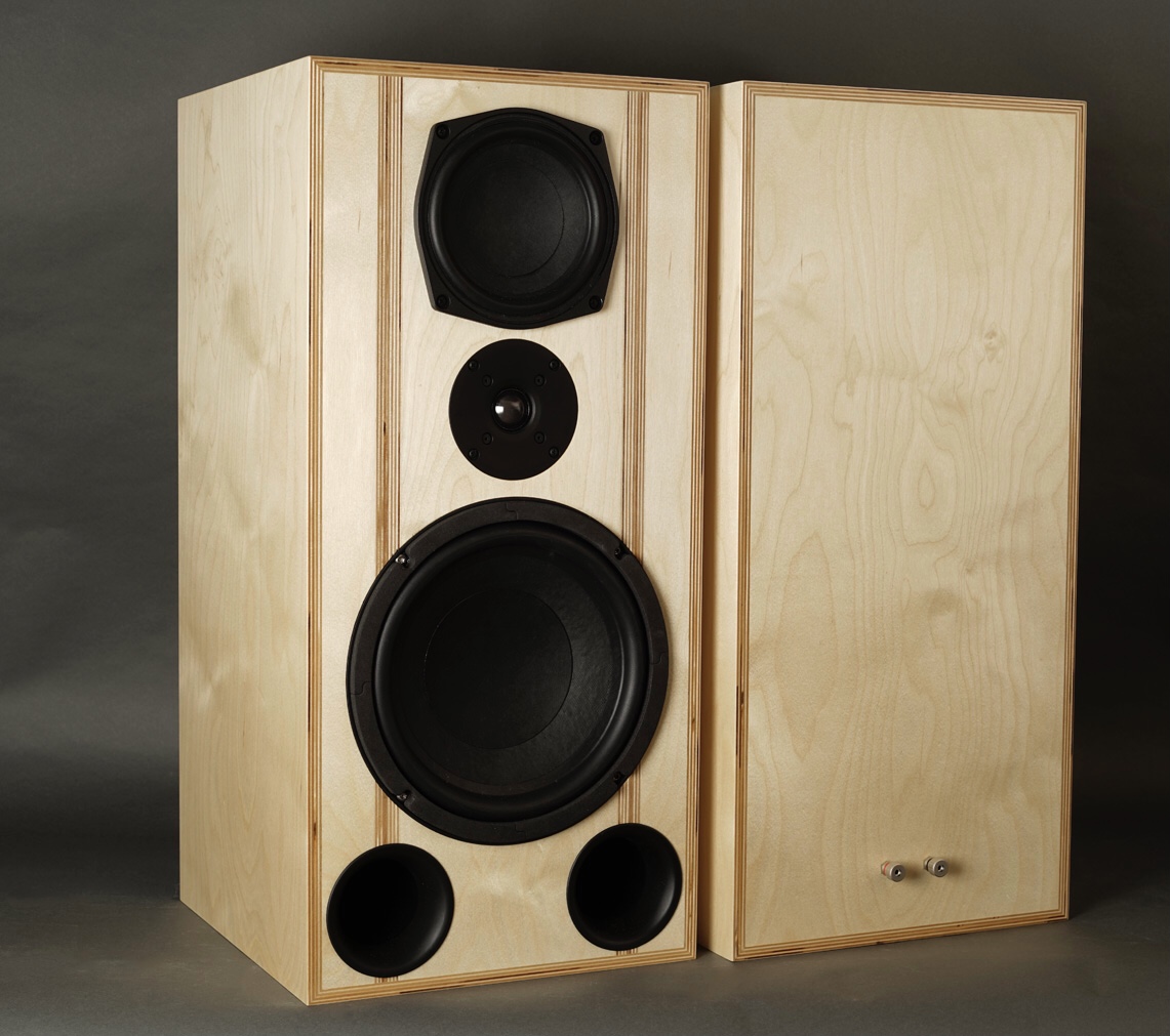

A couple more thoughts were coming to mind as I was looking for other use cases on the web.
One was baffle edge diffraction, the concept of the supra baffle (?) as a means to improve the imaging performance of the stereo pair. I can imagine there being a strong connection between edge diffraction and the quality of imaging. There isn’t an obvious way to add such a thing to my PMC but it maybe an interesting experiment. And I’ve seen others use sound absorbing felt on the front baffle as another method to supress edge diffraction artifacts. As my PMC has a speaker grill this might be an option although the Fostex itself seems to require a fair bit of space in front of it.
Another idea was that of assuming the existing PMC tweeter play the role of super tweeter to the Fostex which adopts the role of a mid. Perhaps a simple cap only on the tweeter to bring it in at around 10kHz. Then the Fostex is put into it’s own box and located on top of the PMC to make a woofer-tweeter-mid. For c to c spacing the XO point for the woofer-Fostex would want pushing down further. This configuration is not something I’ve yet seen on a FAST but I have seen it on one of Troel’s 3-ways.
