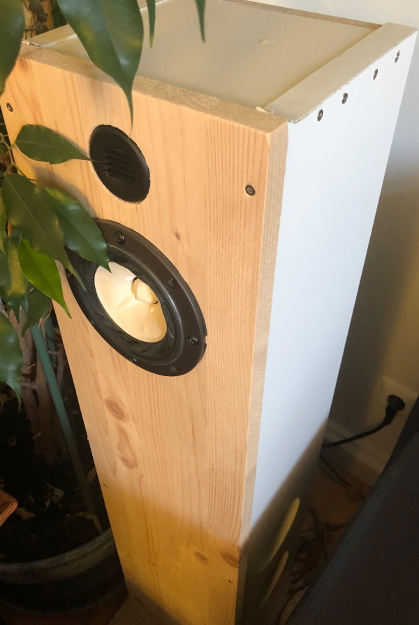

Fully agree. Actually, I wanted to post my experiments a little later but it is too tempting, to find out what you guys think.... These speakers are not finalized yet, I want to make them fully active, so far running with external power amp while that project is ongoing.
See the picture attached. This essentially is a IKEA CD tower cut in half, with little compartments on the top for the FE108Sigma, volume ~2liters since that was natural given the position of the little holes for the shelves 😀
I did add an air motion transformer as supertweeter, but undecided as of yet whether I want it or not. The "original" highs of the Fostex I don't like too much, want to add a little sparkle. And for the bass, I bought 4 very cheap woofers per side (€4 each) and will add motion control to them. Crossover frequency for the whole thing is 200Hz.
So, the FE108 is doing pretty much all the hard work, I did put a shelving filter though since the upper mids are really too strong, with the filter kicking in at 3kHz, with 6dB damping. They only came alive after 50hrs or so of burn-in, lots of detail and all the precise imaging you could want. Sweet, if you ask me.....

this looks very interesting, I'd like to hear more about your experience when you have listened to this.

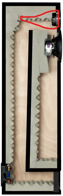

I have a commercial floorstanding two way speaker and I could be tempted to rip out the metal dome tweeters and put in the Fostex and a new cross-over. My speaker was very expensive, a PMC, but it's value today is limited given it's age (20 yrs) and the tweeters have to be upgraded anyhow.
In this way, it becomes an interesting choice for me,
Either: replace the tweeters for modern units and retain a 2-way with XO around 2.5kHz
Or: turn it into a FAST where the XO could be low-order but I don't know where to put it other than it should not be too low or the Fostex will run out of excursion and a passive XO will also get too challenging.
I suspect Dave (p10) could suggest an XO based on centre-to-centre spacing of the Fostex vs the 6" mid-woofer ?

in my case, the PMC cabinet is a 'done deal' and I don't want to create a big pipe sticking out the back so I may find this is not the best option compared with a simple tweeter upgrade. I could possibly squeeze a pyramidal cover over the back of the driver to enclose it and separate it from the main transmission line that the mid-woofer lives inside.
Edit: actually, looking at the cut-out drawing a pipe to the back is feasible. It would be irreversible butchery though.
I like midTLs, but in your case a trip down to the dollar store and pick out a suitable size bowl to use as a sealed box. somewhere between 1.5-2 litres.
Should be small enuff to be insignificant to the fold in the line.
