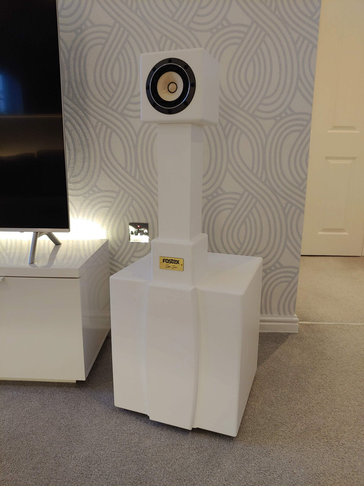

Picked up mine new early this year so good timing, from the german place mentioned above. Wasn't overly impressed to start with but after some break in and amp adjustments (turned out it had pre-saved EQ from the previous owner 🤦♂️) they are now sounding glorious in some Super swans.
May well need to sell them to make room for new arrivals but it seems a very limited market for such things in the UK.
