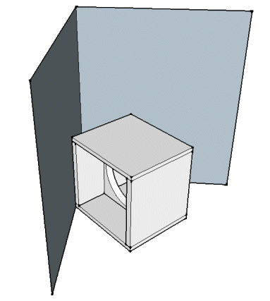

Well I've decided to get on board and try out the Alpha's in the H-frame to augment my BIB's instead of trying the 108's on OB for now.. Then if all works out well, I'll cut off the added length that I used to invert the BIB's, flip them to fire upward and stack them atop the H-Frames..
Will the H-Frames with the Alphas work okay positioned right in the room corners, angled out towards the listening position? I'll be using them as low end fill powered by a Reckhorn sub amp crossed under 100hz I imagine, and will keep my 108's as before running unfiltered in the BIB's.. The room I'm using now, there is no option to have the H-Frames well out from any room boundaries ... Wondering if it matters so much if using just for low end etc or if maybe the Betas or other may be better?
Can't seem to find the H-Frame dims again where I found them before.. Assuming 3/4inch material external dims = 17''w x 17''h x 15.75''d ? Driver baffle centered inside H-frame, with 7.5'' of cab in front of driver baffle and 7.5'' behind?
Thanks Jim.. I guess I will just experiment with placement/design etc, as they will be well within the min 2' distance but not right up against the walls, although still quite close though.. At least the expense to find out is not so much as to thwart the idea to try, so that's all good to have a bit of fun etc...
Thanks Jim.. I guess I will just experiment with placement/design etc, as they will be well within the min 2' distance but not right up against the walls, although still quite close though...
Did you take a look at the corner dipole on Linkwitz' site? Sadly Larry Selmers own site on geocities doesn't exist any longer. He suggested to rotate the H frame 90° when putting it into the corner. Very clever.

I tried to make a drawing but cannot get it to attach.. The Bass H-Frames would be angled towards the listening position close in the room corners and would still have lots of room for the back wave to escape .. Perhaps that bit of added pressure on the driver may take it lower ?? not sure...

Hi DaveCan,
The internal dims MJK uses are 16" height x 16" width x 7.5" depth (on each side of the woofer).
He chooses 7.5" because that will have a quarterwave resonance of 262Hz, and unlike his MLTL's, in this case he basically "throws away" the QW resonance by crossing over around 200Hz. So the dims aren't carved in stone -- you could tweak away based on your situation if you wanted.
This is on pg. 3 of his "Comparison of the Bass Performance of Passive Open Baffle, U Frame, and H Frame Speakers".under "Geometry Definitions".

This is the way Larry Selmer would place a H frame in an edge:
