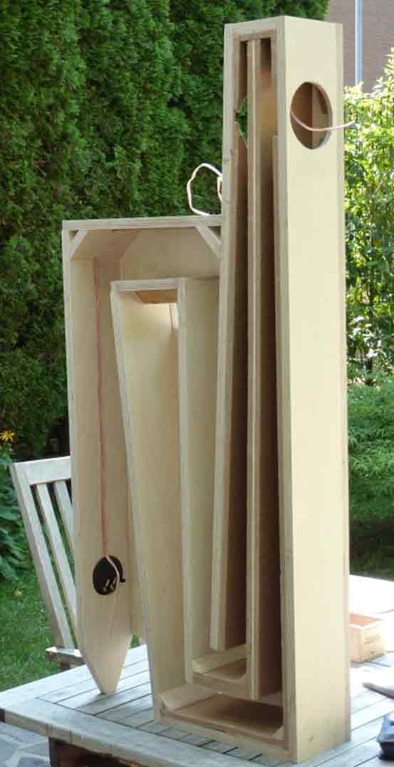

Hallo Jockel
may be my TROMBONE and the 100mm wide KORNETT
would be a solution, specially by better soundstage as an direct single driver horn,
more SPL by double driver configuration, Bass down 35 Hz, and superb impedanz
better as any single diver horn, look my HP.
With feedback and measurement.

Sorry, Trombone is a bit tooo big enclosure for my taste.
Maybe, I didn't explain my purpose in the right way.
I know, Needle and TABAQ are both good enclosures for the W3-315E concerning overall performance.
What I would like to improve with a horn cabinet is the bass efficency (not the depth in tuning frequency). What disturbs me is the fact that the total volume is not very high with my TQWT enclosures.
A Horn cabinet should be much better choice for total output volume.
I'd really like to get an calculation for one of the Fostex enclosure recommondations.
