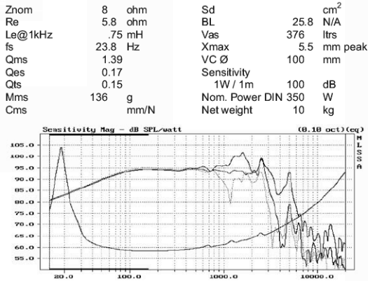

I can't give you any specific recommendations for a driver. I would just point out that the Audax rates the PR380M2 as 100 dB @ 1W/1M and it is really 95 dB.
When you look for a replacement, you might want to keep that in mind. 🙂
I suspect you are familiar with Audax's chart for this driver, but I'll put up the graphic just for the sake of completeness.
Good luck!

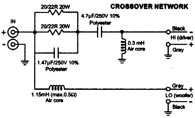

OK guys, this is an emergency!

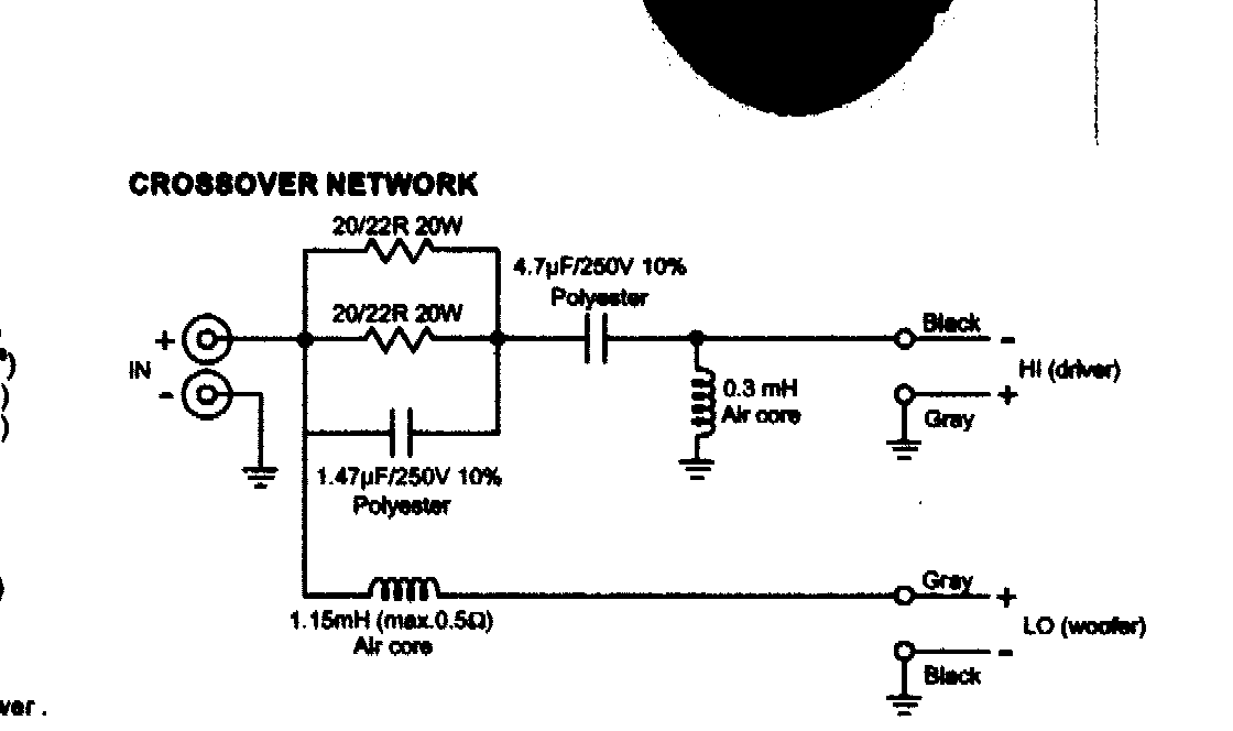

Here is a crossover that Selenium uses for their coax speaker that has (duh!) a D205T1 horn driver inside a 15" woofer
I am buying the horn driver and a horn separately to use with my 15" Selenium driver.
Since the horn driver is the same and the woofer is similar to the coax, I feel that this will be acceptable for use to convert my bass boxes to PA duty instead of HI FI use. This is for the fast approaching party mentioned above and I need to order parts ASAP!!!!!!!! So please help me get this thing together so I have a happy birthday
The 1.15 mH inductor on the woofer makes sense in that it will flatten out a rising rate starting around 1000 hz. It also makes sense that there is no further low pass filter because at about 3000 hz the response curve just drops like a cliff, so I think it can be run without further filtering. Actually the woofer I'm using even starts dropping sooner and has less rising rate so could I maybe eliminate this altogether?
Now, on to the horn tweeter network. The 4.7 uF cap makes sense and the 0.3 mH inductor makes sense, but the part with the 1.47 uF cap and 2 resistors in parallel has me confused.
What does the 20/22R resistor designation mean? Why is the cap in parallel with them? I assume the resistors are reducing signal to the tweeter so can I replace them with an 8 ohm L-pad?
If so do I leave the cap in paralel? or just add the value to the 4.7 cap?
Help me and save my party!!!please!!

Yeah, I agree with Dave, it is for compensating for a fall off in the tweeters response at higher frequencies.
You could try connecting the XO as is, and if that sounds too bright, bypass the contour element. Bypassing will probably increase overall treble level, depending on the sensitivity of the new HF driver, so you may then need to attenuate it with a resistor.

Boy, great response! Thanks Dave as always for your graphic clean-up and thanks to you and Pinkmouse for the advice (and agreement?!!) what is this board coming to!?
That makes sense about the relative increase of the top end. It also explains how to use those pro drivers that roll off a lot at the top.
1. Since the crossover is for this specific driver I'll bet it works out pretty well, but I'm using a horn lense and the coax uses the woofer cone only so I suspect the horn has better high end?
Maybe it doesn't need the boost. Man I realize I'm reallly guessing here!!
2. About those resistors: are they a spec of 20 ohm to 22 ohm resistors ? or something else? I'd hate to be off by an order of magnitude!! DO people ever run the bass drivers full range and let the driver roll itself off? (I know we do this in Hi Fi sometimes)

Variac said:2. About those resistors: are they a spec of 20 ohm to 22 ohm resistors ? or something else? I'd hate to be off by an order of magnitude!! DO people ever run the bass drivers full range and let the driver roll itself off?
what is required in the end is an r of 10 to 11 ohms that handles 40 W. Yes i'm sure some will let the bass drivers roll offf naturally.
