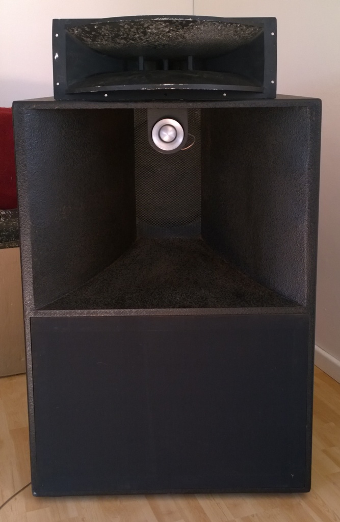

Every Lab amp I've come across in SA has come out of a Cinema. They were driving Fostex equipped cabinets similar to Altec VOTT's and usualy some EV subs.
I use a 600 to drive Tannoy System 15 drivers in custom enclosures in my lounge.
I use a 2 x 300's and a 600 to drive a Tannoy System 15's centre and 2 x System 15 with additional JBL bass driver.
Another 600 runs a pair of double EV 18 - all in the home cinema system...

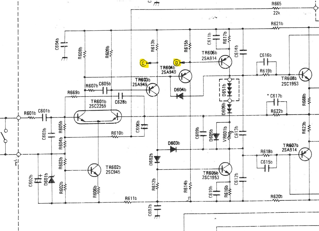

i have recently been given a 600 .. but it has a quickly developed a fault on the right chan
in the last few days it started to make random scratch noises on the right chan ,, even with no source connected and the volume completely down
then last night the clip ( overload ) light on right chan came on and quite a bit of distortion ensued on that chan ..
any clues,,, i've popped the lid off and i cant see anything obviously blown , no exploded caps ... no burn marks anywhere ... it looks like a really solid build ..
i would very much like to get this working again asap
Well since 2006 when I first asked about these amps, I've had probably 20 of them through my hands! They are great amps and tend to be pretty reliable.
I've recapped, replaced output relays and had the occasional odd little issue.
The clip/overload circuit monitors the points C and D in the attached schematic(and A and B in the other channel). If your problem is only one channel and happens with the attenuator down, the cause is to the left of C and D...
I have had the dual input transistor give trouble before and would probably also change the couple of electrolytics in the area...
Channel 1 schematic has reference voltages to check...
