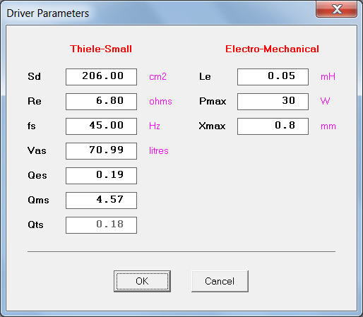

I've realised the Fostex data sheet does not include some values that Hornresp asks for. The unknowns are as follows:
Mms = Mmd + ‘Air Load’ Is Air load negligible?
Rms = (2Pi x Fs x Mms)/Qms
Where Fs = 45Hz, Mms = 12.2g, Qms = 4.57
Therefore,
Rms = 754.807 Hz.g Correct?
Any help on this would be greatly appreciated!

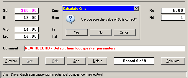

Hi, as you enter the specs you have, HR can calculate the missing ones 😉 For eg,

Hi Craig,
No. For your Fostex driver, 'air load' = 3.21 grams.
Therefore,
Not quite 🙂.
Rms = 1 / (2 * Pi * fs * Cms * Qms)
Rms = 1 / (2 * Pi * 45 * 1.17 * 10 ^ -3 * 4.57)
Rms = 0.66 newton.sec/m
To determine the electro-mechanical equivalents for the given Fostex Thiele-Small driver parameters, use either the technique suggested by Zero D to calculate just the individual parameter values you require, or alternatively, double-click on the Sd input box in Edit mode to enter all the Thiele-Small values at once (see attachment).
Kind regards,
David
