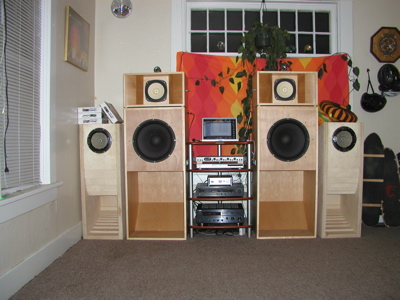

acaudio said:Hi all,
I´m listening the FE206E in my horns powered by Firstwatt F1 clone (Nelson Pass). The sound is absolutely marvelous with a deep bass.
A few pics about building under: http://www.acaudio.de/html/horn.html
Best Regards,
Adam

acaudio, do have any measurements because
your horn is BL and very short, my experience
shows than no bass below 100 Hz.
or is your horn more a BR with horn "Kehle"
your press chamber is so large.
my best solution is the SAXOPHON:
http://www.hm-moreart.de/104.htm
more Info klick the red arrow.

It's a big vent reflex, as GM calls them -large filter chamber, long, flared reflex vent (i.e. a ported box coupled to a short horn). They can work very well, if your technical baseline comparison is with a reflex, not a horn, enclosure, and extension is usually a strong point.
