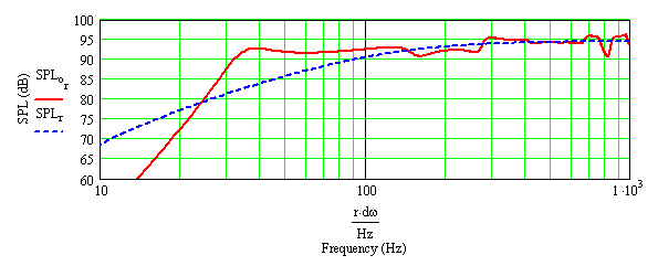

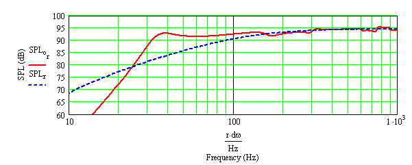

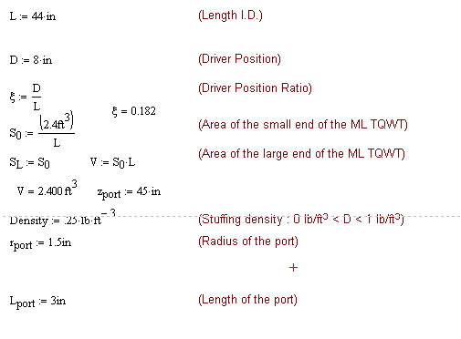

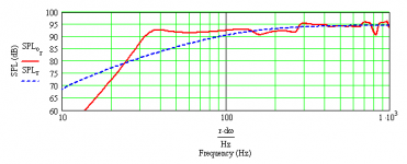

Assuming the inside height dimension is 22", you could put partitions in the box to turn it into a 44" tube. Add a 4" diameter port 6" long at the end, and you have a mass loaded transmission line. But it would have a 6 db shelf at about 300 Hz. To kill that, add 8 ohms series resistance. Use some polly fill stuffing, but not too close to the port. I did a quicky using Martin's worksheet. You can probably do better by tweeking around with it. See chart.
Dave Jones said:Check this one out.
Zport should be 41 inches. Note, this has 8 ohms series resistance added.

About the time you decide to add that much resistance, you
might as well go to higher source Z and get the bottom end
out of the existing sealed box.
Dave Jones said:To kill that, add 8 ohms series resistance.
