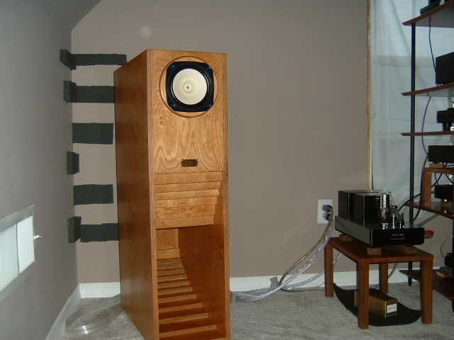

FE 166ES-R finished project
I've actually had my horns completed for a few months now but have not posted since there was alot of break-in time needed for them to sound good. I moved the cabinets back into the corners as seen in the photo. I found that the best combo of bass performance and midrange smoothness was obtained with this placement in my room, which is 24 deep and 13.5 wide with sloping ceiling and 8.5 ft. center. The speakers need at least 300 hours break in and they are smoothing out even after 400 hours. I drive them with 8 watts of 300B power ( amps are to the right of speaker) The cabinets are made entirely out of baltic birch. The magnet assembly is wrapped in felt and the compression chamber lined on the back and bottom with 1/8 inch thick medium density 100% wool felt. The speaker is wired to WBT posts with 6 starnds of 18 gauge long crystal silver wire with teflon loose insulation. All in all they are very musical though a bit peaky at around 750Hz in my room. I treated the corners behind the speakers with a 1 inch foam placed in strips a seen in the photo.
Bass smoothes out and I think the mids sre less beamy on some recordings. Hope the picture loads.

Fostex 166ES-R
I was hoping to get some more comments and finished projects after posting my finished Jpeg. Here are my impressions after 500hours break-in As expected the highs and bass have both extended and smoothed out considerably. Moving the speakers into the corners has also paid big dividens in my 13x22 room. I am really enjoying my music through these horns. They have a purity of tone and a dynamic force that is utterly beautiful. Here is a new link for a look closer look at the speakers and my system .

Notes on tweaking and sound
Two critical parts of getting this speaker settled -
Placement
Not much output on sides and back - cabinets are very thick and heavy and the layers of the plywood and internal baffles tends to dampen resonances
Use a laser level to adjust toe-in so that the centerlines cross in front of the listener...
Compression Chamber Tweakings
Initially played them empty - very lively, poppy sound - extremely good transients for drums, etc. But some male vocals exhibit quite a resonance - almost sounds like a 'hooting' at certain frequencies
With the doubled front baffle in my cabinet there is a discrepancy between the plan volume and the actual volume of the compression chamber - it is enlarged by the diameter of the hole in the original front baffle (oversized to provide clearance to the sides of the driver) and the thickness of the plywood (pi*r^2*h=658cc) - less the volume of the added vertical brace (also different from the Fostex plan: 19mm*82mm*120mm=187cc). To make up the difference I caulked landscaping egg rock to the bottom of the compression chamber - calculating the volume by adding the rock to a partially filled measuring cup until the water level rose 470cc; or close enough. Adjusting the volume of the compression chamber affects the cut-off of the horn loading - a smaller box lowers the cut-off frequency. So you can also try adding acousta-stuf to 'enlarge' the box. After adding the egg rock and wrapping the driver magnet with felt the speaker was still pretty peaky at some frequencies. With music this is harder to detect than you would think - only on familiar pieces could I hear distortion as the emphasis of the notes was different due to the resonances. Not an unpleasant effect, but not entirely accurate either.
I ordered about ten square feet of 3/16" thick adhesive wool felt from MacMaster-Carr and proceeded to try combinations of layers in the compression chamber of the cabinets. You really cannot rush this process, since different styles of music behave quite differently and it takes time to listen for the changes across various examples, and to live with the sound at a variety of volumes, from a variety of sources (LP, CD, SACD, XM Satellite, FM). I found a hex bit that matched the stainless mounting bolts (button head cap screws) so I could use the portable drill to remove and re-install the drivers more quickly.
I also tried those Fostex HP devices... these are the plastic 'flower' shaped parts that Fostex sells to reduce standing resonances in cabinets. They come in the oddball number of five to a package, along with an dense explanation with frequency response graphs on the package (urk, in Japanese), with mounting screws and a shallow screwdriver. I initially installed one of these in each horn in the mouth up the back, out of sight. Frankly, I couldn't hear much the difference and now I had three units remaining... Next, Steve Killian and I tried one in the first segment of the horn, near the back panel - this was audible and a good improvement in overall intelligibility. I guess I need to buy another package of these if I want to experiment further. Yow, another $45, I need to think on this.
More felt was added over listening sessions until the resonances were mostly controlled but the sound was still pretty lively. The Bass was a little less defined, but the vocals are gripping.
Somewhere after a week or so of living with the new speakers, my curiousity got the better of me and I inserted the Chesky audio system tweaking CD and sat down with my Radio Shack sound level meter to see what the bass response looked like. Big mistake. It's a bit woogly in the lower midrange and high bass (300Hz to 120Hz) varying plus or minus 8 dB. From 120Hz on down is even wilder with significant dropout below 80Hz and almost nothing below 60Hz. Of course, this is mainly due to horrible room modes (1930's bungalow living room with plaster walls, 5 doors and a fireplace) but it sent me into a depression for a few days - how could I have thought that the bass was acceptable?
At that point I started moving the speakers around and trying alternate connections to the floor. I built the support legs with threaded inserts for 3/8-16 hardware, five points per cabinet. The initial installation used DIY shallow brass cones into plastic feet (to protect the hardwood floors in the LR). Replacing them with heavy steel equipment feet with rubber pads deepened the bass audibly. Raising them up to about 1.5 inches off the floor helped a lot!

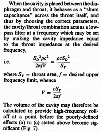

Originally posted by pRC Adjusting the volume of the compression chamber affects the cut-off of the horn loading - a smaller box lowers the cut-off frequency
Haven't you got that backwards? Compression chamber size is inversly proportional to the cutoff frequency?
dave

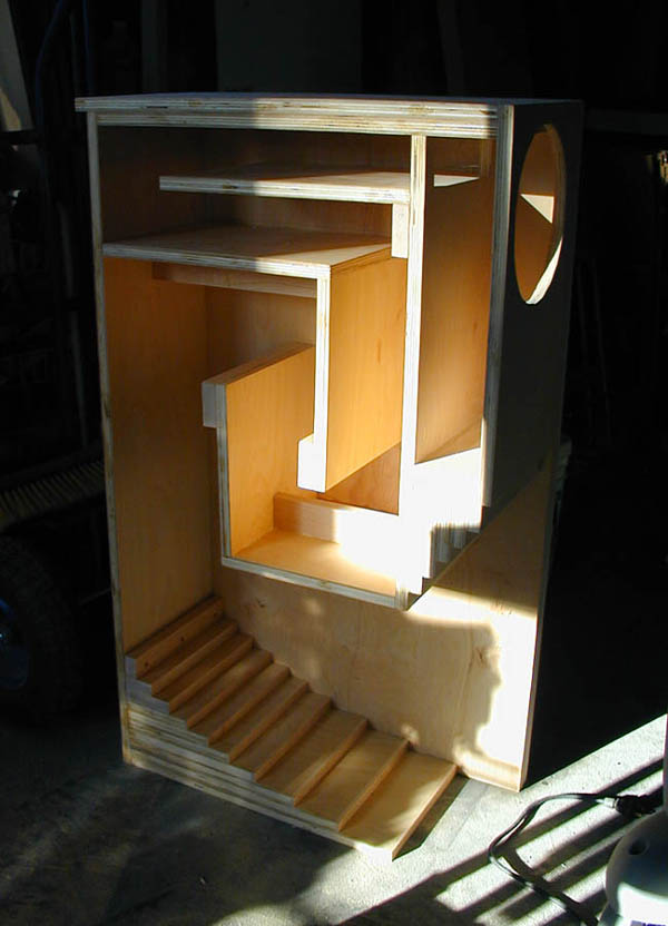

pRC,
Beautiful job on those Fostex speaker cabinets! What is the big coaxial(?) setup to the left in the photo? How do they sound?

Thanks for the replies - I thought this thread was getting pretty old but I guess some folks are still interested...
Planet10 - I've read contradictory theories, and heck I guess I can't know for sure without building a few boxes and measuring the results. Your passage seems to relate to the high-pass filter function of the compression chamber (at least, that's what I *think* I'm reading into it) but some other horn design opinions seem to be pointing to the low-pass behaviors, and that is what I was attempting to repeat.
Frankly, I wish the literature and web writings were more clear on this, and I'm probably confusing people as well, so I'll just shut up now!
The big coax speakers are my version of the Adire HE12.1 - see my page here:
http://cognitivevent.com/av_he12.html
After living with these for a while I became dissatisfied with the sound - the crossover region sounds confused unless you crank them louder than I normally am comfortable listening. On the other hand, they would make great club speakers - when cranked they really make the whole house bounce and are a lot of fun. Rolling Stones, Elvis Costello, live Blues all sound great at louder volumes - probably because these are made with PA speaker components.
I can't decide what to do with them - The cabinets are extremely (obsessively, compulsively) well built and the baffles are removable so they could be re-purposed for another set up (5.1 cubic feet volume works OK with some other woofers, maybe a bass box for an Azura horn system?). For now they are sitting under a blanket in the shop - maybe I should just mount the crossovers insides the cabinets and sell them locally. Anybody want to drive to Charlotte and pick them up?
Anyway, the Nagaoka FE166ES-R horns plainly work better on most of the music I listen to, and are a lot more fun at lower volumes. The Adires really only worked well for a narrow range of music, played loudly.
