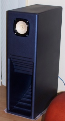

So I went out and bought a Wagner 640 electric spray gun (no laughs please), procedure: -
1. All MDF edges firstly primed with two coat 50/50 glue/water to seal edges
2. One coat MDF primer all over with a brush, stuff I bought was too thick to spray.
3. Sand down primer
4. Two spray coats acrylic primer/sealer undercoat, each coat sanded to form base coat for finish
5. Three (just) coats sprayed Dulux Glimmer “Night Stone” first coat sanded, second wire wooled
Lessons
1. Serious spaying needs serious equipment!
2. I probably should have sanded the MDF primer coat down a lot more but the two build coats finally hid the imperfections here!
3. The Wagner just doesn’t produce a fine enough spray for this sork of work.
For this one off test it was just about acceptable but I wouldn’t use it if these were to become my main room cabinets. I would also guess it’d be useless for auto/2 pak paints.
I tried the “Glimmer” effect to see if it’d hide slight edge flaws which I knew were there – it didn’t. As everyone says – sand – sand – sand, oh and sand.
I’m being critical of myself here but overall for a beginner the final finish is quite acceptable and if I’d have worked the edges a bit more would be pretty good but only because of the “special effect” paint.

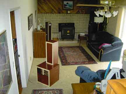

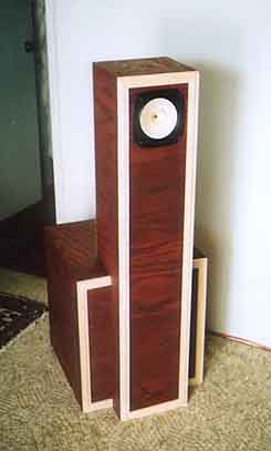

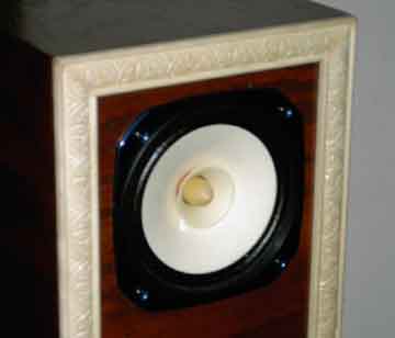

I lined the entire length of my D-168 with small "rainbow" river rock on two adjacent sides and the bottom. I only compensated for the volume of the rock on the back of panel 9 and the CC because I wasn't planning on lining the rest of the horn. However, when I yelled through the top of the bare box, it boomed and echoed like crazy. Since I have a dead room, I didn't want to use sound absorbing material. So I decided to line the rest of the horn with river rock even though I didn't account for the extra volume of the rock. The lining mellowed out the horn but it still echoes slightly when I yell through it. A little sound absorbing material (fiberglass is all that I had on hand) on the back panel of the mouth kills most of the echo. By the way, the rock added about 65 pounds to the weight of the cabinet! The rock also deadened the plywood panels. For the Swan, I think this is a good thing because the panels vibrate quite a bit and some of them are dissonant to each other. As you can see in this photo, I filled in the "vent" with urethane foam because it rang like crazy at the resonant frequency of the vent. I didn't think that this was a good thing. But, I'm a novice so what do I know
I didn't like the looks of the D-168 so I made some slight design changes. As previously mentioned, I filled in the vent with urethane foam. So, I didn't cut a vent opening on the outside of the cabinet. I also pushed the CC all the way forward and created a false front and sides. The CC is expanded and lined with river rock. The throat is lined with river rock on two adjacent sides. I only partially compensated for the volume of the rock in the throat because I didn't compensate for the rock in the rest of the horn. Here's a photo of my nearly completed cabinet. All I need to do is to add a final finish. But, I probably won't do that until I build the other one.
So, how does it sound? Well, I've only built one so far. So I'll defer final judgment until I finish the other one. It sounds very promising, though. It is much more open than the small BR in the other channel. Plus the shrillness appears to be gone. It still might be a bit bright but I can work with that. And there's plenty of clean, tight bass. I can hardly wait to build the other one!

Well, My cabinet weighs about 125 pounds (57 kg). So the rock doubled the weight of my plywood cabinet. Maybe your MDF is actually made out of rock!😀

greenie512 said:Ray, forgot to ask - where did the idea of lining cabinet in rock come from?
From one of Blackie's (noisenyc) threads. (The "fostex bk-16" thread.) Thanks Blackie!
I know you've go lots of non-uniform curved edges now but doesn't this make for a hard/reflective and non-sound absorbant enviroment????
Yep. That's the whole idea. It doesn't make a whole bunch of sense to me to put sound dampening material into a horn -- the idea of a horn is to amplify the sound. But, something needs to be done to tame the frequency spikes caused by the 90 degree bends. Most Swan builders use a sound absorbing material. Maybe that's the best approach. I'm a beginner so I just don't know. But, I don't think that the frequency spikes need to be absorbed -- just redirected. The Fostex design uses the stepped mouth to tame the spikes. But, according to my experience with river rock, it's not enough to just address the mouth. However, I also found that the river rock doesn't kill the main resonant frequency resulting from the total length of the horn. So, I also had to use a little sound absorbing material on the mouth too. And I may still have some spikes to tame. I'll find out more when I build the other cabinet.
Interesting though - I suppose you used construction glue to fix them all - you must be a very patient man - one at a time. ?
Nope. I used epoxy -- almost ¾ gallon. (3 liters.) But it was still time consuming putting all those wretched little rocks in epoxy.
-Rich

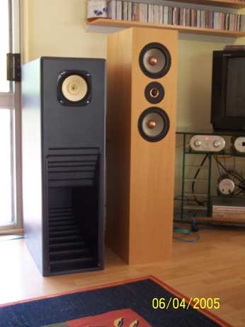

166ES-R v Thors
Tyimo, Firstly - build ther BLH's they are good speakers.
I was trying to avoid a direct A/B comparison between the BHL and TL’s as they are such different beasts. But you’ve forced my hand – so I’ve rolled out the Thors and done so.
Same CD/pre amp and power amp and cables – 166es-r connected with cat 5e and Thors with QED Profile 4 cable, personal opinions …
1. Human voice – Fostex by a mile. I though the Thors were good on voice but the 166’s are fantastic – natural and true. If you main concern is voice use these speakers, wonderful.
2. Instruments – Thors for separation and clarity, with these speakers you can clearly hear each instrument separately and pick up the finer detail in the recording. The Fostex just can not do this due to the single driver needing to cover all frequencies. This isn’t the best analogy but it’s like listening to a radio (okay, I’ve never heard a radio sound this good). The musicality of the Fostex is very good it’s just you know there’s more detail there that isn’t coming through.
3. Presentation – I’m surprised at the quality of the Fostex’s out of the box sound, producing an excellent sound stage with depth of field and width (Thors probably just as good?).
4. Listen ability?? – Well I have been listening to the 166’s for hours on end and they are certainly easy on the ear but that may be due to 2 above?
Final thoughts:
1. You get what you pay for in this world (capitalist pig!) and the Thor’s do cost 4 times the 166’s setup – are they 4 times better – well of course not. This hobby like most has a law of diminishing returns. But I still think the Thors were money well spent.
2. I can certainly see why people like these full range units and I’m very tempted to buy a valve amp to join the club (can not afford it!)
3. I wonder if a “super tweeter” would help with a bit of instrument definition on the Fostex?
4. If I won the lottery I’d build 4 sound rooms and one would have a full valve system with full range BLH speakers
If I could integrate the Fostex into the Thors for the superb voice reproduction I’d be a very happy man.
