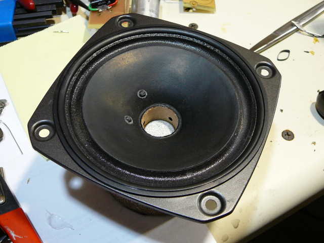

I done it!!!
...and lived to tell the tale!
Having the luxury of a fried driver to practice on gave me the courage to 'butcher' my 126's.
There was some glue on the inside of the VC tube, but cutting approx 1/8" off the end of the tube removed this.
I initially left the 'nibs' as suggested earlier, but then I experimented with the 'dead' driver a little further, and managed to remove these completely without hitting wire, so crossed my fingers and did the same on my 'best' drivers, with no ill-effects.
The result? Much more refined and detailed treble (albeit a little less of it).
A mod worth doing IMHO.

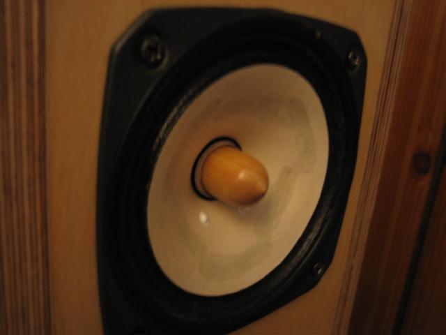

FE-126E Phase plug
The curiosity got the better of me today, and I put knife to dustcap on a pair of FE-126e in my Frugel-horns.
I cut around the dustcap about 2mm up (that's somewhere between 1/16" and 1/8") and trimmed to the edge of the voicecoil former.
There was some black glue most of the way around the inside of the voicecoil former. I cut this away with a sharp pointed surgical knife. Sealed the fibres around the edge with ModPodge to finish the job.
Until I get in touch with a guy in Canada to send me a couple of cedar tree phase plugs, I made my own temporary ones from 3/4" steel pipe and plastic caps 😀

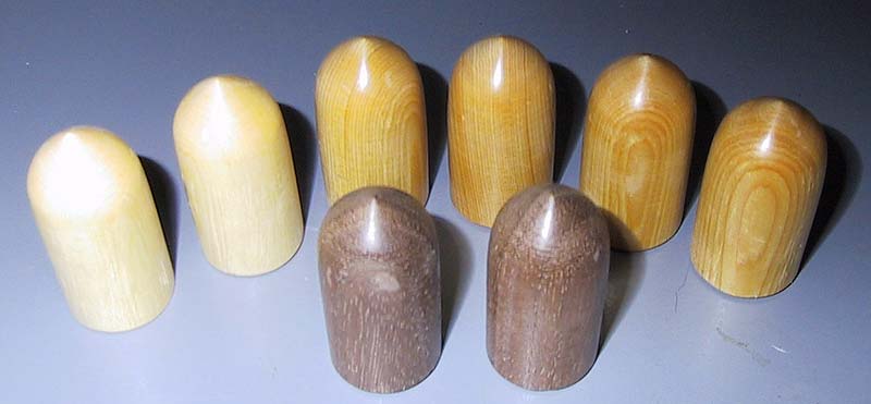

At the rate you guys are going, Scott is going to have to make some more of these for me.
The original FE127 proto plugs turned out to be perfect for the FE108eS, so we made some up for 108s, now that you guys have figured out how to successfully operate on 126s & 127s they can be put to there original purpose.
Yellow Cedar (light), yellow cedar (dark) & 1 set walnut. George gets 1st pick -- althou with the black drivers he might want a black set.
dave

I didn't know you did black.
The black would work best with the black cone treatment. Could you send me...umm...what color was that now?

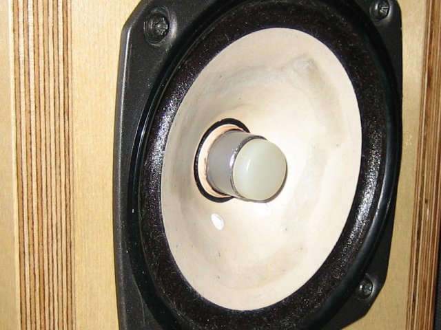

Phase plug for FE126e
I installed the long (108eS) version of Planet-10's phase plug on my FE126E drivers.
I think however that the shorter FE103 plug would be better suited for the FE126e. The long version protrudes about 1/8" in front of the speaker surrounds.
It could be that the FE126E and FE127E are slightly different since the 127 is shielded.
SB.
SB.
