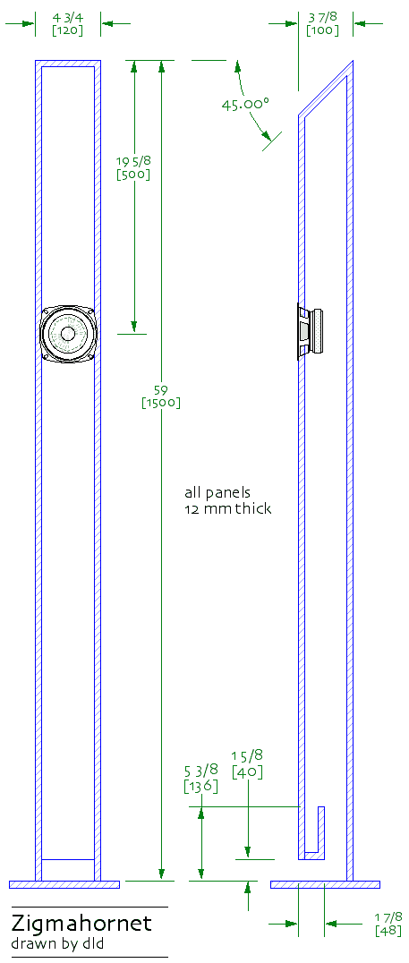

Wow!! Compared to the Swan, the Zigmahornet looks like the little ugly duck.. But I must admit that my skills are more in line with the Zigmas.. an easy tuned pipe to build.
And how about the Swans? real bass from a 4" driver? I mean, is all this complexity well deserved? or a simpler design with a sub would do? just asking.
Again I've never heard the Zigmahornet, but according to my brother the difference in bass is not subtle. The swans can certainly hold their own in the bottom end. Also building the swans does not take a lot of skill, just time. There are no fancy cuts to make, all right angles.

Well, I take your word. But let's say that the plan "seems" rather complex to translate in real world 3D in my mind..
I'll have a further look to it. I might try it just for fun at some point. I might well build both designs, just to explore and to learn.

Cheers for sticking up the first ever decent Zigmahornet plans on the net by the way Dave -I too was thinking about giving these a whirl & now I have no reason not to! It's much appreciated.
my pleasure.

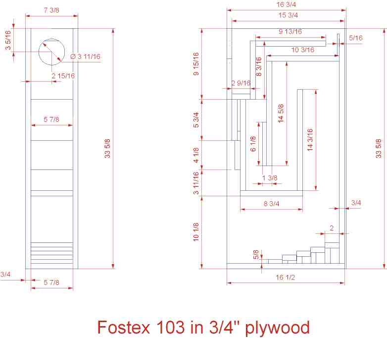

Inside or Outside dimension
Hi guys, are those plans the inside dimensions? I am in the process of building them.
Thank you!
Thank you!

- Full Range
- fostex 103 cabinet in 3/4" plywood
