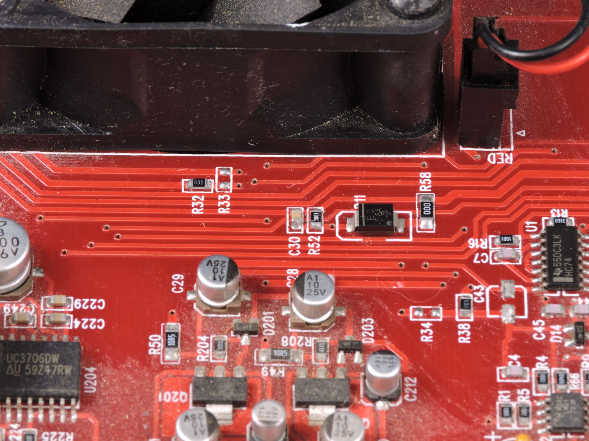

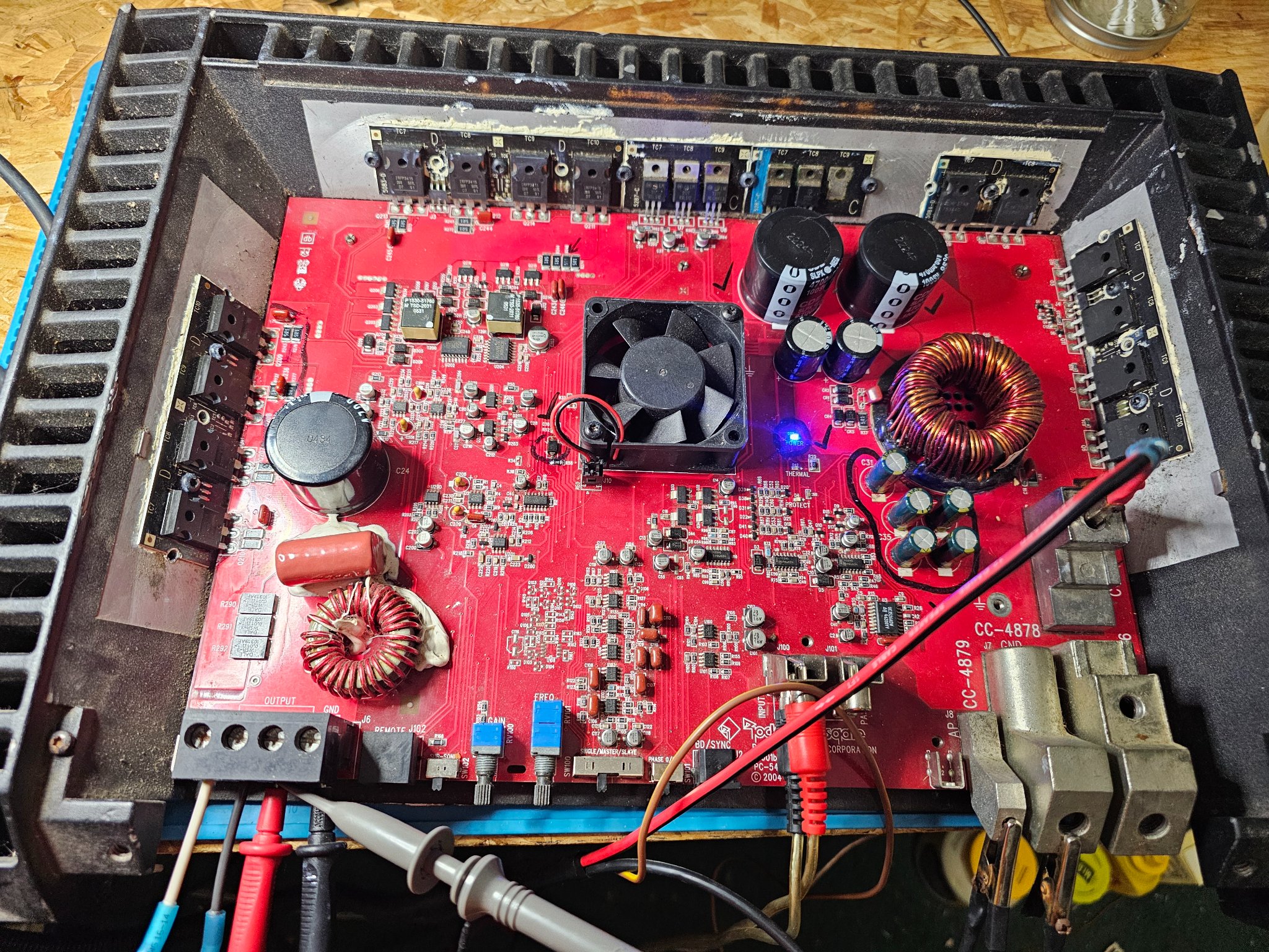

Does anyone know a good part number for D11? It's marked 5A but when I search it I get mixed results. I've already replaced:
Q207-Q210 (IRFP3415) Shorted
C31,C33,C35,C36,39 (330uF 63v) Open
C23,C25 (4700uF 80v) Out of tolerance
D23 (Blue LED) Open
While cleaning up from all that I noticed D11.

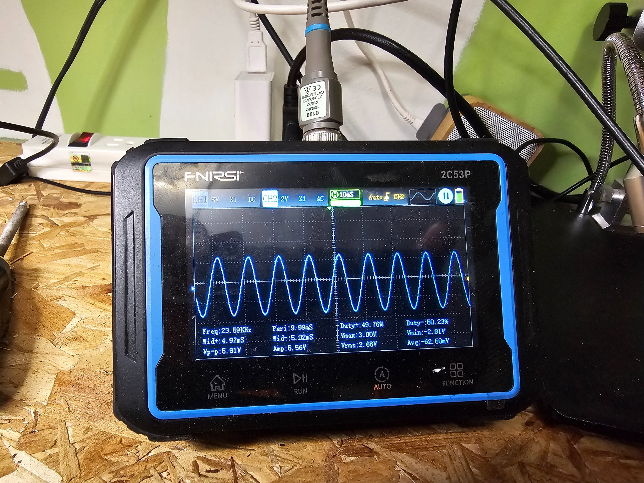

On the bench it appears to be okay but when I turn it up it starts turning on and off. I think I'm just not giving it enough power. I'm running 100hz with no clipping @ 4ohm and am getting a clean wave producing ~212w. The voltage meter on the power supply is out of calibration, it is producing 13.94v.

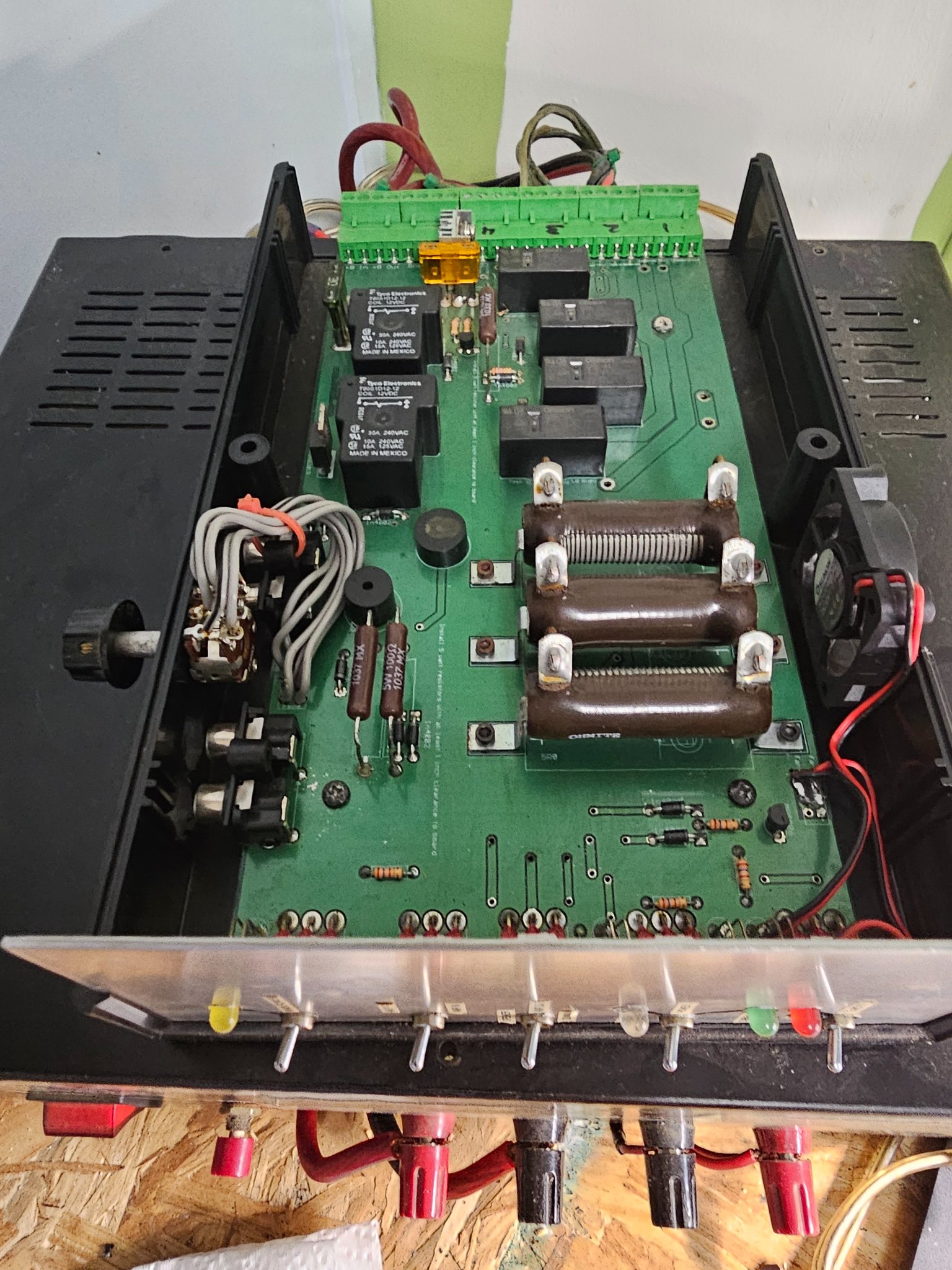

For short term testing, a battery or even a jumper pack would help. For long term testing, you need more supply.
I forgot to mention that I ran it like that for ~20mins straight until my power supply over heated.
I really appreciate you Perry. I bought this one broken on ebay about 15yrs ago and I was intimidated for over a decade to touch it, but now I think it's going to work.
No. I just have the 40a p/s with your switch box and just added an old lawnmower battery so I don't have to redo all my radio settings every time I want to play with it.
