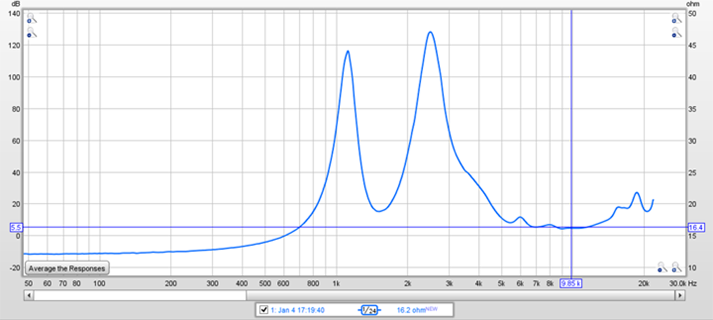

I was digging through my cable junk yard the other day to find some stuff for a different project, and ran across my impedance jig. I figured it's about time I ran some impedance sweeps of my waveguides. I'm a total noob when it comes to impedance and measuring it, so does this look viable? I've been looking at some stuff online and it seems reasonable. I think Earl mentioned a resonance at 6khz....which I guess is evident here with the little peak? Anything else amiss?

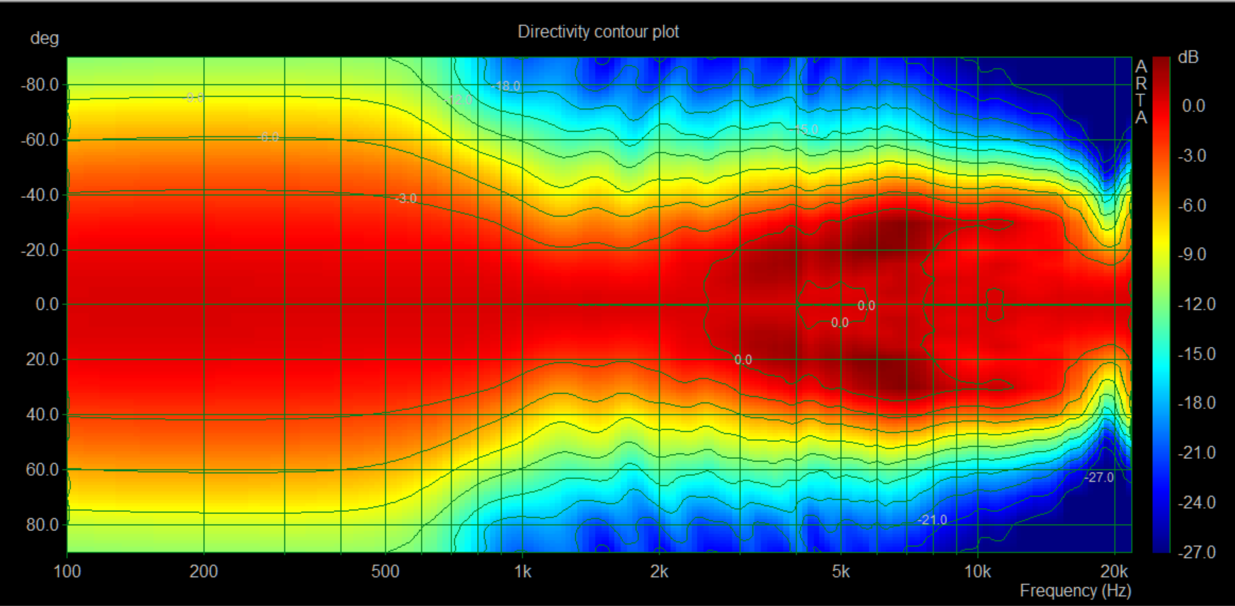

I forgot to add a legend for the FR plot...it goes 0-5-10-15-20-30-40-50-60-70-80-90-110-130-150-180. The contour plot is not normalized with 1/12 octave resolution. The FR plots are 1/24 octave.
Interesting construction! Can you provide a normalized and contoured polar plot (1/6 oct would be enough)?
FoLLgoTT - I will after work if I think of it, but I'll say right now that it isn't pretty! It's something like 40 degrees from 1-2khz then widening out to 90 IIRC. That notwithstanding I don't really see the use in displaying the data in a way that the speaker isn't actually being used.
With a cardioid you won't get much narrower dispersion. A cardioid has 180 degree dispersion (-6 dB at 90 degrees). Due to some directivity of the combination of driver and baffle you will get a little more directivity than that, but it's not much. Only when you get to the upper limit of the pass-band, will you get more directivity - solely because of the driver and baffle. Ideally you put the crossover where directivity of the cardioid box (which no longer behaves like a cardioid) and the horn match.
I'm always looking for comparability. Most companys use normalized sonograms. Usually with +/- 90°, a level range of about 30 dB and contoured in 3 dB steps. Without normalization it is hard to read.
I always favour a linearized 0° axis. Your approach to compensate the directivity on the 0° axis may work in your room, but not necessarily in others, because it heavily depends on the frequency dependant reverberation time. In a heavily damped room such compensation fails. On the other side the directivity loses influence...
Nils - what manufacturers show normalized contour plots? I've seen contour plots on the K&H website but I don't remember seeing that they were normalized or not.

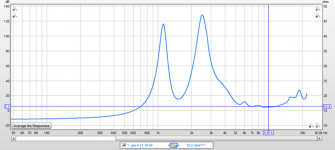

Anyone have any thoughts on my impedance plot I showed on post 46?

They look perfectly reasonable and typical - there is not much to say.
IMO with normalization is hard to read. One cannot tell the frequency response along any axis if the data is normalized. If not normalized then all axis are accurate.

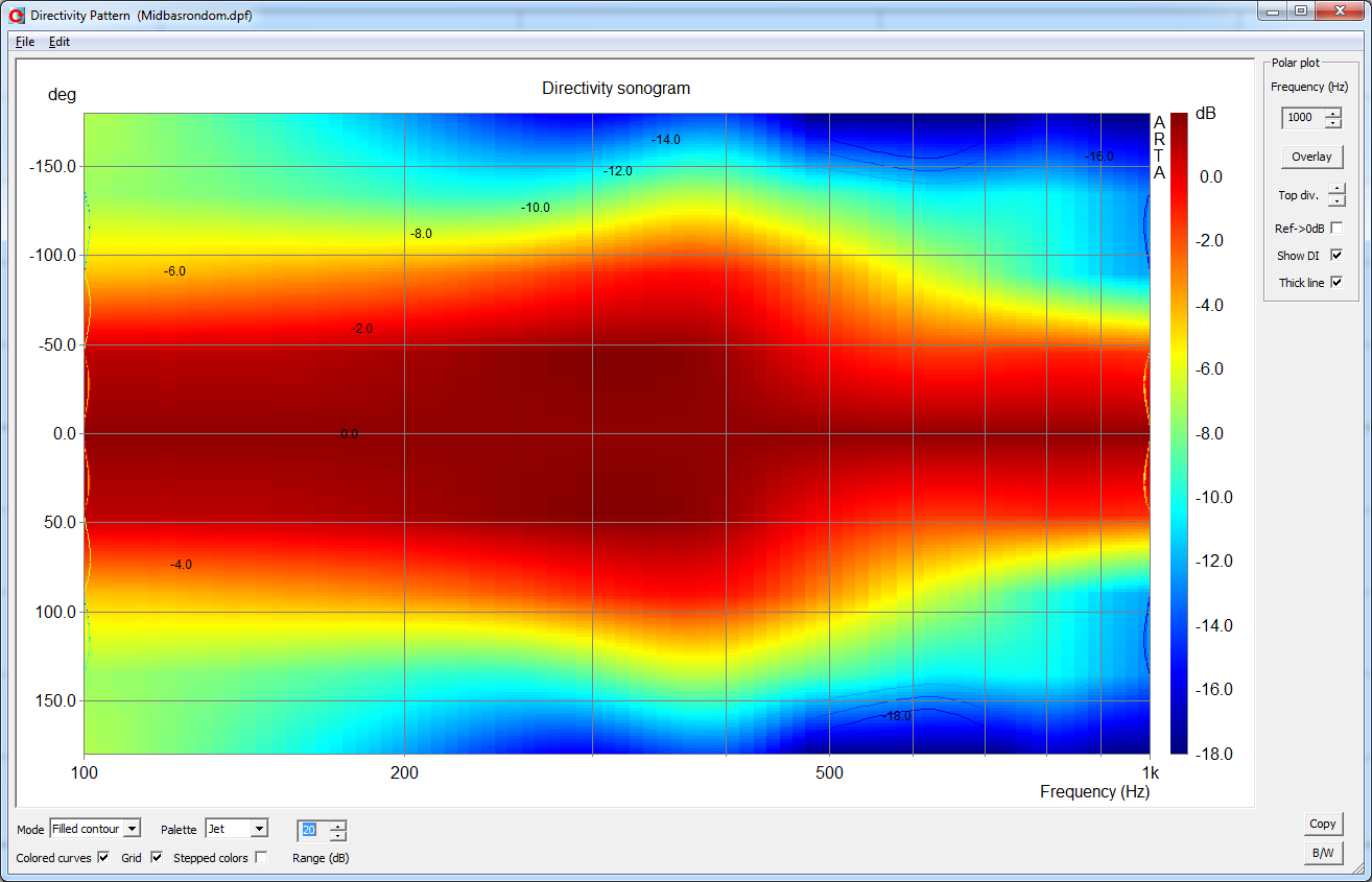

Thanks for the normalized plot!
You are right. There is no statement. Maybe Neumann (former K+H) doesn't normalize their plots. But in this case it doesn't make any difference, because their 0° axis are ultra linear. Both diagrams would look the same.

I disagree. If I want to compare only the directivity of two speakers the normalized version is much easier to read. And in fact it is much closer to reality, because 0° should always be linearized when listening under this angle. It is the most important parameter to our ear.
The only exception is listening under different angles (like natehansen66). But in this case equalization of this different angle is just a workaround for a non-constant directivity. I don't see this as a typical use case.
Beside that a non-normalized sonogram can be misleading. In a normalized plot dips which occur only at 0° lead to a widening in directivity. This is correct, because for the directivity there is no difference between a widening caused by a dip at 0° or one caused by a bad waveguide or baffle wall diffreaction etc. The effect is the same.
The non-normalized plot on the other side hides the widening caused by dips. In my eyes this is some kind of cheating.

A few minutes ago I got answer from Anselm Goertz who created many measurements and diagrams in the industry. He stated that all his plots are normalized to 0°.
Examples:
Neumann
Alcons
Bohlender-Graebener
Magazines like "Production Partner" and "Sound & Recording" (Test of a Genelec)
There is no standard for this kind of diagram though. Others who seem to normalize:
B&C
18Sound
Limmer
Seeburg
