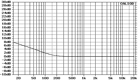

This is the response and pressure inside the box for a normal Peerless HDS164 in a BR box at 2.83 volts driving voltage. As you can see the pressure inside the box easily exceeds 140 dB at low frequencies.
So if your only goal is to acheive a high sound pressure for testing purposer, put the head inside the box (...or rather not😀 )
