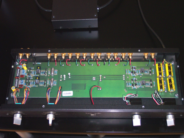

Has anyone here actually recapped a Forte Model 2?
I see the screws that seem to be required to detach the PCB from the chassis, but there are a ton of wires going from RCA jacks, etc to the PCB.
So even if I detach the PCB, how will I flip to over to get to the solder side without detaching all those wires.
Pic attached - not of my unit, but so you get the idea.

I'm thinking those wires were soldered from the top of the board which looks like double sided with vias in the holes connecting upper to bottom circuits.
Desolder just enough wires to flip it if needed...

Ugh, you mean no "silver bullet" that will allow me to do what I want to do with no work involved? 😀
I'll have to take a closer look next time I'm in there, but a removable bottom would have made things SO much easier.
Thanks for the reply!
Take off 4 knobs and 4 nuts. Pull controls and LED.
Flip.
Ah, I see! That seems to be the elegant approach. Thank you! I like it when people are smarter than me. Saves me a lot of time and effort. 😛
