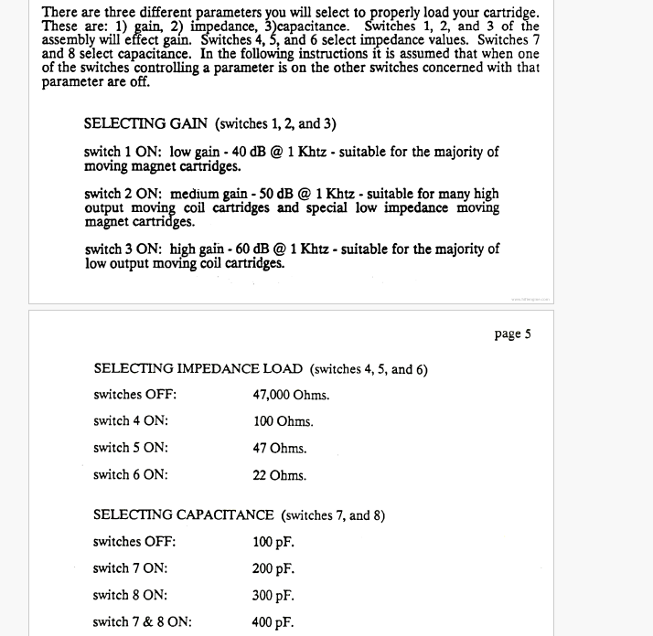

Forte model 2 settings. Is anyone familiar with this preamp?

Thanks for the responses. Ixnay, how did you arrive at what or how to build your own? I'm too old to learn this stuff but my son is very interested. I see people talking about building Nelson Pass kits? Or are they just plans to follow? I have reset the load impedance to 47k on the Forte. Will post after I give it another listen.
