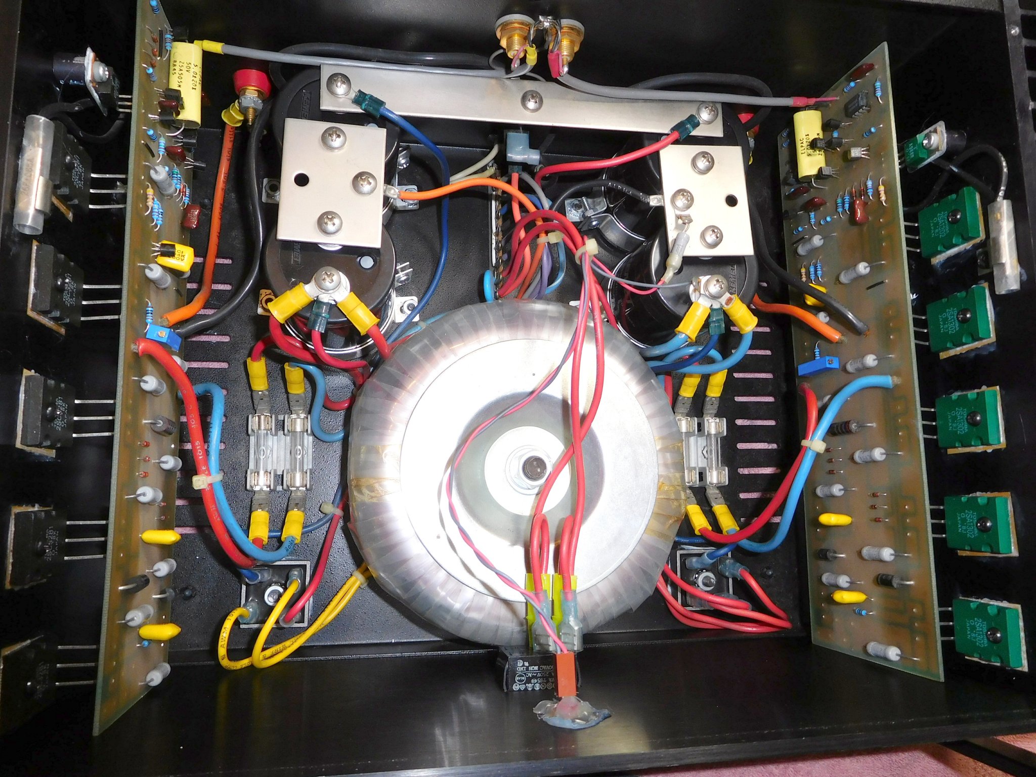

I found some photos here:
Forte Audio Model Three - 200/400wpc - Can be wired for 50wpc Class A Photo #2303408 - Canuck Audio Mart
It already has one of the best BJT's for audio. The (around 0.1uF) yellow film capacitors look good. The input sound-coupling capacitor also looks good.... you could try different flavours here (teflon, oil, copper, silver...), to suit the sound to your taste / the rest of your system.
Check the collector (emitter) grey resistors; make sure there's no discolouration. If you REALLY want to remove the PCB's (to replace the sound coupling input caps, for example), make sure the solder joints are sound - especially around these resistors.
Other than that, you could replace the input hook up wiring with solid core copper/silver wires - unshielded. That will also colour the sound... a fair bit... this will open the sound-stage (removal of the capacitance). Again, depending on your taste and the rest of the system - you may like the end result. You could experiment....
Make sure you have a fresh set of mica insulators and especially -> make sure there are no shorts between the transistor collectors and heatsink... once you mount the PCB's back in.
Check the DC wires are tightly screwed at capacitor terminals.
If you are really happy with the sound AND your knowledge is limited.... why risk it?

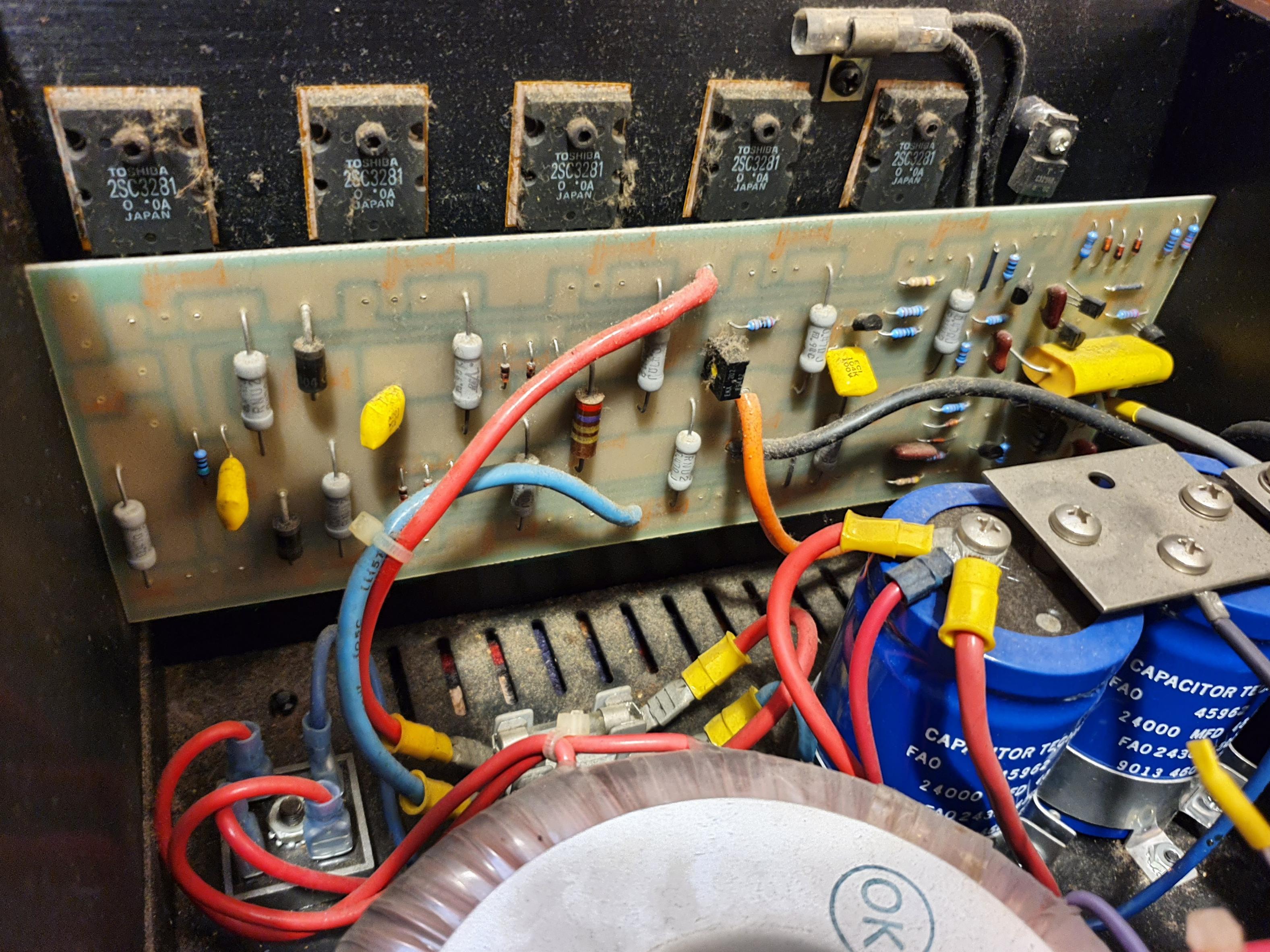

pics of inside, plenty , well lit
I uploaded some pictures, I hope they're good enough. I see @Extreme_Boky also found some pictures if that helps.

I mean, almost everything you mentioned I would have to search and study about, so I understand what you mean. If all is good (apparently), then I shouldn't worry about it. I just read everywhere that bias adjustment should be done hence why I thought about opening a thread asking for help about that specifically and anything else I should do.
In the mean time, I noticed a buzz on the speakers. It's quiet, but it's there. And the issue is on the Forté since I don't even need the preamp turned on for the speakers to buzz. Any idea what could be causing it? I know buzz is a PITA to solve mainly because it's hard to know where it comes from, but maybe there's an obvious answer?
There are some pictures attached, btw. Feel welcome to have a look.

I have the same amp, and have re-capped it and adjusted it. It does not hum or buzz when operating properly.
Based on your comments, you have little to no experience working on electronics, so my suggestion is that particularly high-amperage, high-ish voltage gear like power amps, you should first practice with low-power circuits. These devices contain transformers, circuits, and capacitors that can harm or kill you if you don't know the proper procedures. Making one critical mistake could be dangerous to you immediately, or later if something you worked on or missed fails and causes a short or fire.
The hum may be related to the PS reservoir caps or other electrolytic caps on the boards, or it may be another issue. Either way, you should have not only some experience, but proper tools to conduct the work. No one wants to see you light yourself up.

Yeah... maybe get someone to re-cap it for you. The amp seems to be in its original condition, so -> definitely replace the DC-rails filter capacitors; they have probably dried-out. I wouldn't think that the amp in its original form would buzz at all... you could also decide if you want to use a choke here... or at least a resistor (like DIYAudio store power supply... 4x0.47ohm / 3W => single resistor: 0.12ohm / 12W)
Another cap I'd replace is the input (sound-coupling/DC blocking) capacitor. Try AuriCap XO (very neutral), or silver-in-oil capacitors (if you want to colour the sound a bit towards warmish... but the bass definition may suffer)
Once again, maybe get someone from DIY audio forums who lives near-by to do the above for you...???

Looking at the pictures above, I don't see anything that sticks out. Check the large power supply caps with a tester for ESR and if what the capacitance of them is. Chances are they are probably still fine. Otherwise you can replace them with modern equivalents or even larger ones. The screw terminal caps of that size can be pricey so that is the only reason I suggest testing them.
If you want to do a little upgrade, add a snubber circuit to the transformer. The link leads to something called the Quasimodo. It is a tool to reduce transformer ringing which makes for a healthier transformer and a better-sounding amp. You populate a little board, hook it up to your transoformer, and use a oscilloscope to test while turning a trimmer pot to find the values you need for the snubber. You can buy little pcb boards that fit onto the bridge rectifiers that are in the amp.
Those single turn pots can be kind of hard to use. They can also get some crud in them. You can pull the pot, measure the resistance accross the two outer leads and replace it with a multiturn side adjust pot so you can adjust it from the top and not fumble around with a screw driver inside.
Check DC offset accross the binding posts of the amp with the RCA shorted. Should idealy be less than 50mv.
Check the bias procedure of the amp. In most cases with pass stuff, you set it to 45-50 degrees celcius on the top of the heatsinks. When it gets uncomfortable to touch.
Lastly, I have an amp from a similar era as yours. I converted it to class A. It sounds much better. Stronger too!
