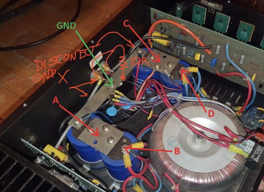

Just to remind everyone that the hum does go up in volume when the preamp is turned on for some reason, but it does not change volume when the volume on the preamp is turned up or down.even when turned up to a sound level that would be unsafe to listen to in my 12' x 25' room.
Again, thank you everyone!

OP : we can only consider "hum" of the amp alone, without preamp and with inputs shorted.
Otherwise it is a preamp or system problem.

Sure, and it does hum without a preamp connected to the inputs. I was just adding that the hum becomes a bit louder when the preamp is on. It doesn't change, it simply becomes louder. Just in case that helped.
I didn't try to short both inputs (I used the term grounded when I wanted to use shorted, sorry, English is not my main language). I shorted the left input, and connected the phone to the right and vice-versa. Results of that testing are also on post #62 I believe.
Shorting both inputs will not do any damage to the speakers correct? If not, I may test that later tonight.
Shorting both inputs will not do any damage to the speakers.We check power amp output hum with inputs shorted.
I was just adding that the hum becomes a bit louder when the preamp is on. It doesn't change, it simply becomes louder. ...
Does it mean preamp is connected or it is connected AND "on" ?
If this is a new addition to your investigation results it may hint to
a sub optimal ground wiring inside the power amp.
Thanks, I'll do the ABCD measurements with the inputs shorted.Shorting both inputs will not do any damage to the speakers.

Hi Dastinger,
Thank you for making the measurements and observations.
When you ground the left and have phone on right, “exactly the same” means that the hum is present on right and left is quiet?
If shorting the input makes the hum go away, that says that the PSU rail caps are not to blame. You can change them simply because, like others say, it’s been 20 yrs and they do age. But I can almost guarantee you that the hum won’t be fixed.
Because the hum is louder when inputs are not shorted and connected to a source, the problem is somewhere in the input stage or a ground loop associated with it.
It would be interesting to see what the mV AC DVM says is the speaker output when the input is shorted.
0.6mV and 0.8mV on my 82.4dB sensitive speakers is indeed audible hum. Audible with ears maybe 0.5m away even.
At 0.2mV rms, ears need to be within 10cm.
It depends on your tolerance to hum.
One more experiment to try is to disconnect the ground from RCA jacks on rear panel (the shield wire soldered to jack from gray cable). Connect the common ground tab on RCA to the PSU ground bus bar via a 10ohm ground loop breaker. I think this is a fairly safe experiment to try but make connections with amp off.
Like this:
Ground on the right, phone on the left -> Hum on the left the same, hum on the right barely noticeable
Ground on the left, phone on the right -> Exactly the same
MEASUREMENTS:
This was done with speakers connected.
Left:
AC - 0.6 mV
DC - 15.5 mV
Right:
AC - 0.8 mV
DC - 20 mV
Like this:

To answer your question about the phone + short inputs test: no. The hum would be more prominent on the left than on the right independently of whether the short or phone was on the left or right input. But it did lower it in volume a bit - on both channels. The hum on the right became barely noticeable (it's the channel where the hum is always less prominent anyway).
Now, w/ shorted inputs and speakers connected, hum is still there just the same. Measurements:
Left:
- AC - 0.2 mV
- DC - 16.7 mV
Right:
- AC - 0.2mV
- DC - 21mV
Regarding your last suggestion, I think I won't go through with it, at least for now. It navigates waters that I'm not too comfortable with just yet. I'll think about replacing the caps first and see how that helps.
