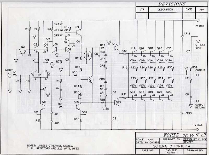

Hi all. I am the proud owner of one of Mr. Pass' fantastic designs, (albeit one of his lesser works). The Model 3 is a (Threshold) 200 wpc (8 ohms) Class A/B design with a fairly high Class A bias, and the case and internals are virtually identical to the Model 1A, a 50 wpc Pure Class A amp. My amp is a low-hours unit, and sounds fantastic. Because it is an older model though, I am considering upgrading the caps. I am also considering converting the amp to the Pure Class A 50 wpc configuration. I understand this is a fairly easy process, as the internals are the same. Any suggestions on capacitor upgrades or the Class A conversion? Mr. Pass?? Thanks. -David
Here's a schematic.

Thank you Mr. Pass! One other question: The stock power cord is a smallish two-prong unit. This may seem like a "no-brainer", but do you recommend upgrading to an audiophile-grade cord with ground? If so, would you think it better to add an IEC male socket to the rear panel (to enable "cord experimentation", or pass a fixed cord through the rear panel & enlarge the port & grommet? Thanks again! -David
Re: Forte Model 3 cap upgrade/conversion
The IEC socket would be preferred. You will have to deal with the
grounding if you use a cord with AC earth - the chassis must be
hard wired to the AC earth connection. A connection from the analog
ground to the chassis can then be made directly, or through a big
diode bridge and/or power thermistor which can provide some low
level isolation against ground loops but conduction against a primary
to secondary type fault.
