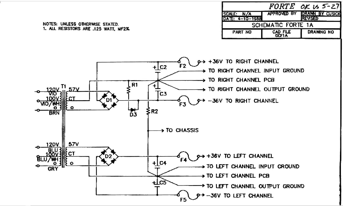

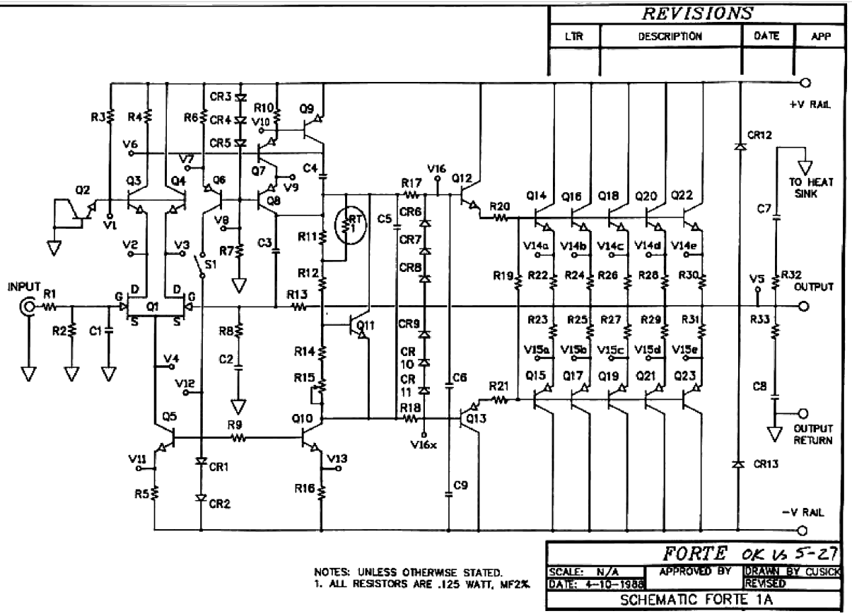

I have an excellent little Forte 1a amp that I keep around as a spare sense I replaced it with a Threshold SA 3.9e in the main system. BC I can get another one of these Forte amps pretty easy I got to thinking, could you convert this amp to a class A monoblocks?
I've seen some 200wpc class AB stuff get converted to 50wpc class A but I haven't seen a lot of class A stuff get converted to mono's.
I am no EE so the schematic I found for the amp looks like hieroglyphs to me so hopefully one of you smarter gents can look at it & give me your thoughts 😉
Thanks!
I think the front and the output section are all on one board. If you wanted to really go at it, I think you could pull R20 and R21 right before Q14 and Q15 and drive the outputs from that channel off of Q12 and Q13 off of the other channel. But I would wait for a more experienced person to chime in.
Also, you would have to do some rewiring, new bias, check voltages etc. power it up slowly with a variac etc.
I think it would just be simpler to Biamp. 50w is a nice wattage range if you don't have a really hard load. Enough to have some grunt but not so much that hte amp becomes more complicated or uses a lot of energy.
Or if you want to really get into it (it seems as though you like this Stasis stuff) you can build a Stasis amp from scratch using Nelson Pass's new front end. 🙂

Anyhow thank you Mikerodrig27 for your input. Sounds like the juice probably isn't worth the squeeze for this one. The biamp option was a very good looking idea however my Focals in all of their glory only have a single input. Too bad too as I wanted to make those beryllium tweeters sing even more!
