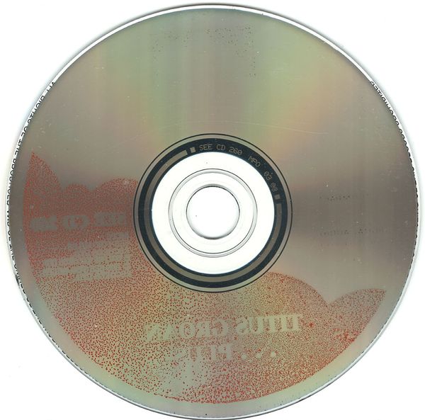

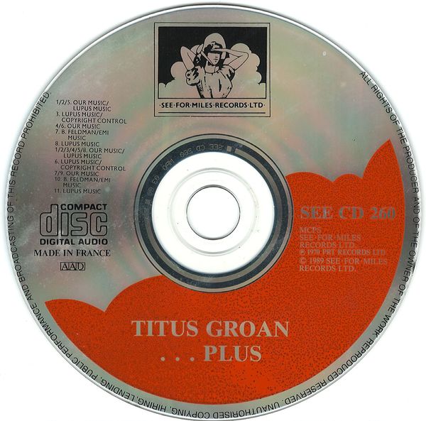

The CD could also have disc rot.
While not common for factory made audio CDs, I have a few examples that have visible evidence of rot damage.
Here are some pictures of a CD I have that has some easily visible disc rot.
