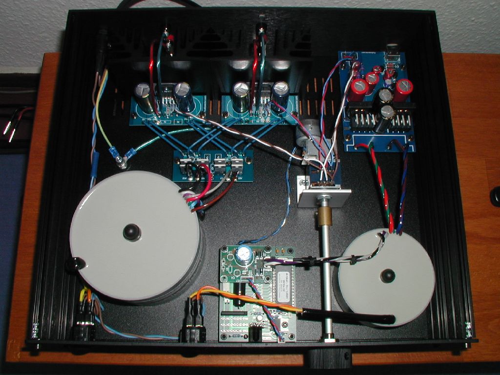

What I build in the past few years looks more like this:
1) Audio Sector LM3875 (with integrated USB DAC and remote volume control)

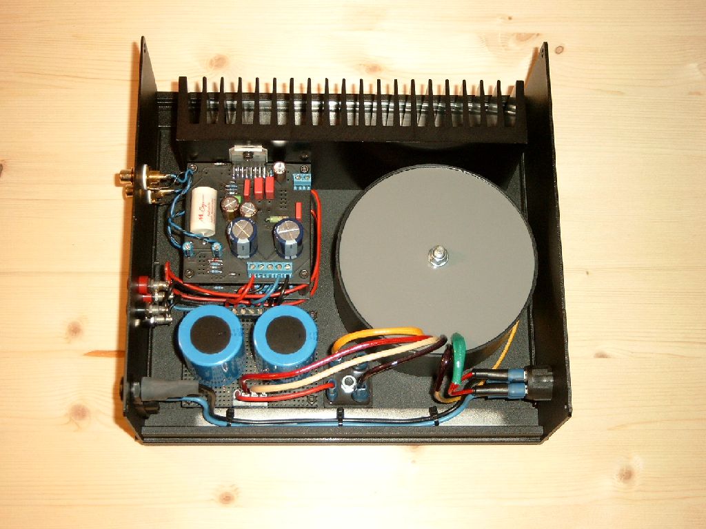

2) Elliott Sound Products P3A

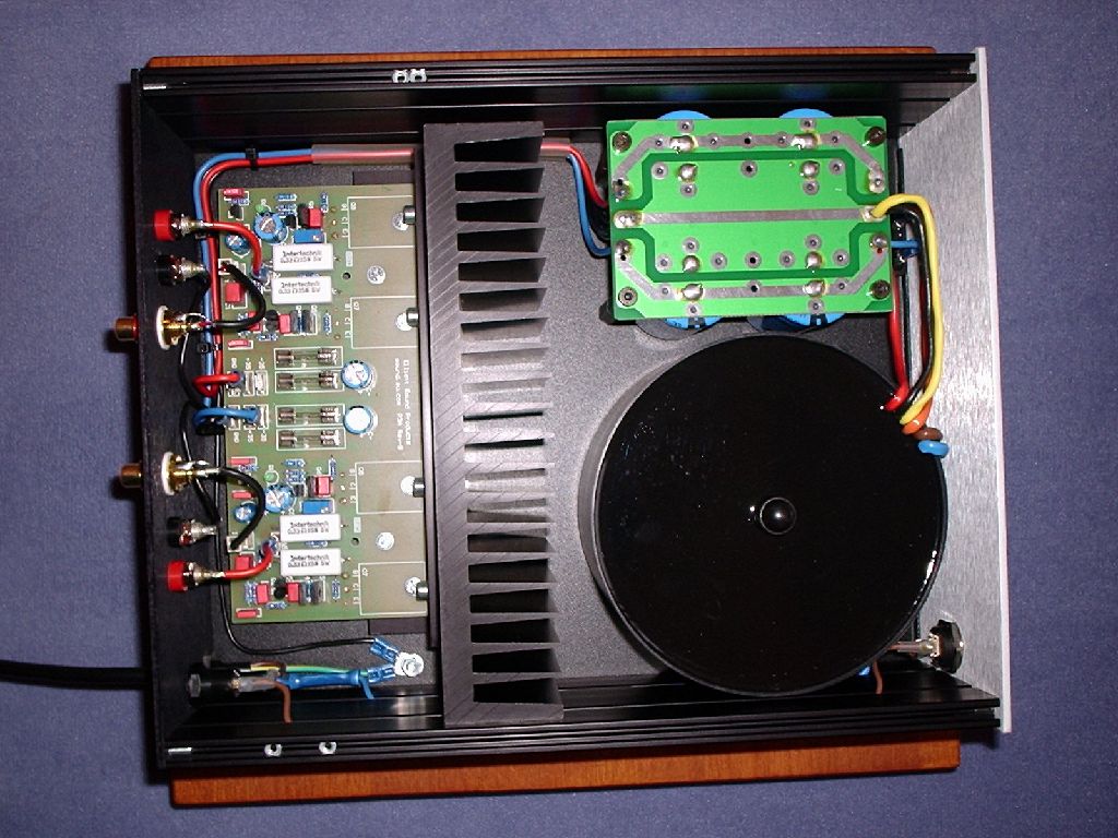

3) UB Audio HighAmp 100 (with TDA7293)

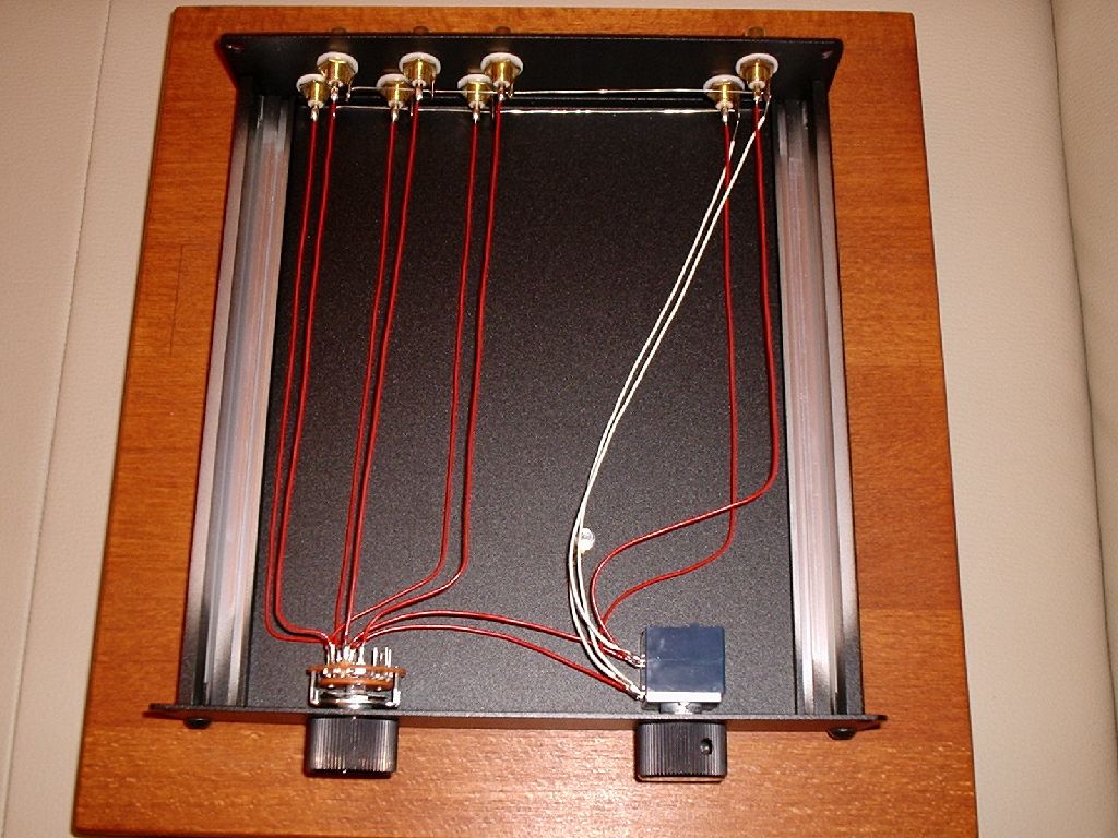

5) A simple Passive Pre (build for a friend of mine)
