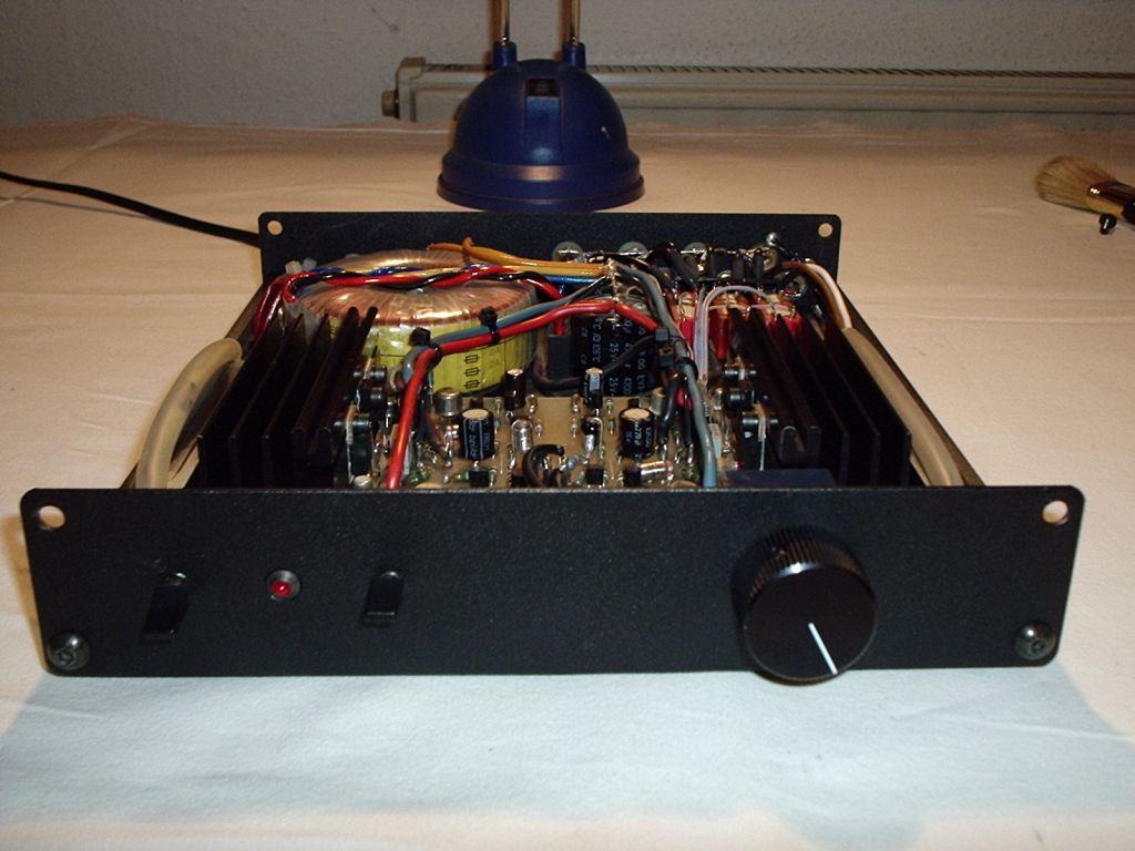

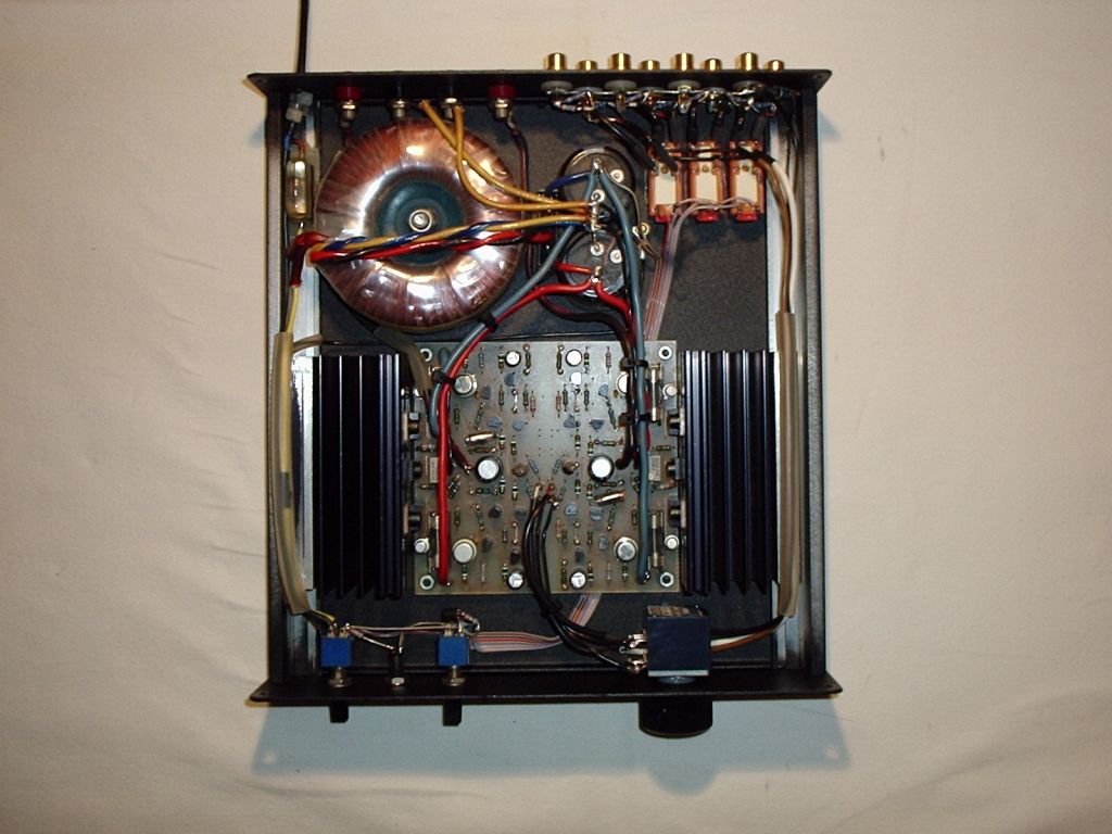

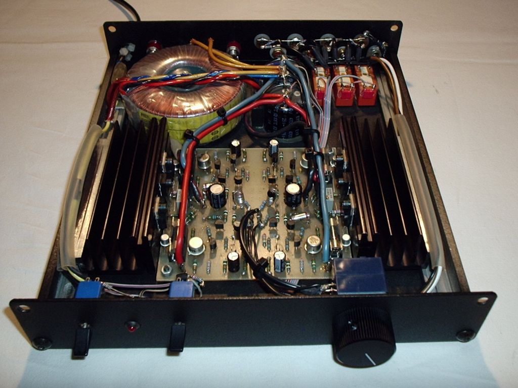

I have a small solid state power amp, handmade about 25 years ago (not by myself), and I don't know any of the specifications for this amp. However, it delivers a lovely sound and I'm thinking about upgrading the toroid transformer to a larger one. Currently there is a 50VA transformer with 2x15Vac secondaries, delivering (measured) +-21,5Vdc for both channels.
Is there a simple formula to calculate the maximum constant output power at 4 and 8 ohms, only by the given power supply voltage?
Thank you!

By the way, here are a few pics.

well, I always thought a 50VA transformer for a stereo amp might be a little bit on thin ice when it comes to short peaks in current delivery from the ps. The "2A" you read on the transformer is just the suggested secondary fuse. It is a Monacor International RKTM 5015, so it's definitely a 50VA type.
I heaven't calculated the output power by Andrews formula yet, but if you are even close with your estimation of around 24W sine wave per channel at 8 ohms, then a 50VA tranformer is DEFINITELY too small, given the average effeciency of around 60% for transistors!

Some time ago I had the opportunity to talk to the constructor and the reson why the transformer is that small is mainly because he wanted to put all the goods of this small stereo amp with integrated passive pre and source selection into this enclosure of just 44mm hight (37,5mm inside).
I was planning to rebuild the amp as a power amp without the volume pot and the source selection, because I want to build a remote controlled passive pre. This is why I thought about using a larger enclosure (same type, but 88mm hight) and use the empty space for a larger transformer of 120VA, just to add some more headroom for peak power. Smoothing capacitance is now 2x4700uF and could be increased to 2x10.000uF (I already have some of these lying around, brand new ones.)
