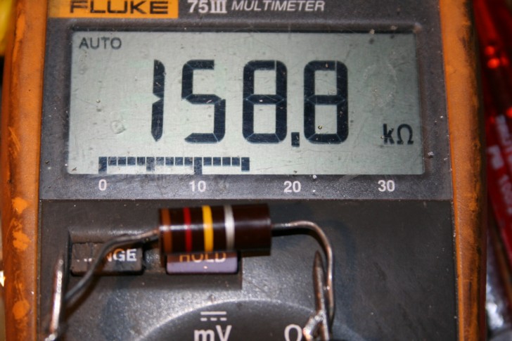

This weeks pick of the junk box is this 120K 2W 10% resistor. Looks innocently cleanand not scarred. Barely used, the meter illustrates the value (155.8K) drifted with time.
And to cap it, I regulary come across old tube stuff with pretty well the same drift. And of course still work. It annoys me when tubies insist on 1% tolerance......what rubbish.
richj.-

Well, of course they were! After all, they already culled out all the ones that were within +/-5.0% (ultraprecision in those days) the +/-10% ones, leaving the +/- 20%-ers to be "way off". I suppose every once in a while something a lot closer to nominal would slip through to be marked as a +/- 20% dealie, but probably none too often. Still seems very odd to see something like that, and even have something use such tolerances and still work. But then my original experience was with solid state, where +/- 1.0% laser trimmed metal films are routine. Solid state just is not nearly as "forgiving" as hollow state.
I do insist on using 1.0% resistors as LTP plate loads. With an active tail load, I get CMRRs that are too high to measure, due to the routine noisiness of my QTH. Everything just disappears into the noise. 5.0% metal film everywhere else, except for C-comps in RF sensitive areas: grid and plate stoppers.
