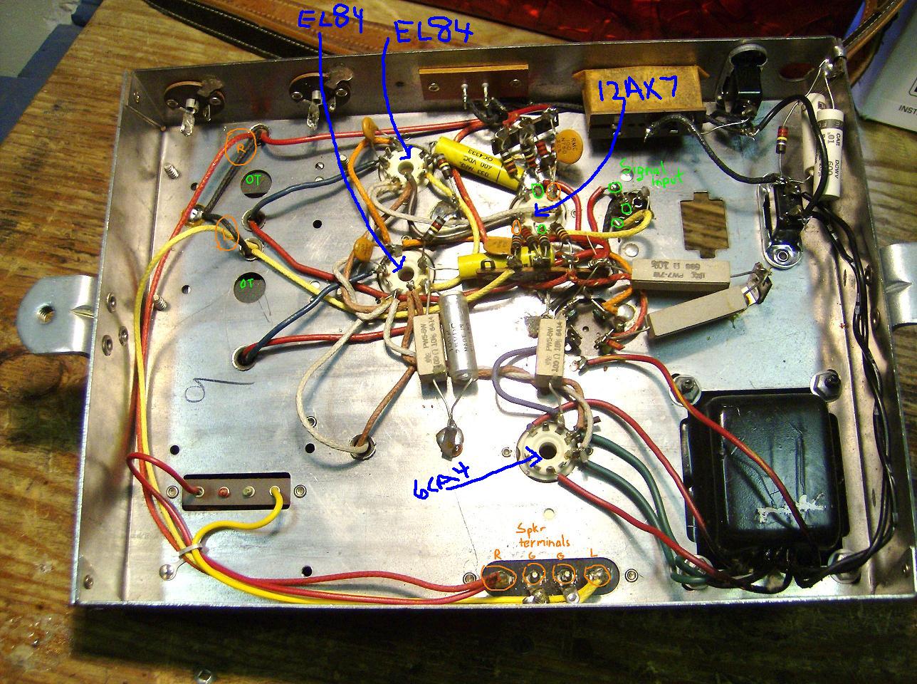

Another thing: use screened wiring for the input signal. I was looking closer at your image, the heater wire of the 12AX7 crosses the input wire to the grid. I can't see a grid stopper resistor on the grids of the 12AX7 either. Just connect a 1MOhm resisror from grid to ground as close as possible to the tube base.

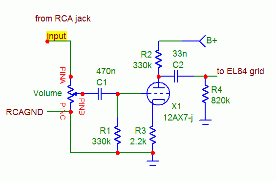

A little crude schematic for your volume control. I've added C1 to block any DC on the pot.

Its not too clear from your post whether you realise that the pot goes between the input RCA jacks and the grids of the 2 triodes in the 12AX7.
Here's a pic of the pin arrangement of an alps pot - yours will almost certainly match this:
So the easy bit first:
Connect right hot input to input1, left hot input to input 2 on the pot (this is the centre conductor of the RCA input jack)
Connect the wiper 1 (pot output) to pin 2 of the 12AX7
Connect the wiper 2 (pot output) to pin 7 of the 12AX7
Connect the 2 ground pins together and run a wire back to a circuit ground - ideally where the RCA ground connects to.
All should now work ok.
BTW, the part on your photo where you have labelled as the inputs looks a bit weird/hard to see in the photo. Is it some kind of a plate with 2 RCA jacks on it?

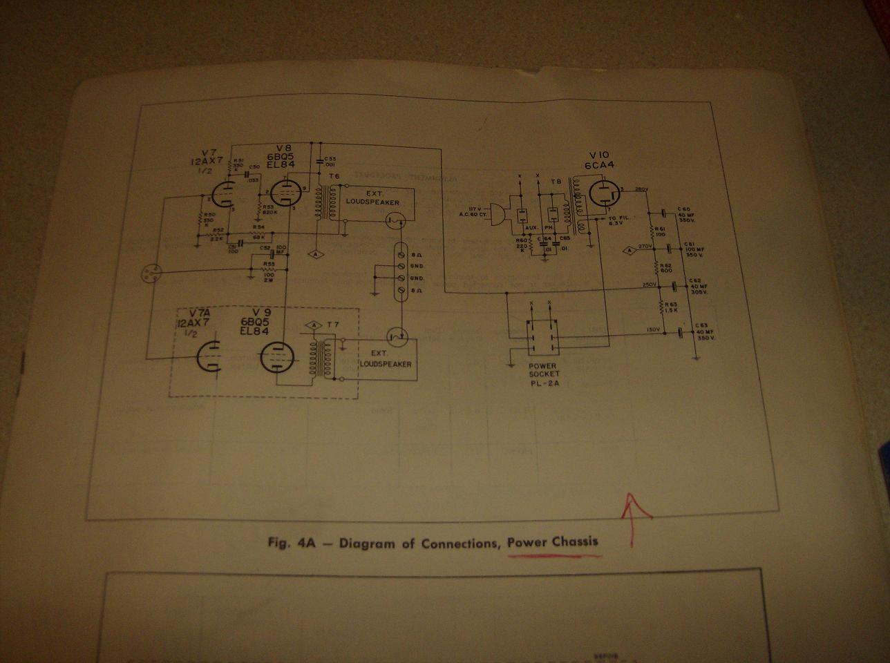

I have included schematic which I found. First one here is original.

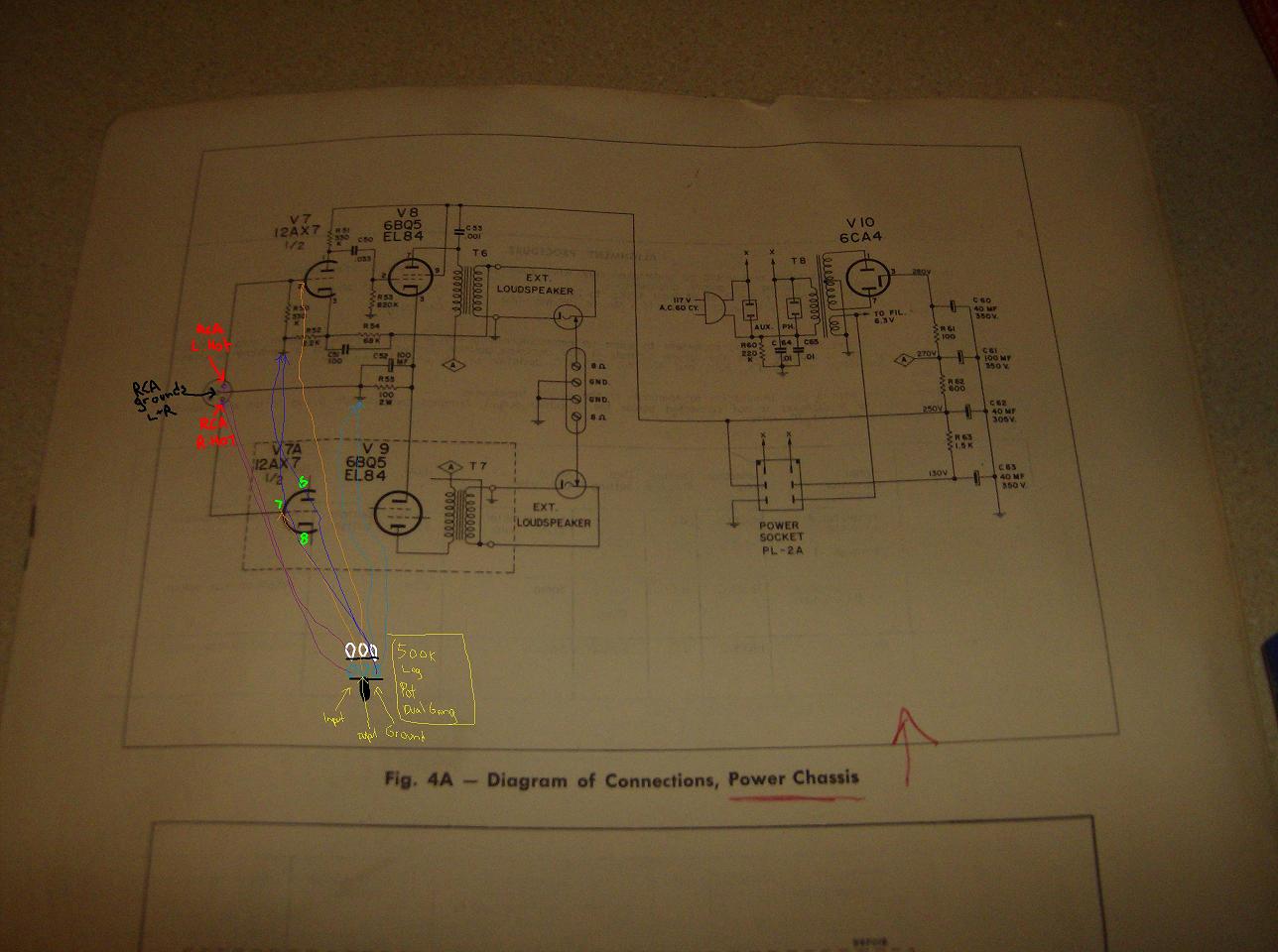

Second schematic has my scribbling on it showing how I wired in my pot.
Comments? Observations?
Are the symptoms a result of high DC content on my signal source as stefkorn suggested earlier?
Pardon my crude renderings and notations on the second schematic
on which I clearly reveal my lack of technical sophistication.
Looks like you have ground connected at 2 points. Get rid of the light blue connections. Also check that you don't have any kind of short to ground on the input rcas.
By any chance would you have connected that light blue line to the wrong side of the el84 cathode resistor/cap?

You might have multiple ground loops. The cure might be in rewiring the amp so that you have a star grounding scheme (and an IEC inlet)...
