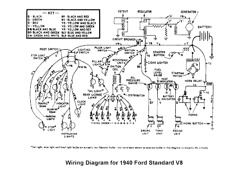

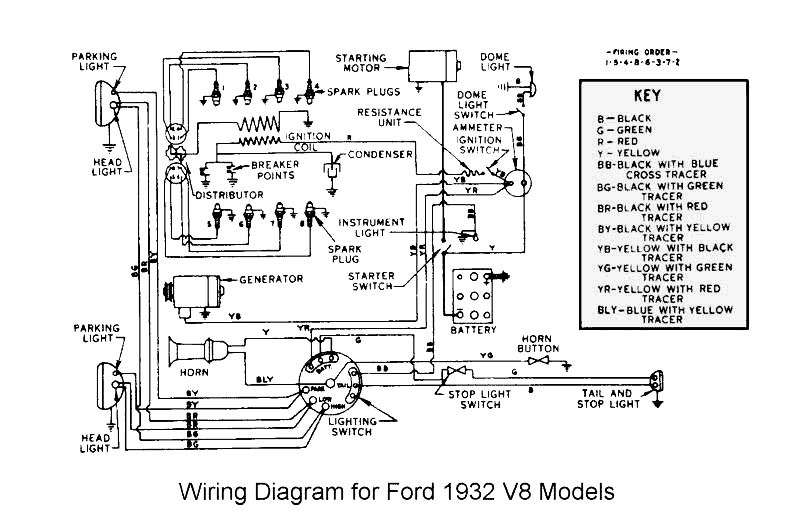

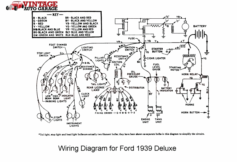

So I'm guessing the car has just been converted to 12v operation as detailed in these two articles:
6 Volt Car To 12 Volts
Converting from 6 to 12 volts
However your friends car conversion could be anything, you need to obviously specifically ask what's been done, then you can work around your radio connection without problems knowing what the precise setup is.

There are wiring diagrams online. Take them with a heap of salt. Ford didn't always do what they documented. 80 years of lazy and dumb mechanics. And the present owner has already done some mod.
