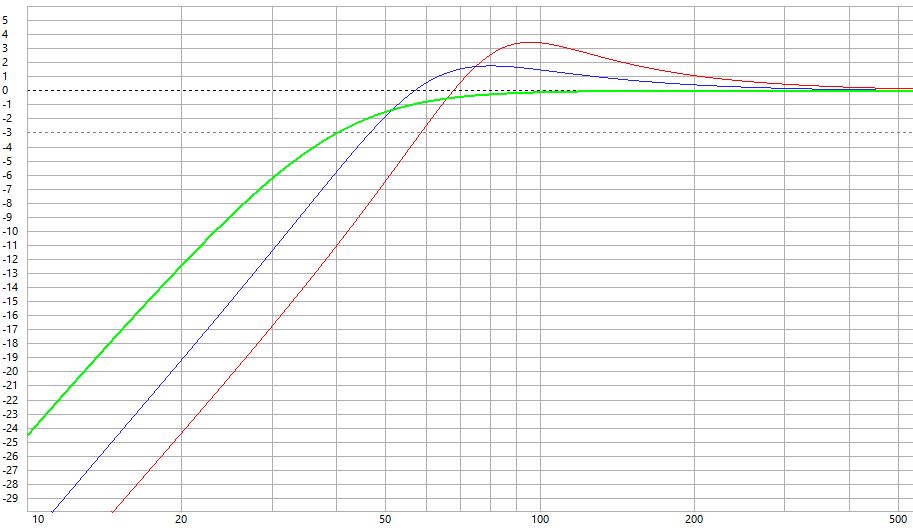

Force f3 lower in sealed box
I'm sure this has been discussed numerous times, but I did a search and only have so much time to sift through threads. Sorry about that.
What happens when you use digital EQ to push f3 lower in a sealed box? I have 4 of these in a ~1.83 ft.³ or 52 liter enclosure. PE site says one in 1.53 ft.³ / 43L has f3 49hz. I would like to get close to 40hz. If not practical it's fine, I can use subs. I'm in a concrete apartment and listen quietly without much bass anyway. But it would be nice to get these down near 40hz.
Also fs is 52hz, but I think I remember reading that going below fs in low freq. isn't a big issue.
Also if you wonder about the arrangement of 4 drivers in a smallish enclosure, I'm making sure some things are feasible and then will make a build thread. It will make sense...maybe

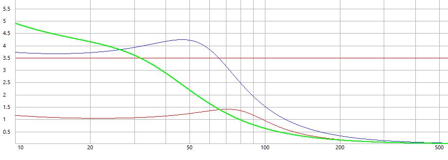

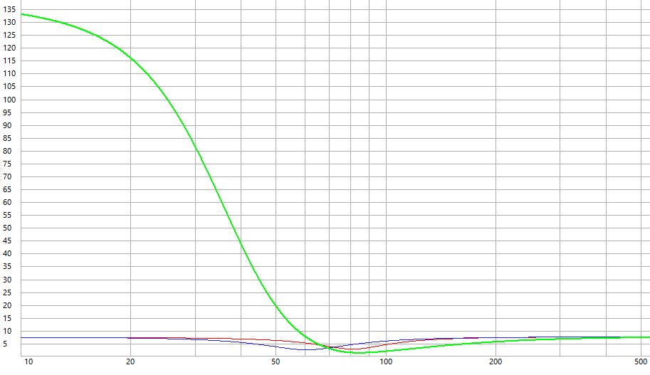

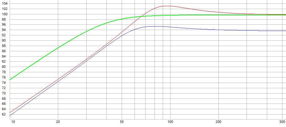

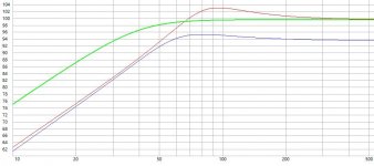

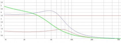

Putting 4 of those in 1.83 ft3 will change the response: you'll have a 3.5 dB peak (Qtc = 1.4) at about 95 Hz and a f3 of about 59 Hz. I modeled three configurations using WinISD: a single driver (blue trace), 4 drivers (red trace) and 4 drivers using a Linkwitz Transform to achieve a 40 Hz F3 (green trace). All configurations used a box size of 1.83 ft3 and were fed 8 watts. I chose 8 watts since it drives the 4 driver boxes to 100 dB. I included graphs for the transfer function, SPL, cone excursion and required amplifier power from WinISD.

Oh wow, thank you both! Especially for those graphs. Looks like the Linkwitz transform is exactly what I want. I'll read the paper on it and also re-familiarize myself with winISD. It's been about 10 years. I'm embarrassingly rusty.
