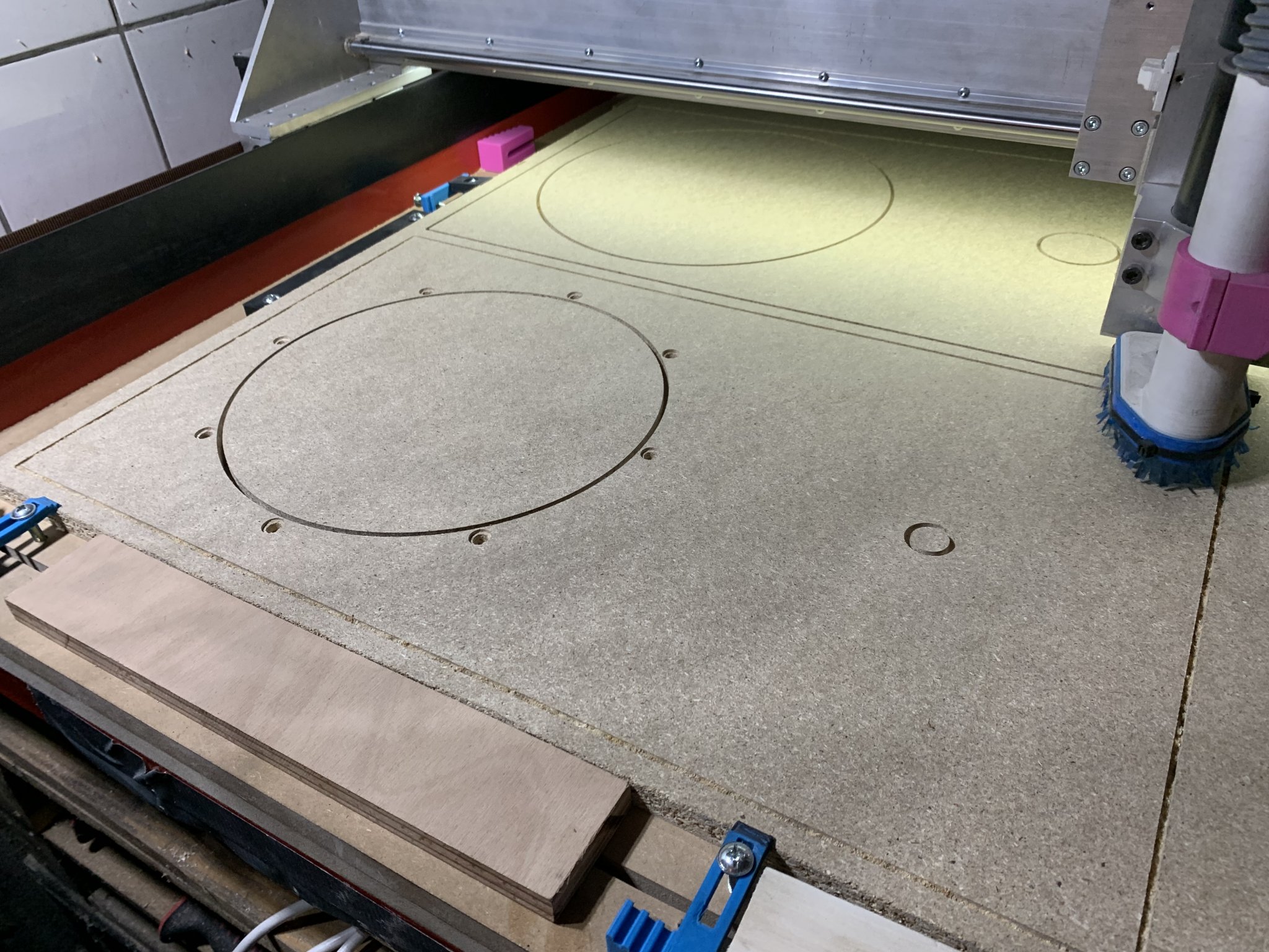

Not really, still need to learn more. For this project, I used OpenSCAD and EstlCAM.
The box went together surprisingly well. I put it together with a brad nail gun and predrilled holes for screws. I learned my lesson, screws for chipboard boxes are way overkill, I should have glued it up just with the nails. I also cut some extra braces by hand from the bad panels, it should be quite solid in the end.
It might be just a feeling, but I think the chipboard used to be stronger 20 years ago when I was building my first boxes.
On the other hand, this is just a cheap project, and it machines like butter. The only downside is the weight. The front and back baffle will be doubled up and all well braced. I forgot to take pictures before taking it apart, I will post some from the build up - not that it would be actually something too interesting, just a rectangular box.
What I really like is OpenSCAD - I can create parametric model for the panels, both 2D and 3D. As I am a programmer, it is easier for me than creating the model in FreeCAD (which can, by the way, import the OpenSCAD projects as well). I can lay out the panels in groups which fit the bed size and then easily create the gcode in EstlCAM from a single exported DXF file. With a bit of optimization, the workflow will be really fast and smooth for 2D projects.
